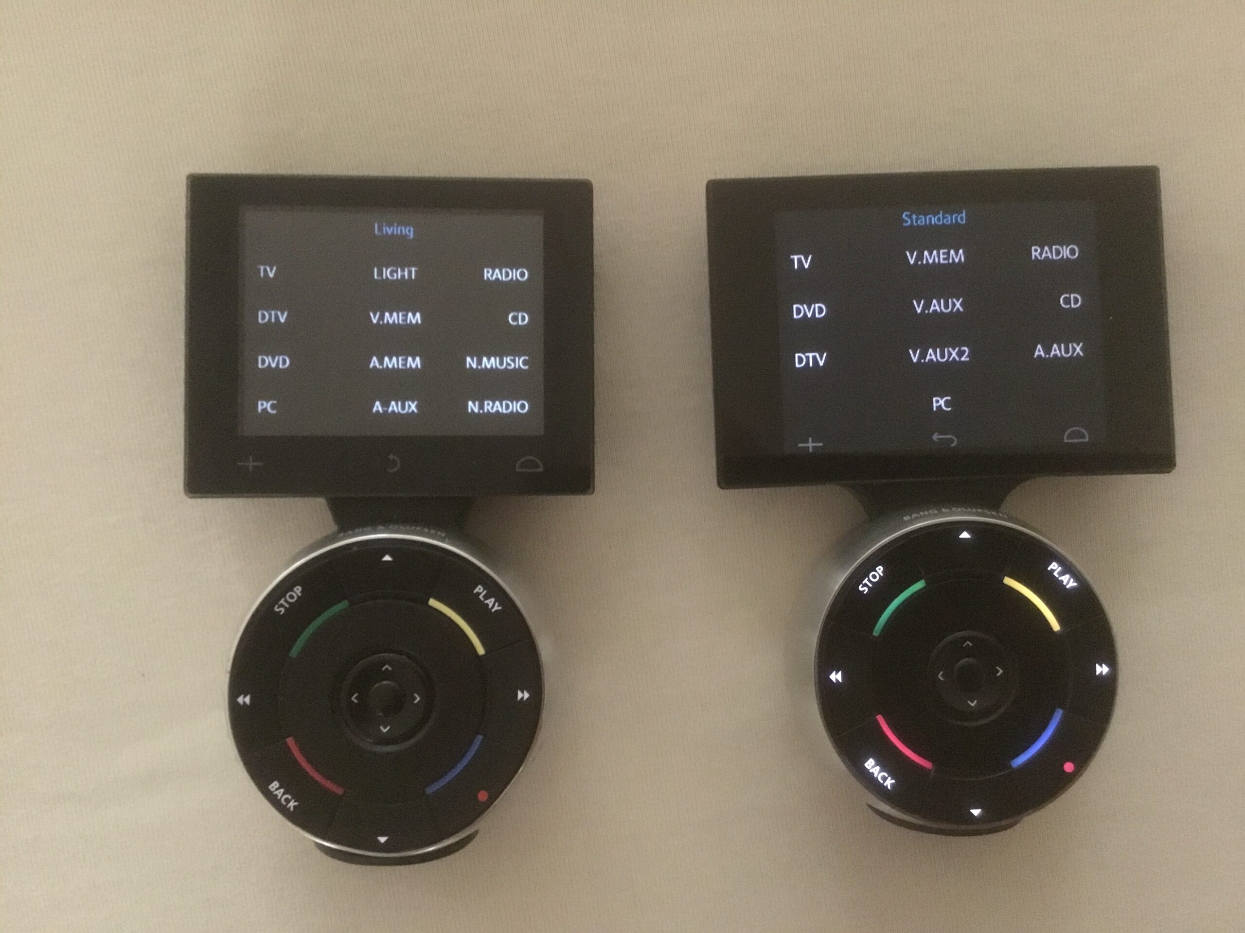

I have a beosound5 and beomaster5 and a beo5. The beo5 has the N.Music and N.Radio function. Now I bought a beo6 because it has a two-way function. The problem is the N.Music and N.Radio function is not on the screen. Can I install it myself, or do I have to go to a dealer? If I can do it myself, what kind of software should I use?
Attachments (1)
You are able to do this yourself if you download the Configuration Tool. Here is a link that will help. Config Tools It is a bit of a steep leaning curve and be aware that you cannot save the configuration that is currently on the remote. But once you get the hang of it, you can make the Beo5/6 a very useful tool. Research as much as you can before you start and make sure the remote is FULLY charged before trying to program it. The charger base does not charge fast enough when connected by USB to the computer so do not rely on that when programming. Connect to the wall charger in between each download to the remote. Stoobie
