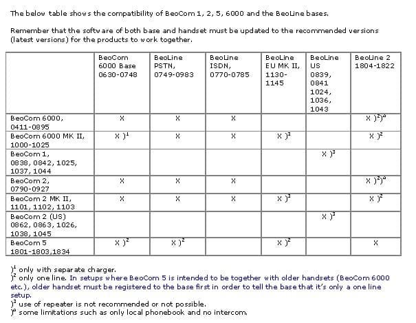

It sounds a bit strange, but according to the compatibility table below, if you want to use a BeoCom 5 with a Beoline Mk2, then you have to register an older handset first (eg BC6000) to tell the base that it's only a one-line setup. (and the same procedure should work with other bases as shown)

Useful, thanks. There is a Beocom 6000 Mk1 already linked to the Beoline Mk2, so that should meet that criteria. Above the table it does also specify that the software must be updated.  I have no idea what software either the BC5 or the BL Mk2 has. Asa I mentioned about, if I try DOT 70008 OK to get into the service menu for the BL Mk2, I only get 'Not Base 1' displayed, which I don't understand and the BC6000 is linked only to that one base. I reset the BC5 when I got it, so now the only thing it displays is 'Register to base?'.  The handset software is 2.43, but I don't know if that means it should be linkable to a BL Mk2!
