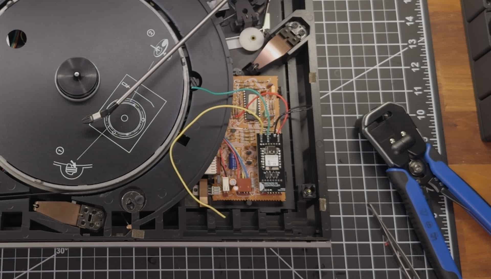

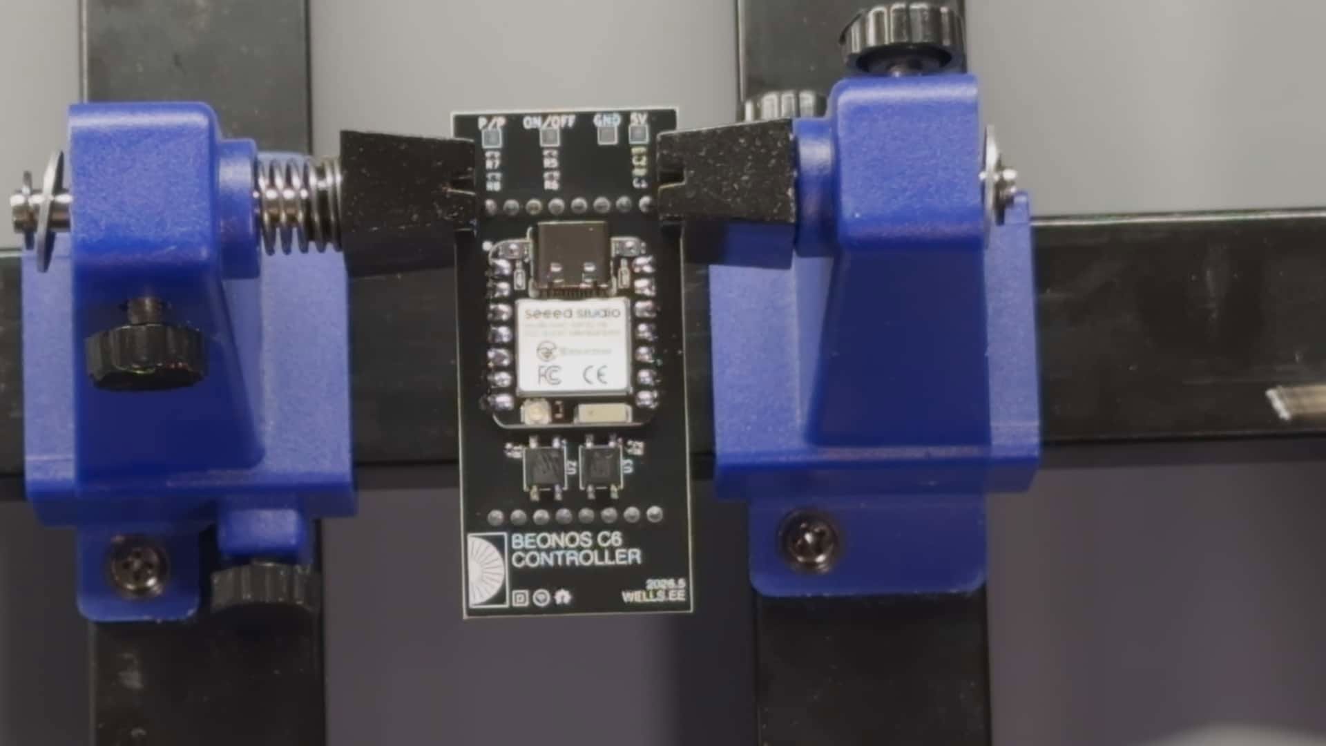

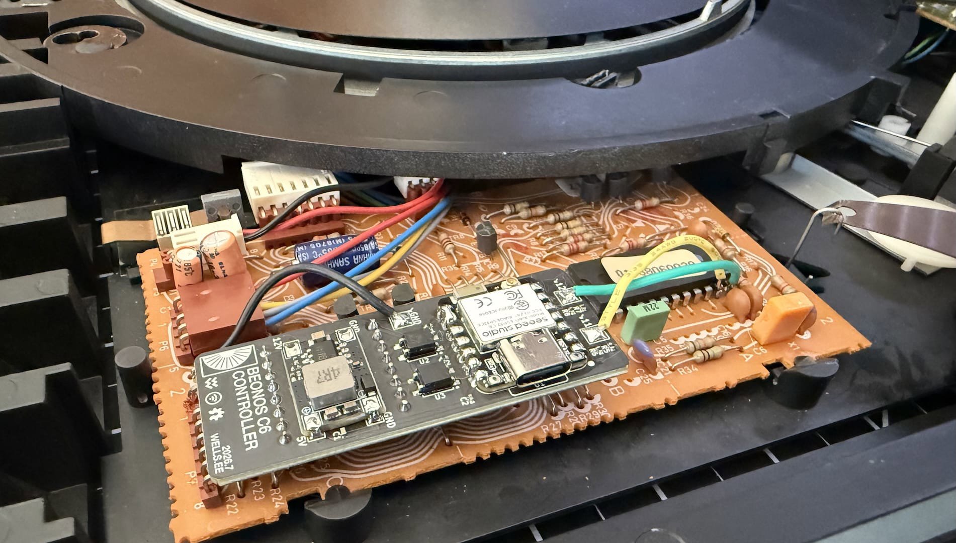

I set out to build a small add-in board that adds start/stop/pause control to the Beogram via a micro-sized wifi-connected board called an ESP32, as well as pass through the turntable's current state to make it 'smart'. I'm calling it "Beonos" (a lazy mashup of Beogram and Sonos... what, naming things is hard!)

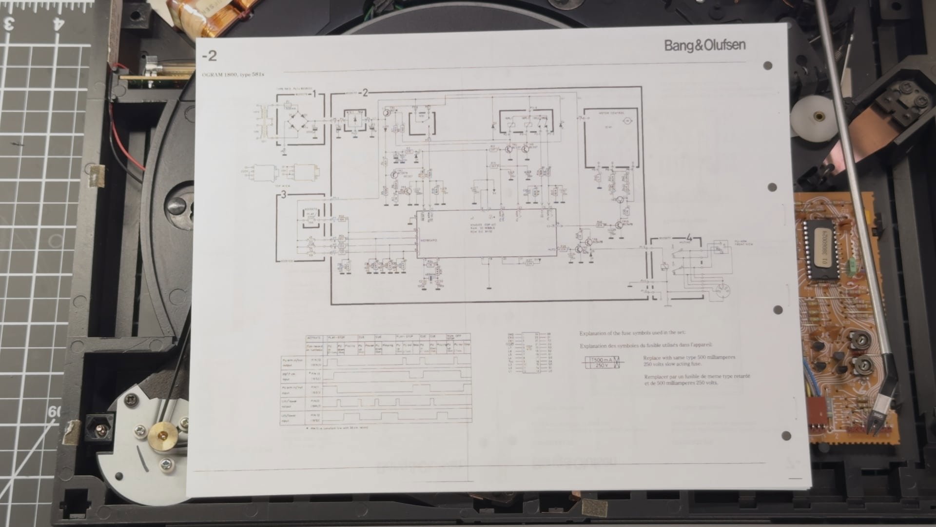

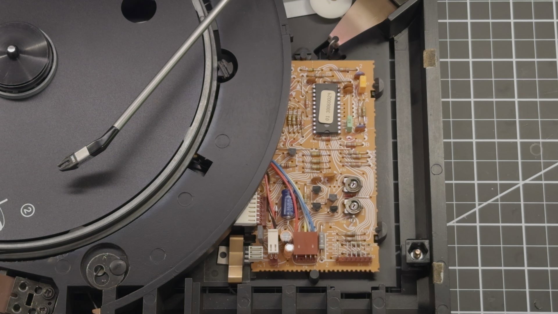

Where I've landed after a lot of reading schematics and a few dead ends... I'm tapping the control lines going into the deck's microprocessor so start/stop/lift are controlled the same way the front panel 'keyboard' would. The RX2's circuitry would be otherwise completely unmodified. It plugs in between the main circuit board and the keyboard attached to the top shell to 'press' the various buttons.
Anything on the RX2 (or similar era beograms) specifically I should leave well alone? I'm treating the tonearm servo and the cartridge as sacred and staying out of both... and from the schematics it seems like the control system is pretty much separate.
Has anyone here done anything similar with Datalink and regretted or preferred it? I looked at going that way but it seemed more complicated than it was worth, but I'm not sure I was right.
Happy to share more board photos once I've got it a little tidier. Mostly I just wanted to share my little project and see if there's anything obivous I'm missing.
