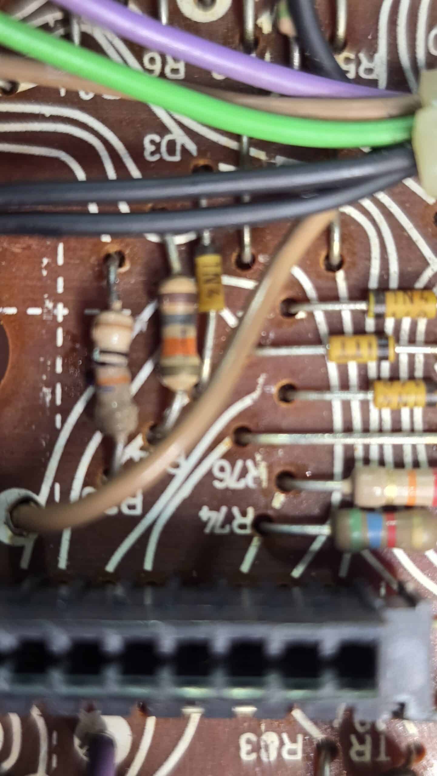

Hi Upon recaping BG8000 PCB I spoted a broken resistor at R25, it is snap in half. I presume its better to replace it but I wonder what function does it have. As a side note the lamp at the tracking sensor is dead and the arm does nt move more than a few cm in the plater without returning to the starting point... is there any connection with this broken resistor ? Any information its very welcome Kind regards Vasco

The resistor works in the circuit providing a slower forward towards the lead-in groove. Martin
Thank you Dillen   Vasco
