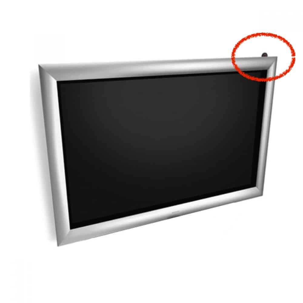

But be aware that your BS3 needs to be able to respond to your remote control, by means of an IR receiver. I am not so familiar with BV4 screens but believe some have a an IR sensor on top, some not.
If your current screen has one, like this:

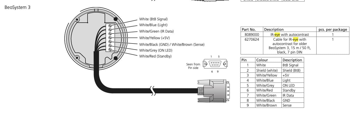

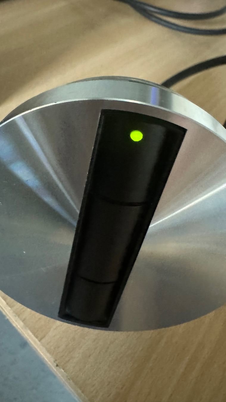

you will need a separate IR eye, like this:
Is there not a possibility to source a modern 55 inch screen from a B&O dealer, who can help you get you up and running?
