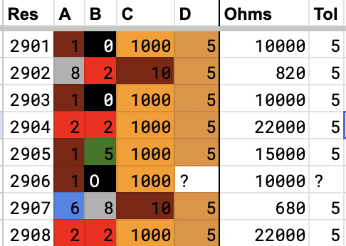

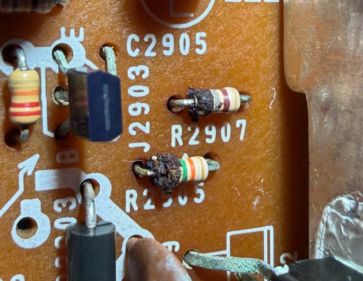

Could anyone (perhaps @Die_Bogener) confirm the resistors on PCB62 from a VX5000? Several of mine have corroded so that the first band is not visible:
If I'm reading the Service Manual correctly, I have deduced:
This is a North American VX5000, but it appears PCB62 is just responsible for 12v/5v so I suspect it's the same as the Euro version...
Thanks!
