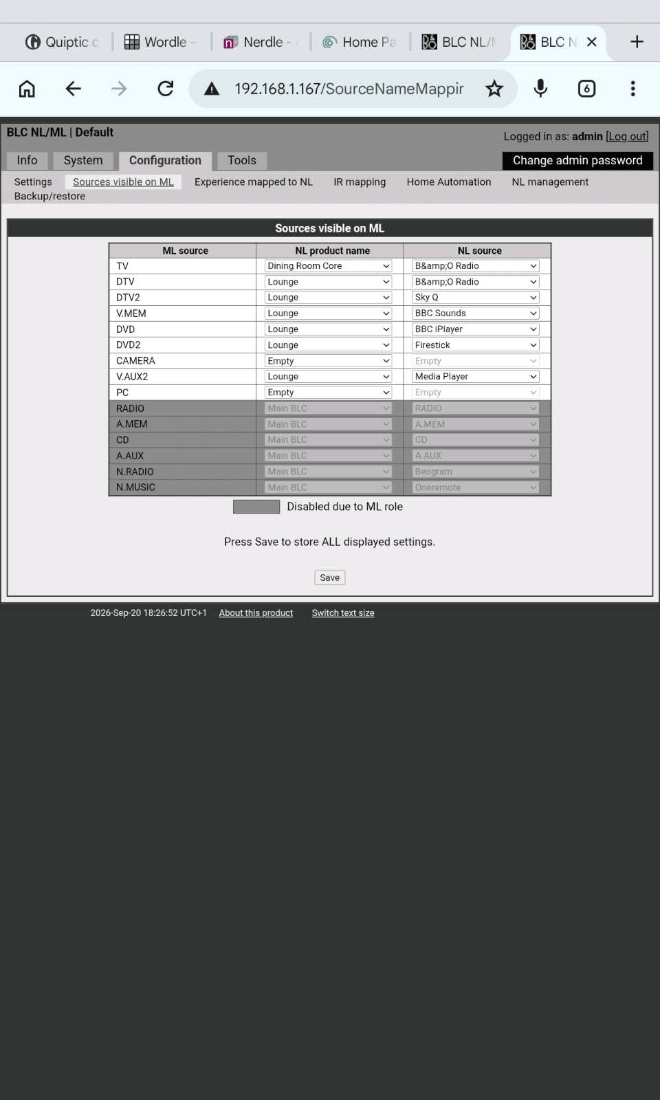

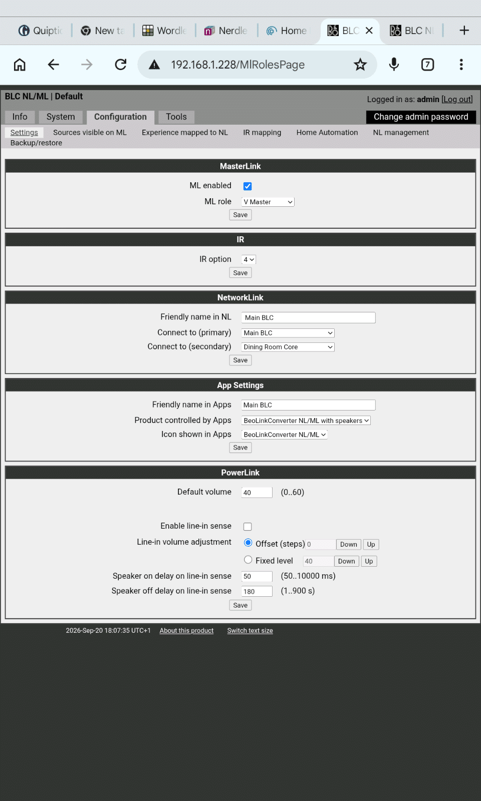

For my main ML system I have this NL/ML Converter set up

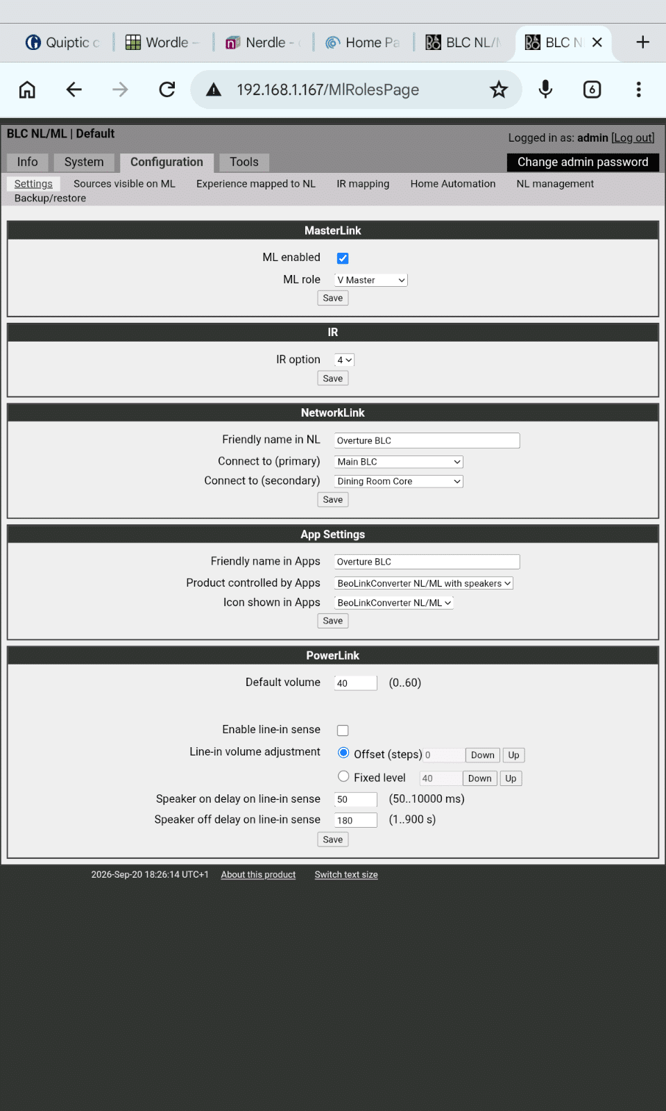

My additional ML system with its own NL/ML Converter, connected to a Beosound Overture, has this setup.
This leads to the following sources visible on the ML network.
This allows me to play the NL sources on the Overture but I have to prefix the command with AV. I cannot play any of the BM7000 sources.
Is this correct or do I need to change the option settings on the Overture?
