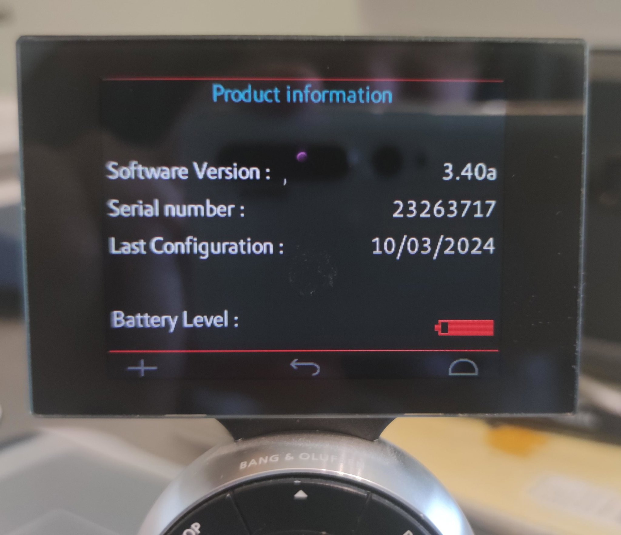

I don’t know the answers to your question but I’ll say this: • I have just gotten a Beo6 • I have just installed CT 6.84 >>>>on Windows 8.1 (64 -bit) >>>>running under VMWare Fusion 13.5.1 >>>>on an Intel Mac running MacOS 12.7.3 • CT sees the Beo6 connected via USB • The Beo6 serial is 23378749 on the CT • The Beo6 is HW revision 14 • The Beo6 firmware is 3.40, with >>>>BeoLo 1.01w, Wifi 4.34, animation 0.01b I would appreciate it if any readers could advise as to whether these are the «latest» or perhaps «best» versions of all of the above, or if I need to look for additional software. Thanks!
Well, the the Beo6 is working.  I don’t have very many songs on the BM, only about 550 so far. Boy, I hope I have done something wrong with my system… the BS5 “now playing” visualizations on the remote are beyond ridiculously slow! If I fwd one song, the audio change is instantaneous because of the IR function.  But it takes the Beo6 about 10 to 60 seconds to update the full screen data (while keeping the previous cover art) and then an additional 3 to 5 seconds to update the cover art. I am amused by my little toy, but did people play €550 + configuration fees back in the day?  This was from 14 years ago, not 24 years ago! ;-)
Your Beo6 has the latest firmware/software and the configuration tool is the latest too. Great that you have it working. Sorry but I can't help with the slow connection. It is VERY important to make sure the Beo6 is fully charged between downloads. The charger is too slow to charge properly so connect back to the mains charger after each download and don't leave it connected to the USB on the computer for any length of time. If the Beo6 battery dies during a download, it can be very difficult to get it working again. Stoobie

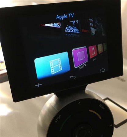

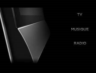

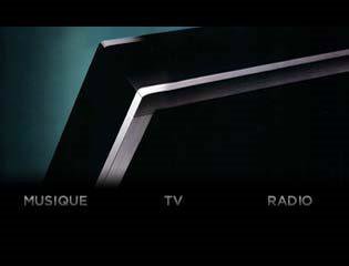

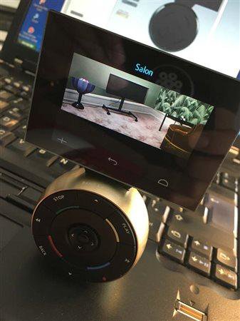

Not really an issue to me, certainly because I don't have à Beosound 5 and don't use it as a keyboard. No to me the big problem is the battery. I have 3 or 4 of them, all with power supply problems. Unable to keep one alive more than few seconds. I have tried everything, fresh batteries, swapping Thermal protection, cells, overnight charging, external battery power, … Nothing work, the remote is always short on power when it only powers on… So sad, I really mis my Beo6 with their colorful display…Beocenter%20Home%20copy.jpg-600x450IMG_5244.JPG-600x450Beocenter%20Home%20V2%20copy.jpg-600x450IMG_5214.JPG-600x450
Location: Paris France
Matador, you inspired me to design new buttons and screens when you posted pictures of your screens in one of the old forums. I love my Beo5s and Beo6s. It is a pity you cannot get yours to work properly. Stoobie
Exeter, Devon, UK
Matador, Do note that Tignum reports —just today!— that he’s had bad Beo5/Beo6 batteries which presumably were new. https://forum.beoworld.org/forums/topic/beo5-6-adaptor-part/ Your problem does sound strange.  As I myself have experienced new batteries which refused to work out of the box, perhaps you might consider trying again.
