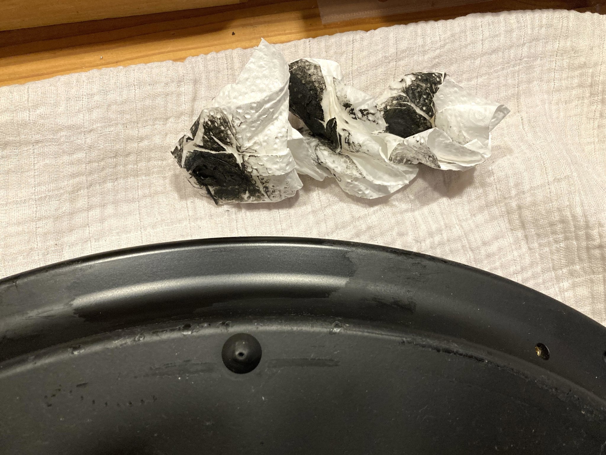

I am using Isapropyl alcohol and toilet paper. Had to rub the spot three times to get this result which I think is far better looking than the dusty, scratchy and sticky surface. It takes some time and rubbing, but I think it is worth it. You might wan’t to start on the back to see if you like the surface underneath. If you know how to take of the wings it might be worth doing that to eliminate black spots on them when doing the edges.
Thank you for explaining and giving advice. I found a Youtube video, recommending Isopropyl as well for cleaning BL 3´s with sticky gray lacquer. Good to have your confirmation that this is the way to work on it. Guess it will be all the same for cleaning products with sticky soft touch coating, e. g. BC 2 table charger / dummy, BeoMedia 1, etc.
