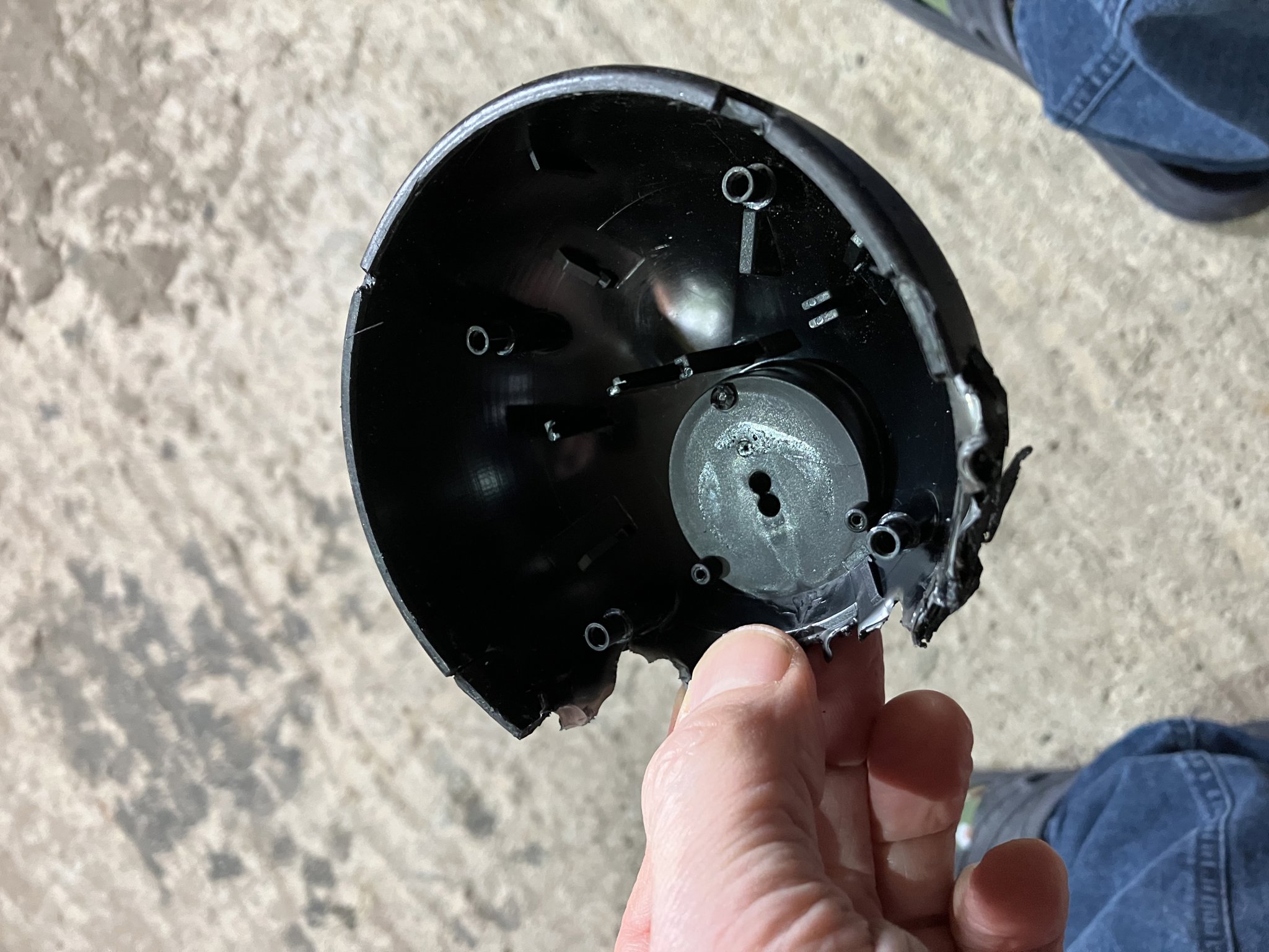

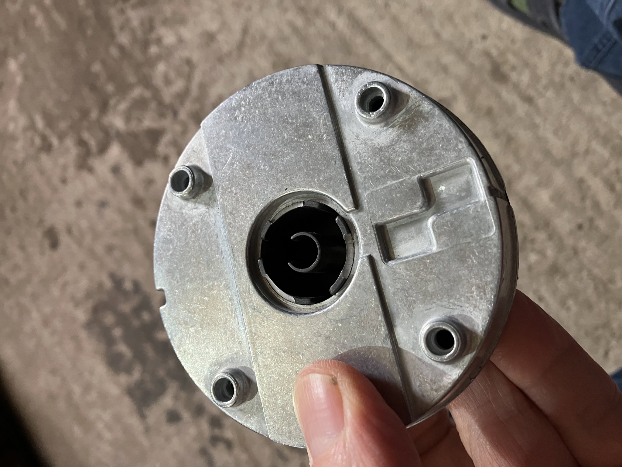

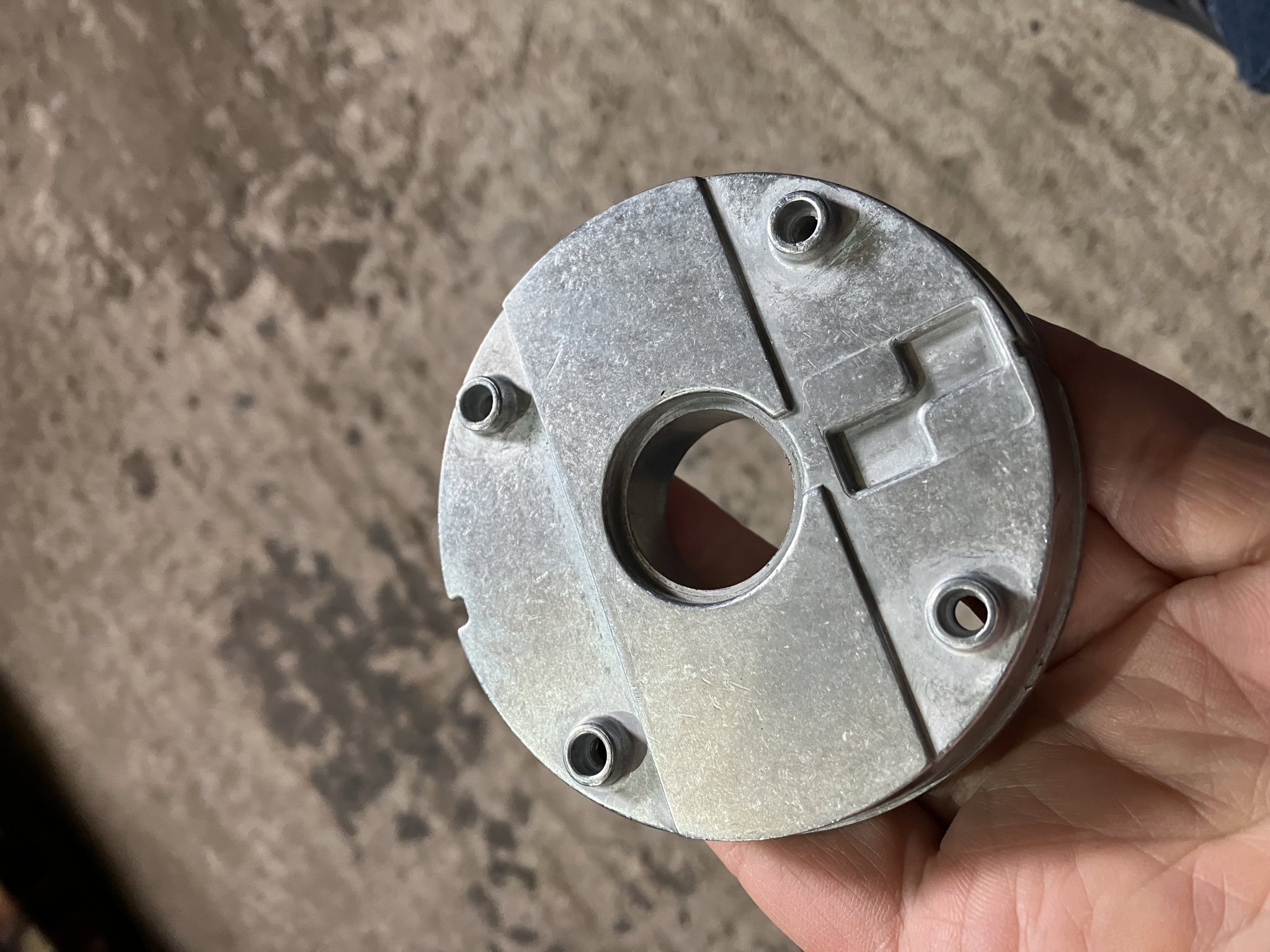

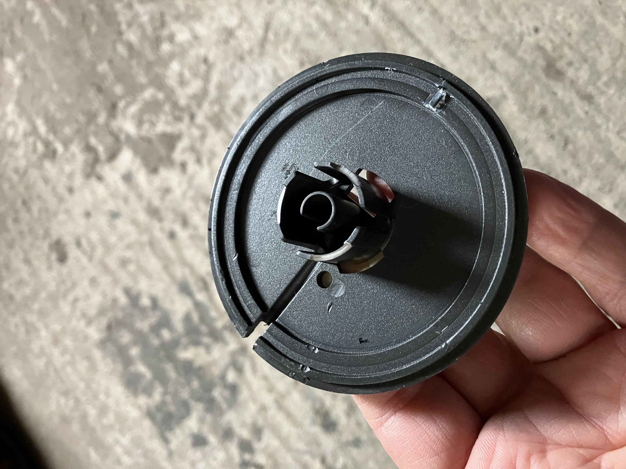

Luckily, when I destroyed mine I took some photos:
From the bottom, I think if you slide something very thin up between the plastic tab and the metal weight, you may be able to unclip the three plastic base tabs inwards so that they release out of the weight, thus exposing the screws that enable you to proceed further.

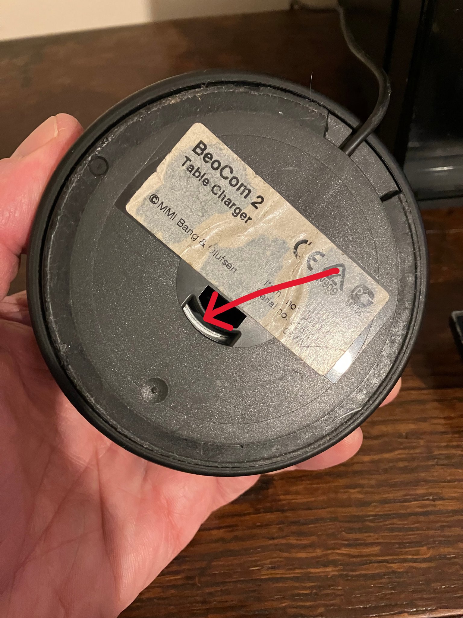

Here's my intact one to help explain.
I think inserting something very thin into each of the three gaps (arrowed) between plastic clips and metal weight should release the base.  Maybe cut up a bank card?
