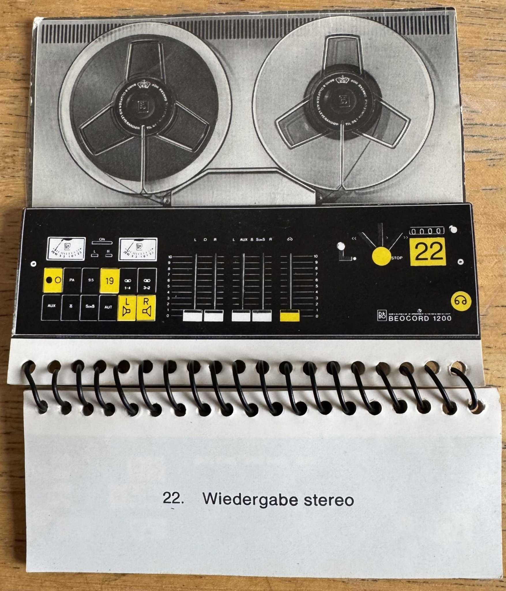

Hi all, I have been able to acquire a beautiful Beocord 1200 (Series 7). After a mechanical check, I replaced all the belts and made the switch from 9.5 to 19 functional again. The device is now in really nice condition, both visually and mechanically. When I play tapes that have already been recorded (recorded on another device or on the device when it was still working properly), both VU meters work during playback and both channels play correctly. Now I have recorded a tape with music from a device at the AUX input. To do this, I selected the speed, selected AUX, pressed buttons 1-4 and 3-2 simultaneously and pressed the L and R buttons. When recording, I use the sliders and both VU meters are triggered correctly (see picture 1). However, when I play back the recording, only the left VU meter is triggered and when I press the L and R buttons I only hear something on the left channel. If I don't press these two buttons (L and R), something comes out of both channels via the speakers - but I don't know if this is stereo. And here are my two questions: 1) Did I press the correct buttons for a recording? Is it correct the way I did it? 2) If so, what could be the reason for the right channel not playing properly? And what can I do about it? I am not a professional electrician and am not yet familiar with this kind of tape recorders, but I would like to use this one again as it is a wonderful device. If I understand correctly, does the machine have two sound heads? Which one has which function? Can they be tested? Or can I clean them? Many thanks in advance for your help!

Hi Yann, hi all, I couldn't get over the fact that the right channel sounded very muffled during playback. So I unscrewed the black cover of the mixer and cleaned the sound heads again with a little more pressure, patience and alcohol than before. It is definitely easier to get to the heads without the cover. I also cleaned the "silver guides" on the left and right and the rotating pin to the right of the sound head properly. In daylight I could see that a lot of dirt (abrasion?) had settled there. Then the test aaaand - it helped. Now I have a clear sound on both the left and right channel and a decent stereo sound when I press both buttons (L+R). Alcohol is not the solution but sometimes it helps 😉 Motivated by this, I cleaned the wood of the machine and treated it with linseed oil varnish. Now the last part of my 70s ensemble, which I have collected, repaired and put together over the last three/four  years, is complete. Okay - almost complete - I am still looking for the U70 headphones ... If someone knows someone, pls let me know. As the icing on the cake, the previous owner sent me a short instruction manual for the instrument that he had found. In the attachment you can see the pictures of the individual devices and the instructions. Best greetings to France from a very happy Jens
