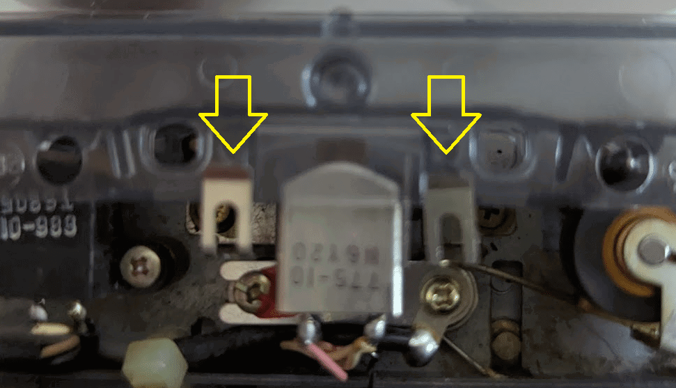

I figured it out.  I noticed there were two little metal things either side of the central tape head, and when I looked closely, one of them didn't seem to be lower than it should be.  The function of these metal things is to hold the tape down into position - they can however easily be bent out of place.  I bent it back into it was applying the right amount of pressure on the lower part of the cassette.  This means the cassette is now sat exactly where it should be, and plays fine.  The FF and RW also now work properly, and much faster, with less noise. I was only a fraction of a millimetre, but it made all the difference.  Picture added in case it's any help to anyone else with a similar issue.
