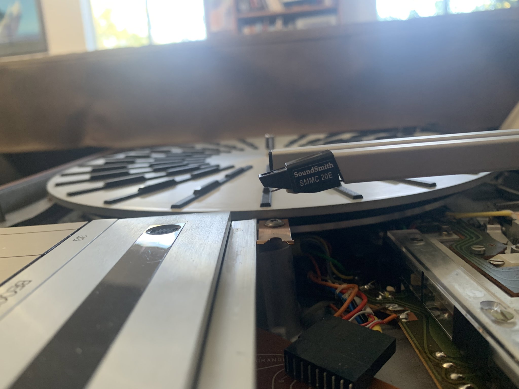

I picked up a 4002 with a problem with the arm, the cartridge plugs in at a bit of an angle causing the bottom of the cartridge to drag on the record. Anyone know how to correct this? Thank-you.

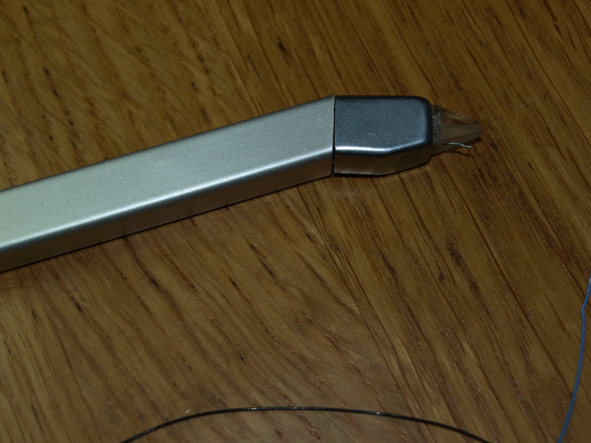

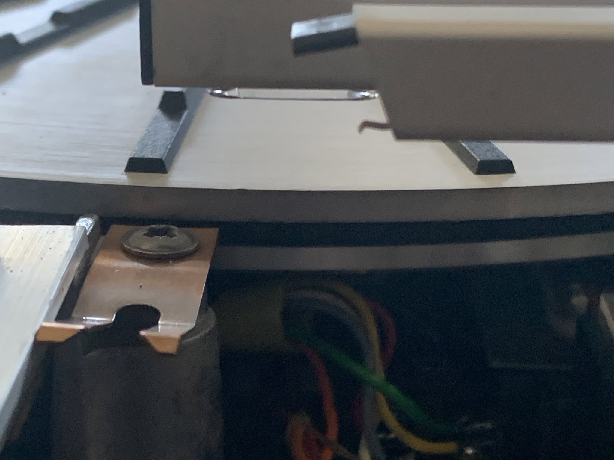

Thanks Craig, that is a good idea. The first picture shows what appears to be the lower copper spring/prong is bent upwards.
The next picture shows the angle of the cartridge plugged in. If the copper spring is my problem, are replacements available? And how does it come out? Or should I just try to bend it?

It appears the cartridge body grounding contact is not being inserted properly. There is a small cutout at the bottom rear of the cartridge that receives this copper contact.
Be very careful when removing or installing the cartridge, the plastic connector will be very brittle and susceptible to fracture, many have suffered this fate. As Mark says it looks very much like the cartridge isnt seated correctly on the grounding tab (copper spring that grounds and also helps keep the cartridge in place) make sure the slot at the bottom of the cartridge is free of any debris. These arms can be repaired however its a fraught excercise that requires a degree of destruction prior to rebuild, and of course purchase of custom 3d printed parts, available from Rudi at a cost....dont bend the copper spring, is meant to be shaped to fit....there is a distict "click" when the cartridge is fitted correctly.

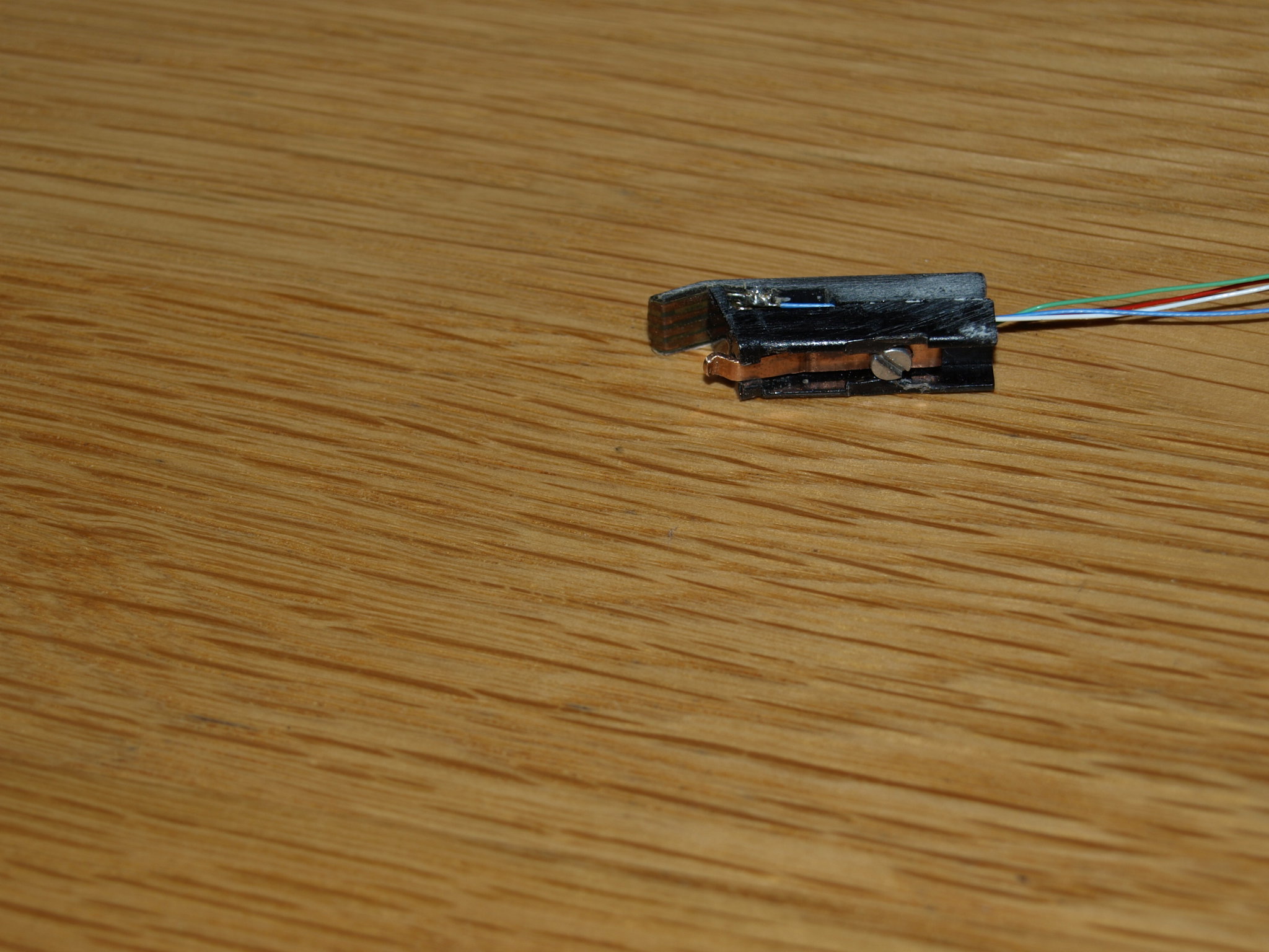

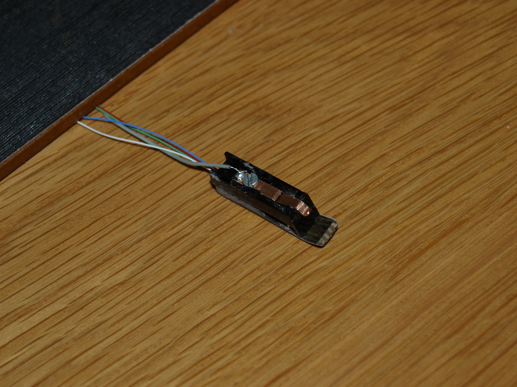

The insert that Craig has a picture of is different than yours which may be the problem. Not that your leading edge is not beveled like stock ones. This may have been a 3D print attempt at a replacement and is likely causing it to not seat properly. The arm can be carefully removed be removing the two top screws under the cover and desoldering the very fine enameled copper wires (marking them first. The cartridge holder is usually tacked-glued and I have removed them using a chop stick or equivalent to tap it out from the rear. However, as this looks like a repair attempt with a non-B&O part it is unclear how it was affixed so I would proceed cautiously. It is safe to apply a heat gun (low) to help loosen the glue.
