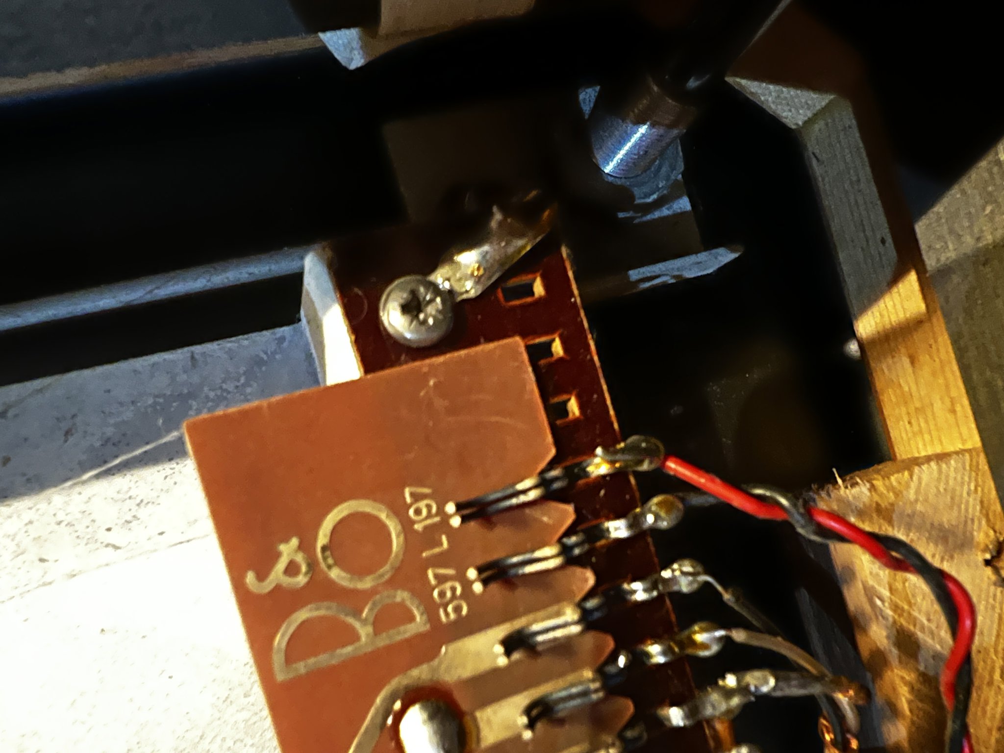

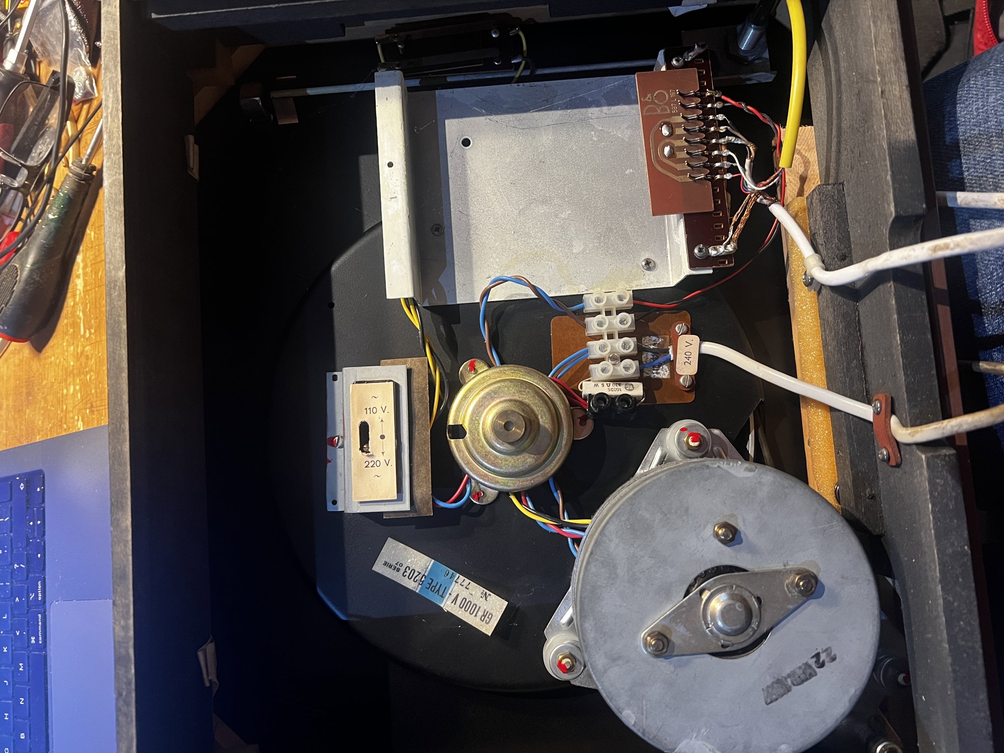

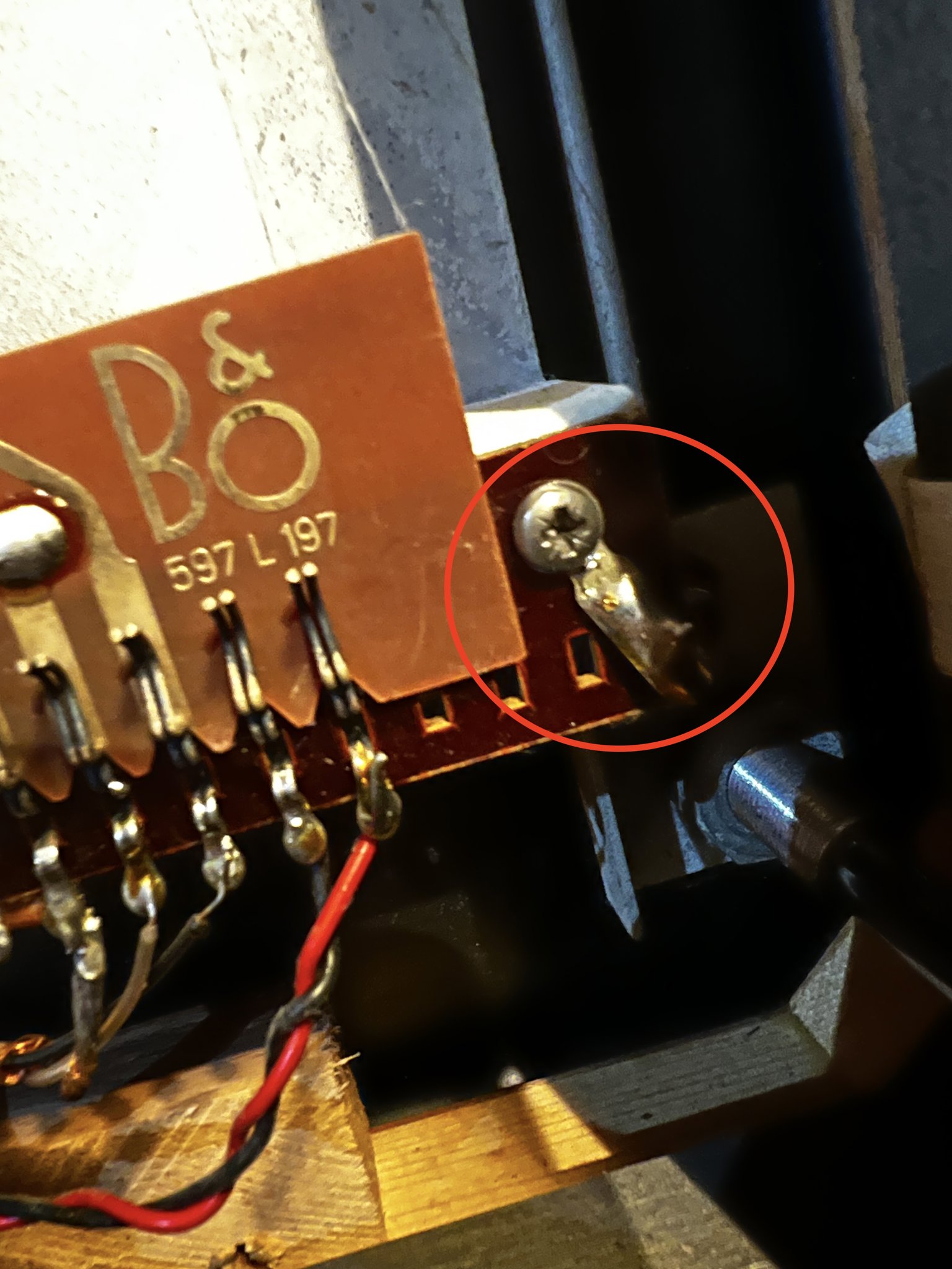

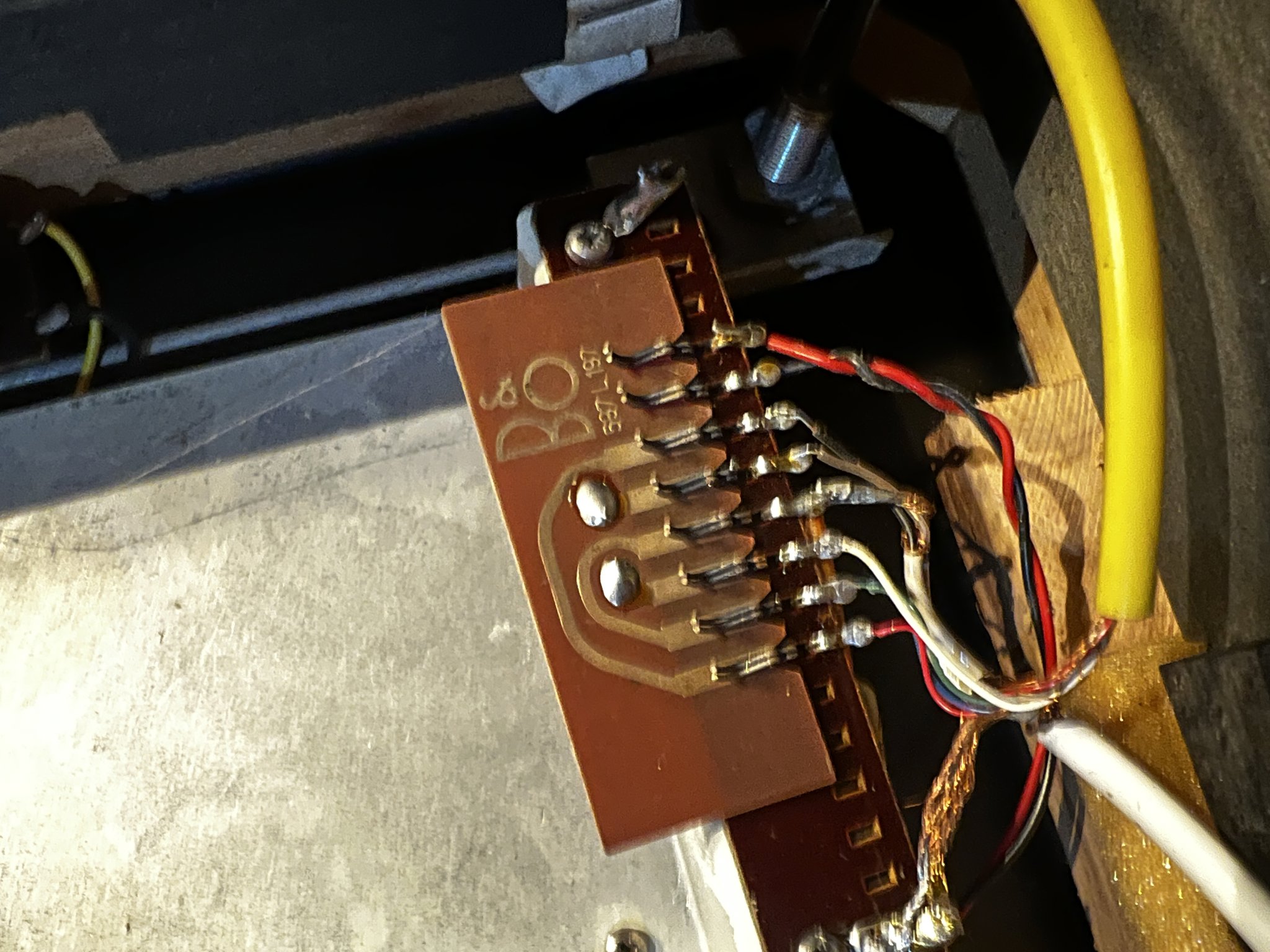

I just got a Beogram 1000, it's not working, the electronics inside look like someone has had a go, the wire on the right looks like it's totally missing, can anyone explain what's missing, or give a diagram of what it should be? Thanks you
I’m not sure which wire you believe is totally missing. If you are referring to the Red/Black twisted pair in the first picture that appears unconnected, that is normal for 1000’s not equipped with a phono PC board. Yours simply has the jumper board that directly connects the tonearm cable to the output cables which then go into a preamp’s phono inputs. What is actually not working?
Hi, thanks for the response, its the connection on the very right that has nothing on it. Nothing appears to be working at the moment.
That is simply a chassis ground.
Thank you, I will have to dig a bit deeper and see if I can find someone locally to take a look
On a turntable that old, if its motor is not turning then the grease has hardened and bearings dried out. You never posted what is actually not working.
Will the motor rotate easily by hand? If not, take apart, replace bearings, clean and lubricate etc. Martin
