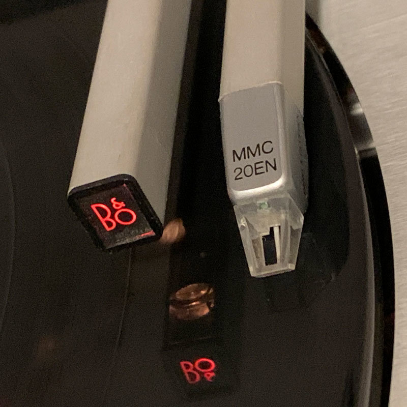

Here a pic with the platter on. There is a little crack on some rings, but seems to still be good. I'll leave that alone. The tonearm and top plate are in good shape.
