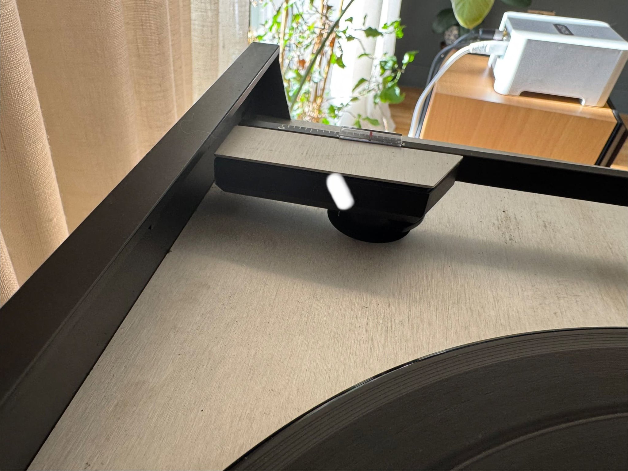

Hi - where is the screw though? on the outside part of the counterweight, where the slider is or on the inside - see the picture - there is a screw on the inside part of the counterweight, where I marked in white - as it is dark and was not visible on the picture.
Lift the silver counterweight out of the arm and you will see it.
