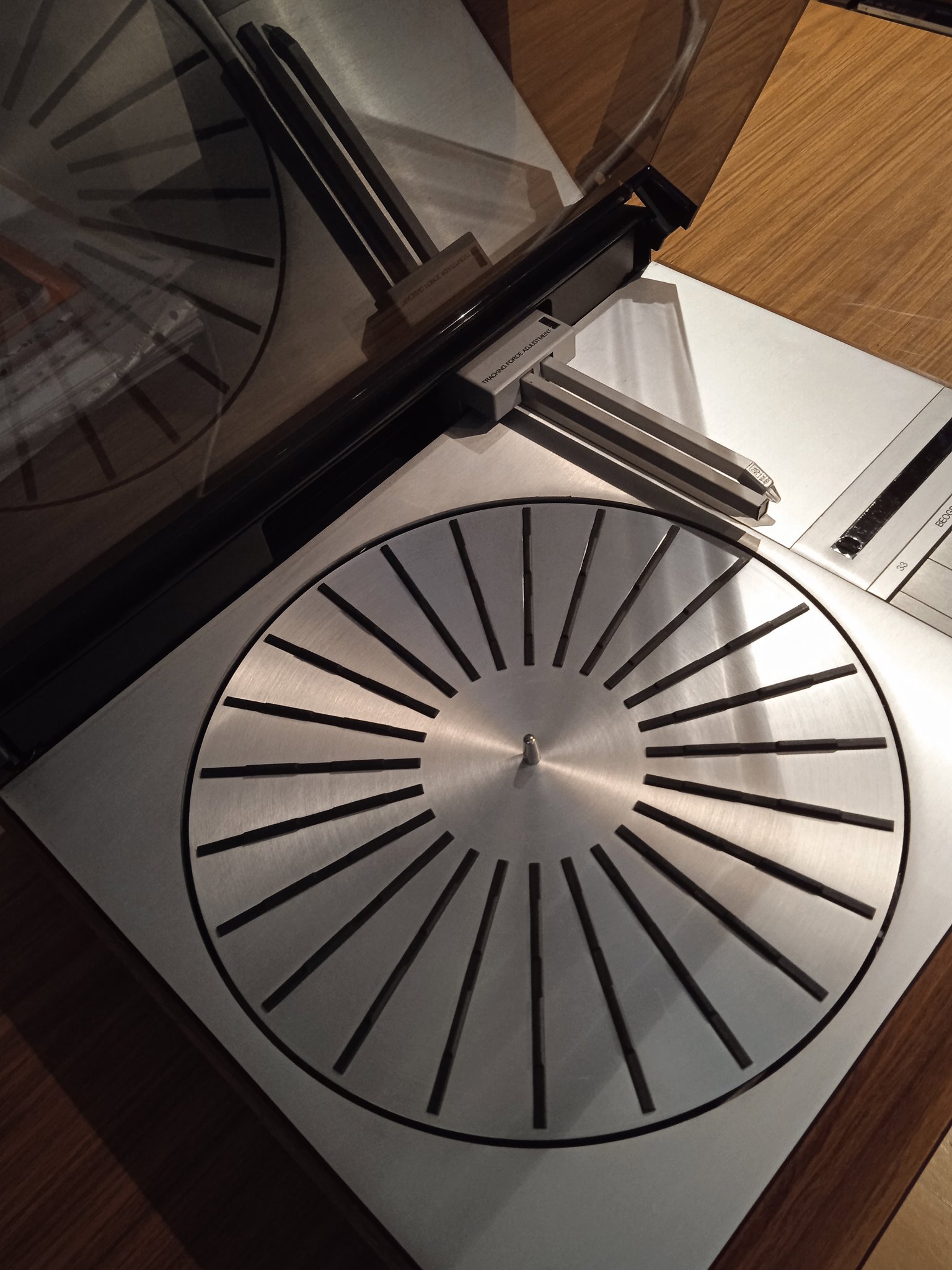

Hi. I've just purchased a Beogram 3000 turntable and I would like to connect it to my Beocenter 2300. How can I do it? Thanks
The BC2300 does not have built-in RIAA so in order to use the BG3000 you would have to add a phono/RIAA pre-amp. Here’s one that Steve sells but see the note at the bottom about lack of remote control:

Thanks Guy!! Joan
