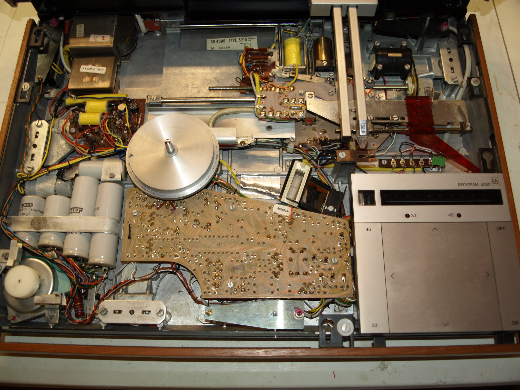

The BG4000 looks in very good condition internally with no signs of previous repairs...always a good sign
not sure about the quality of that image, but all looks well inside

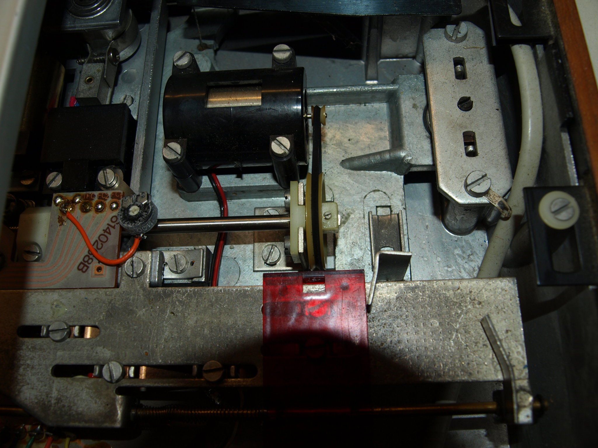

Carriage drive belt is a bit out of alignment, not a problem.

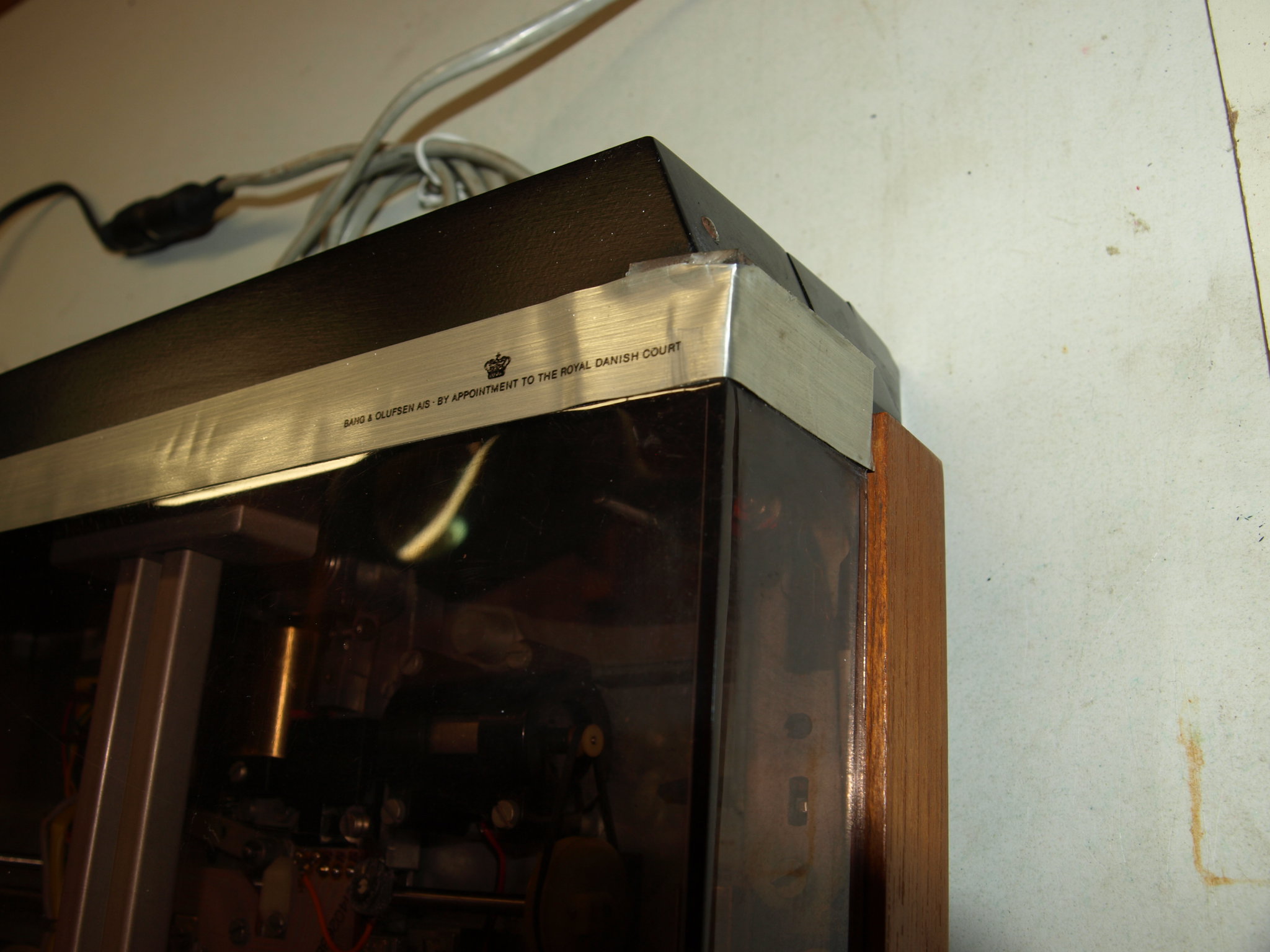

However the dust cover looks like some work has been carried out, this will require some attention...

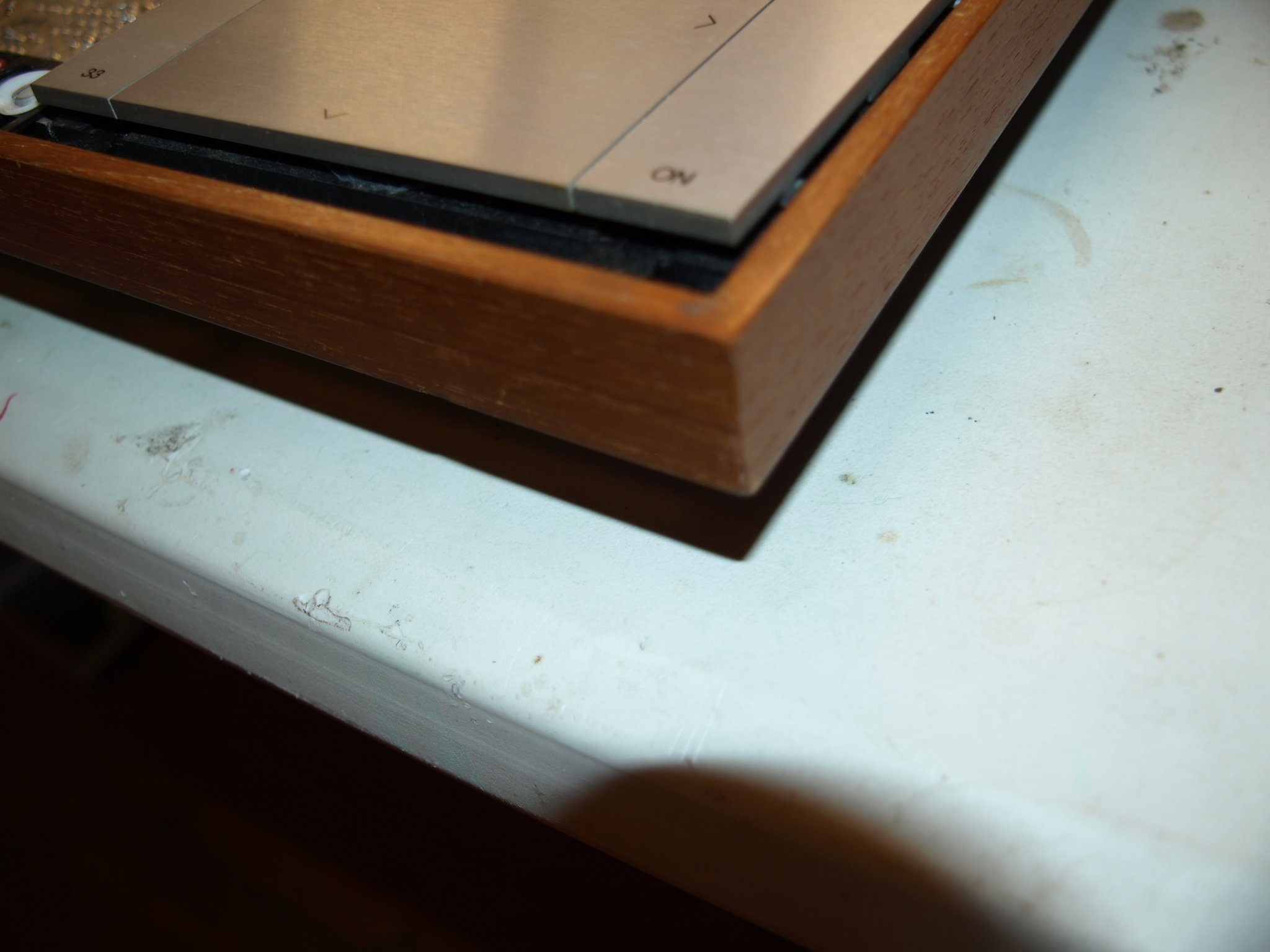

The wood trim looks in good shape with all corners still sharp and clean
Overall the unit looks in good shape mechanically, and mostly cosmetically too.
A test run will determine if there are any issues functionally..

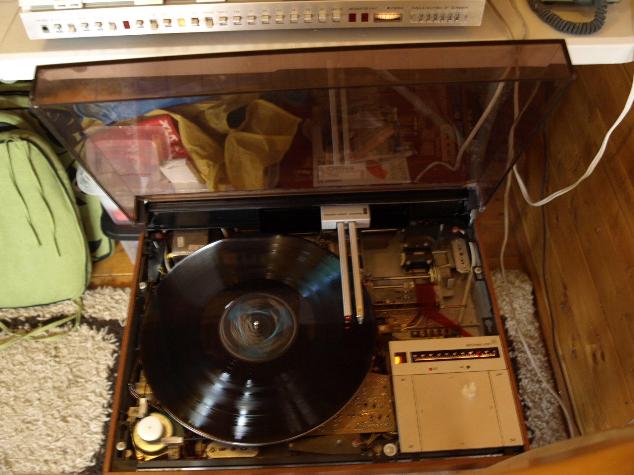

Powered up via the variac and all is well, no smell of burning or sudden cracking of blowing fuses....hooked up to a BM4400
With no fault finding/repairs required, good news, a kit to include all the usual caps and trimmers along with drive belts will be ordered from Dillen and a straight forward replacement carried out.....the trim will need attention, it has been repaired once before but needs a little more work
