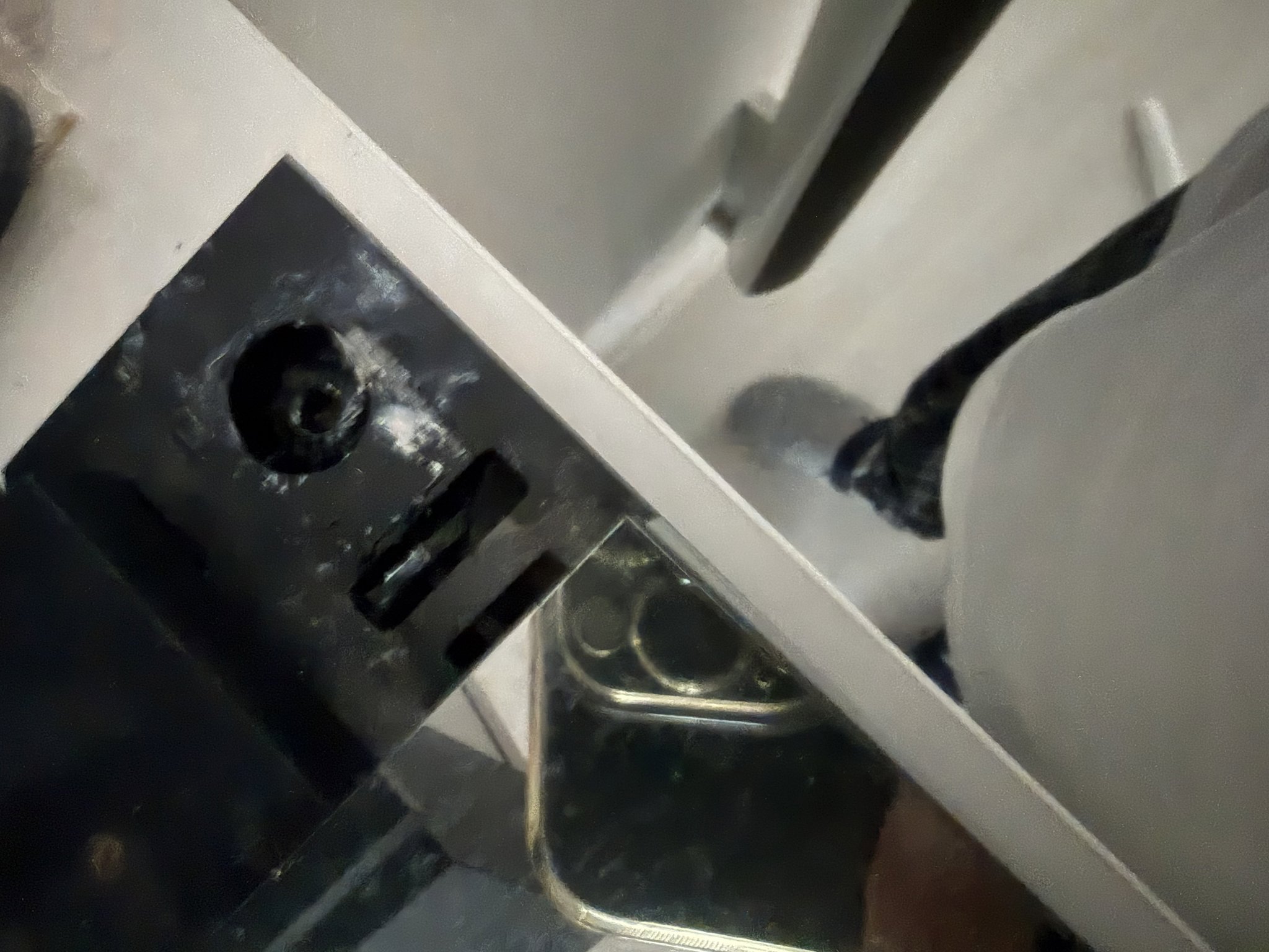

My Beogram 4500 hinge has come out if its location, i noticed some plastic broke off where it was attached… is there a wat of fixing the hinge back to the top plate as it will not go back in place.
Did the plastic break off from the lid or the rear where the hinge attaches? Can neither screw attach? Best would be to upload a picture
It broke of the top plate where it fits onto the beogram 4500
Attachments (1)
Looks to me like the area the screw fir the hinge screws into the plastic around it broke someone tried a repair that worked for a while, however to me not a good repair. Im trying to figure out how i can fix it better and what to use to do so.
Your cropped closeup had me confused as to where the failure was. It is actually the hinge base not the hinge which has lost its screw. My recommendation would be to epoxy a nut (or if not wide enough add a washer)  to the underside from which a screw from the top can thread.
Thanks i got sine epoxy and it worked perfecty
