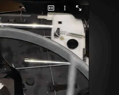

Here is the video. I hope it is what you requested. Any input is appreciated

The carriage string and the tension spring are installed onto the carriage in a way I've not seen before. It looks like they've stretched the spring to the point where its less spring-like I'd venture to say they snapped off the original string and tension spring mount on the carriage, and fashioned a new mount out of a screw. That in and of itself is not a problem if done properly. The installation of the string itself might need a bit of checking, but it does appear to roughly work as-is. I have not checked too closely, but at first glance, the gears all appear to be working properly. I do wonder if the jitter you see on startup is caused by a belt issue, perhaps by one that is not fitting quite right. Did they mention if they replaced it?
Also to add, in reviewing the movie you posted 2 days ago, I'd ask you to affirm that your cartridge is fully seated in the arm. It might just be the angle, but there appears to be a gap between the rear of the cartridge and the mount.
If the cartridge is affirmed to be fully seated (no gap), then the arm skating across the record is another matter, and is potentially an adjustment needed to the arm balance. You mentioned they remade something in the stylus head - by that do you mean the location where the arm attaches to the carriage, or do they mean the same fix of the broken string mount on the carriage? If there is damage to the arm that they attempted to repair, then this is where finding a used-but-working TX-2 can help you fix both issues - AFAIK the entire carriage assembly is a direct swap, and it will most likely come with an unbroken mount on the carriage as well.

Sorry, I have nothing but problems adding inline images to this site from work (seems to work better at home) , so I've included a photo as an attachment instead of an inline photo. The retention tab was broken on your machine, and replaced with a metal pin of some sort. There's no reason I can think of that retrofitting a new pin wouldn't work, provided it's in roughly the same place. But it appears that they've over tensioned and ruined the spring, which raises more questions about what else happened with the unit under their care.
