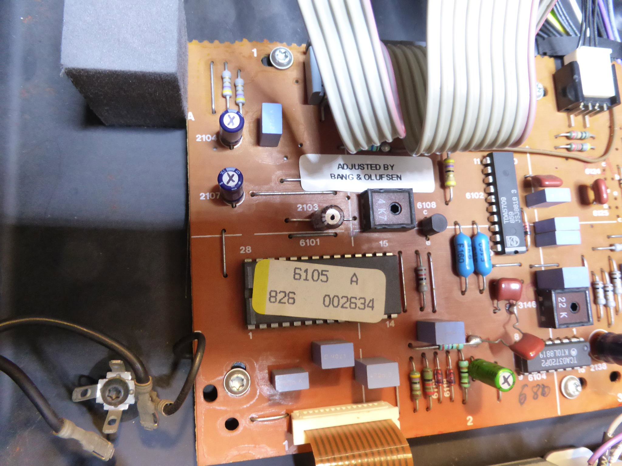

You would have to replace the blue Phillips capacitor C2108 and then your 5500  are playing again, that is a common problem on most  CD players. you can buy the kit here: https://www.beoparts-shop.com/product/capacitor-kit-for-cdm-disc-drive-servo-beogram-cd-beocenter/
It's C2103. Indeed it's the blue one to the left of the microprocessor on the above board. A very simple capacitor to change, as long as you get the right one :)

Its a axial 33µF 16V Capacitor. I just exchaned it on a Beogram CD7000: Old: New: I used a radial 33µF 25V one. It worked like a dream.
