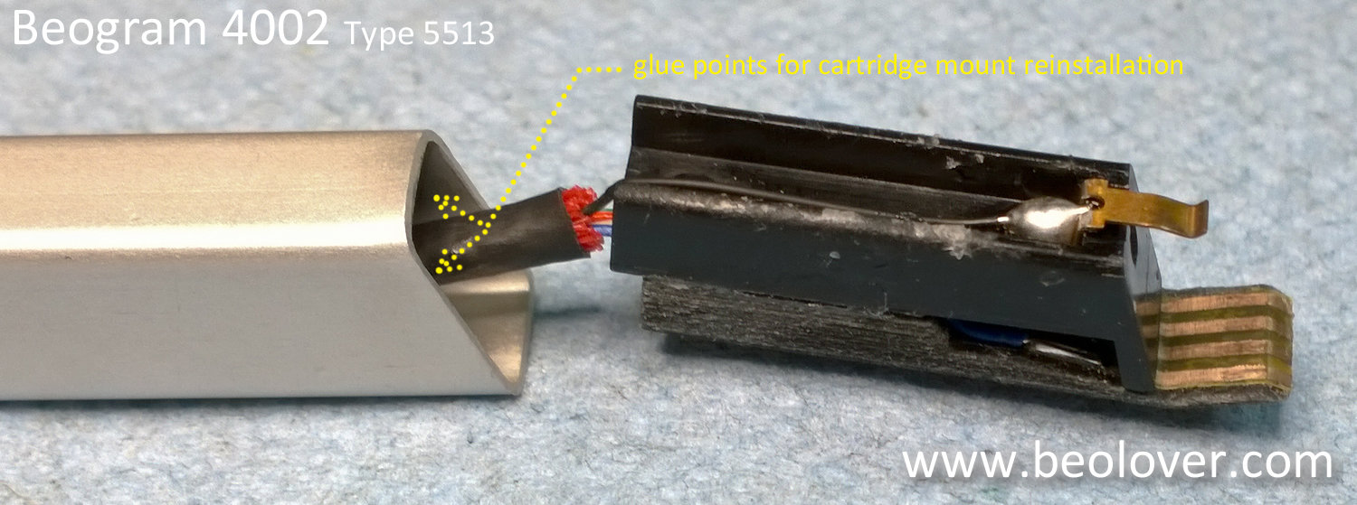

Can you take the back right square cover off by sliding the trim forward and snap a picture of that entire area? It’s possible the chassis ground is not properly connected. Also if you remove the cartridge, you should see a small flexible copper tang coming out of the bottom of the black connector. This connection is designed to ground the body of the cartridge since moving iron cartridges with their relatively low outputs are susceptible to hum. If that was damaged or missing that could also be your problem. Here is a link to a picture of the cartridge holder. If you have an ohm meter with the stylus cover on but the arm lowered, you should have continuity {<1 Ohm) between you ground wire and the cartridge shell.
