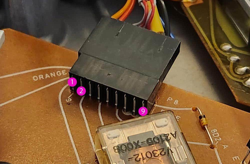

I finally managed to take the measurements According to this picture
Tonearm raised, I get
  • 1 -> 30.7 V CC*
  • 2 -> 21.7 V CC
  • 9 -> 0.7 V CC
Tonearm sets down, I get
  • 1 -> 28.8 V CC*
  • 2 -> 21.7 V CC
  • 9 -> 15 V CC
I also played with TR2 and I don't get the impression that it has any effect on the circuit.

It’s actually Pin 1 that is biasing 8IC1 to turn on and close the relay. You are getting the correct input voltage so I would look at the trimmer 8R2, 100mf cap, 8C1 and diode 8D2.
Thank you again so much for your help. I'm going to change the 100mf cap because it looks worn out.
It seems that 8d2 is fried. I'm going to replace both of them, we'll see.
