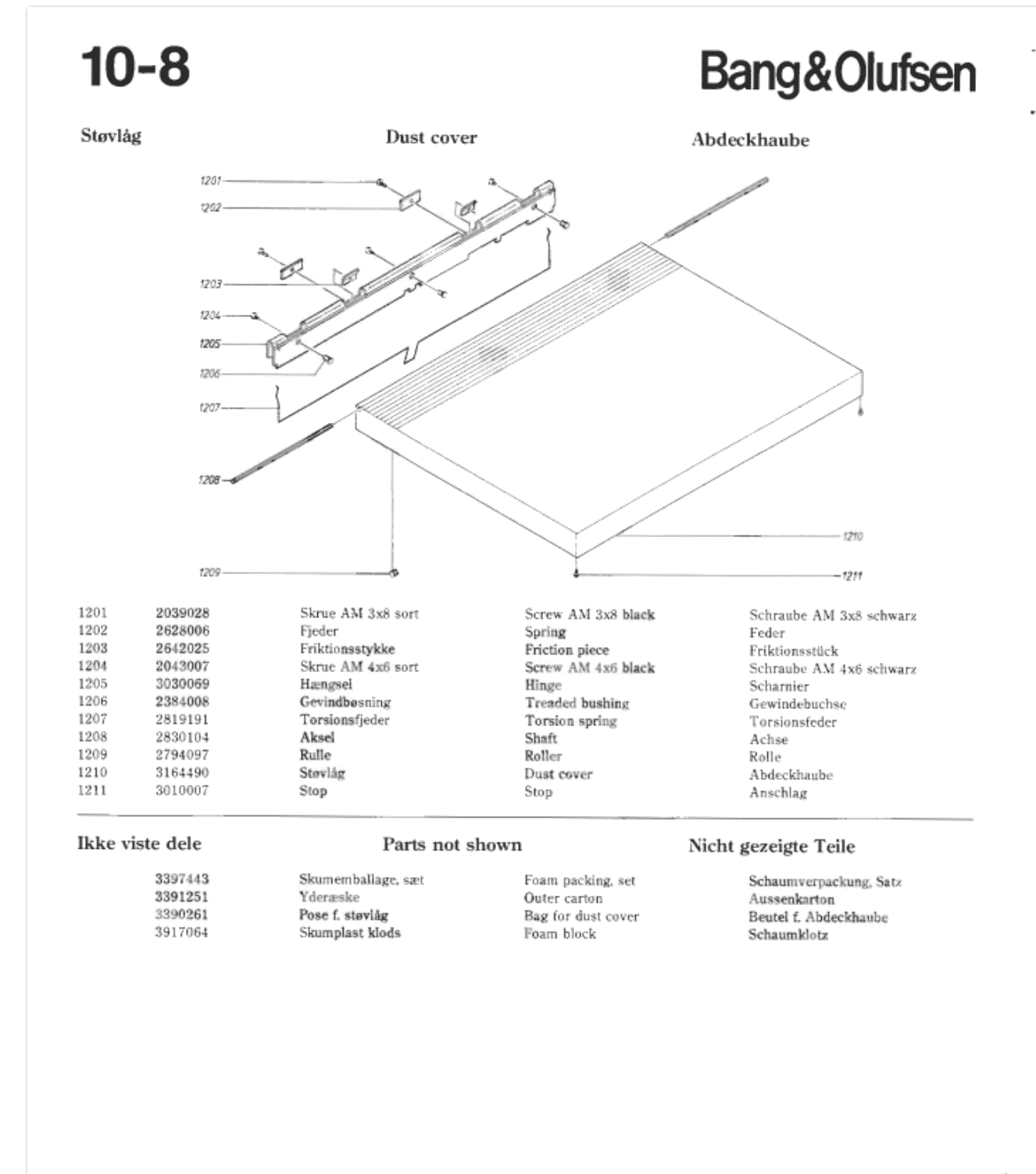

Hi, I had some problems with the adjustment of the turntable, so I took the dustcover off... Now I am having problems putting it back on. Wished I had not taken it off... Can anyone tell me how the two brackets 1203 must be placed? Over or under 1207 the metal spring? Tried several but when I put them under I cannot get the cover back in place. I think it should fit in the holes but unfortunately that is not enough. Tried chatgpt but not helpful enough. Been busy all day with this. A drawing would be great....

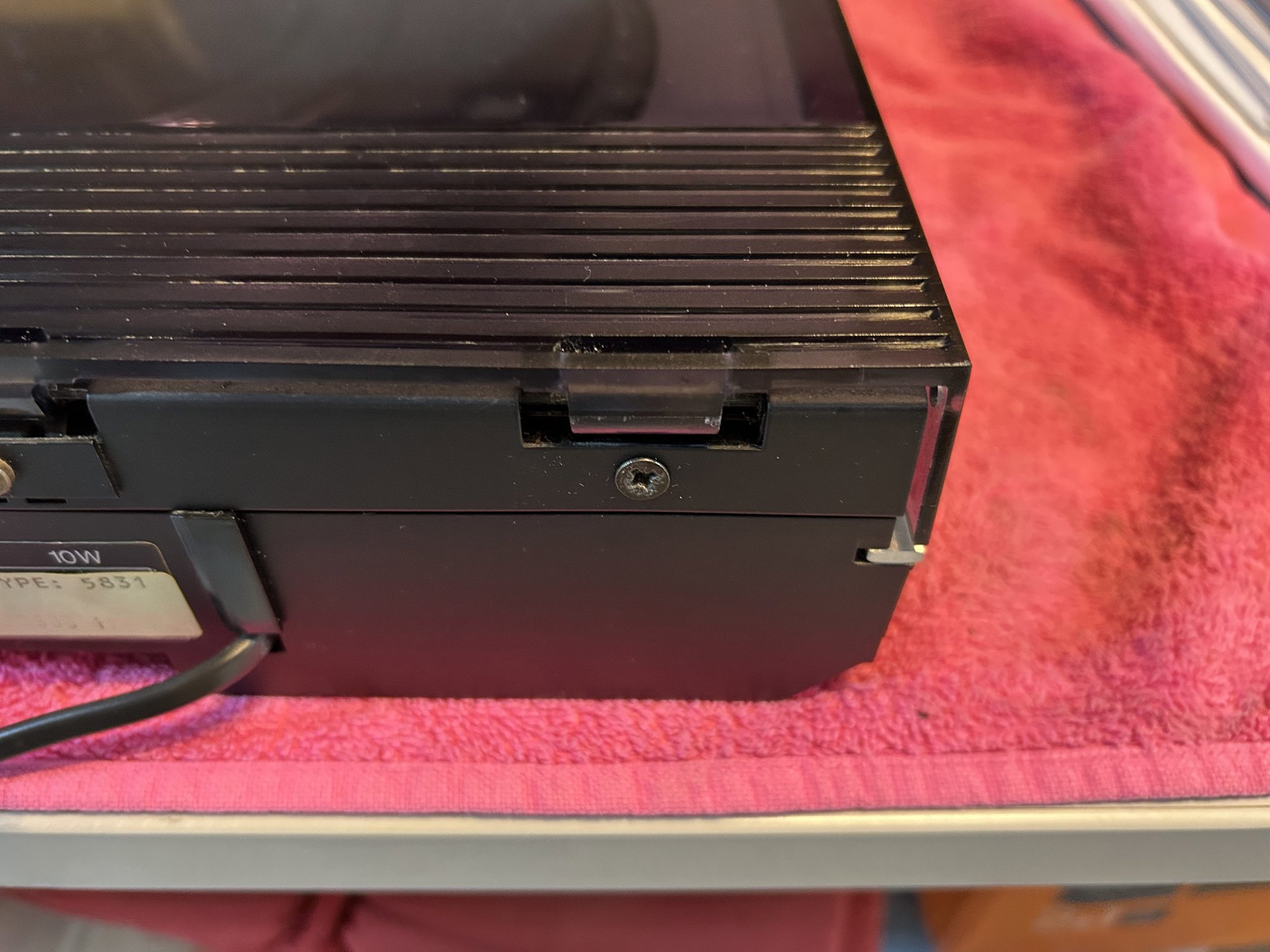

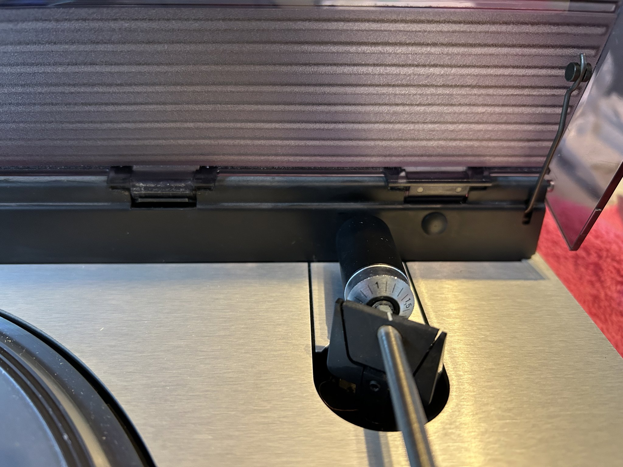

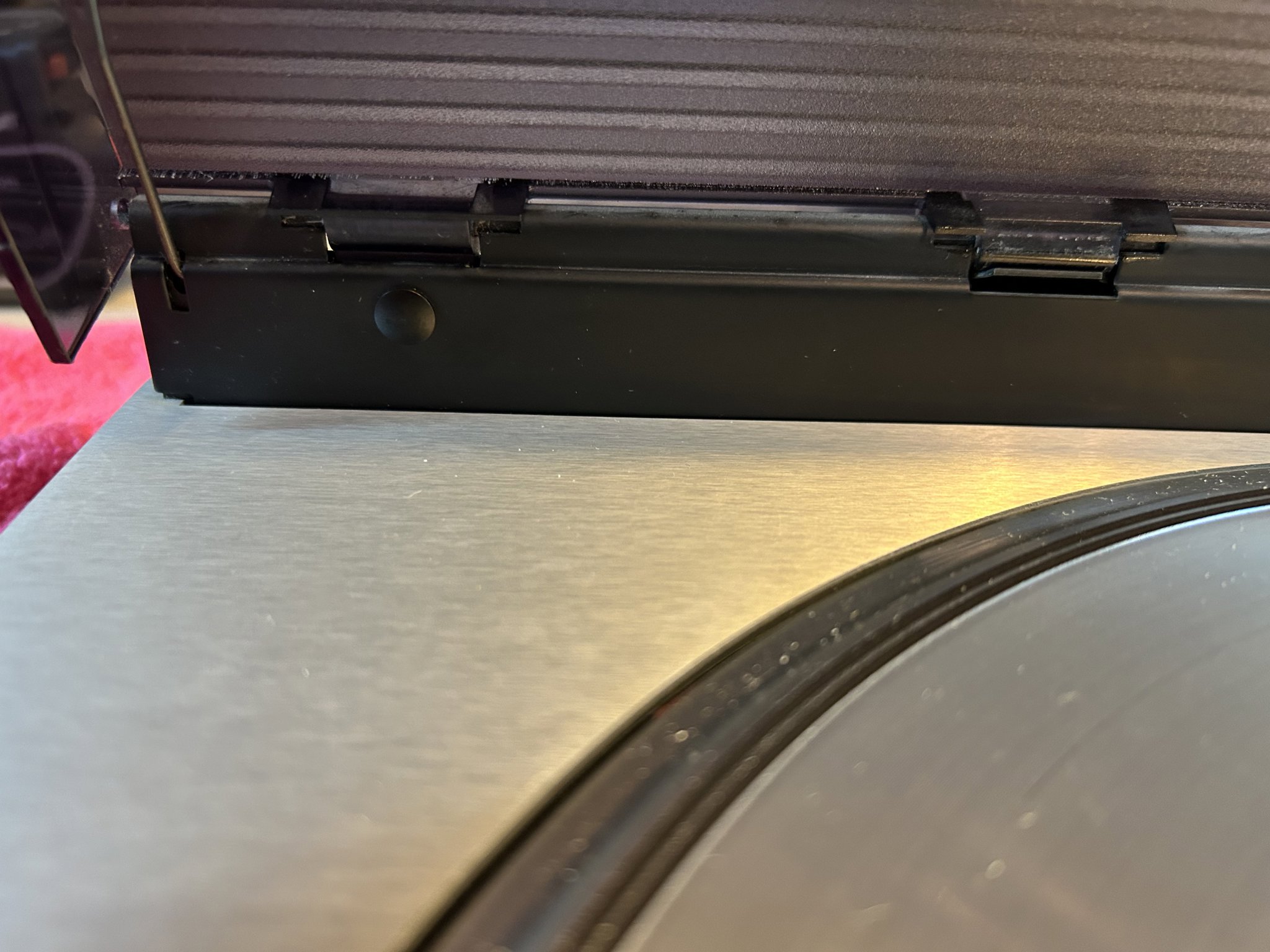

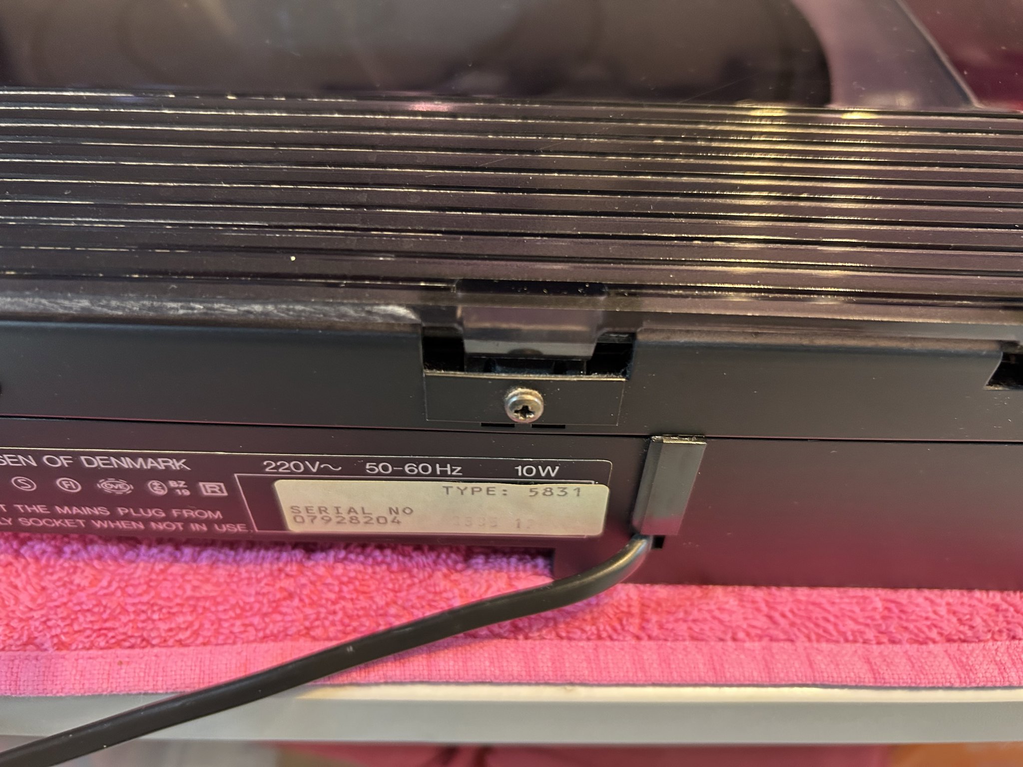

I have an RX2 and will look at it this weekend. I will make a picture of the mounting, if this helps? Kind regards, Rolf

Hi, here are some older threads dealing with the topic, maybe this helps: . My pics:
