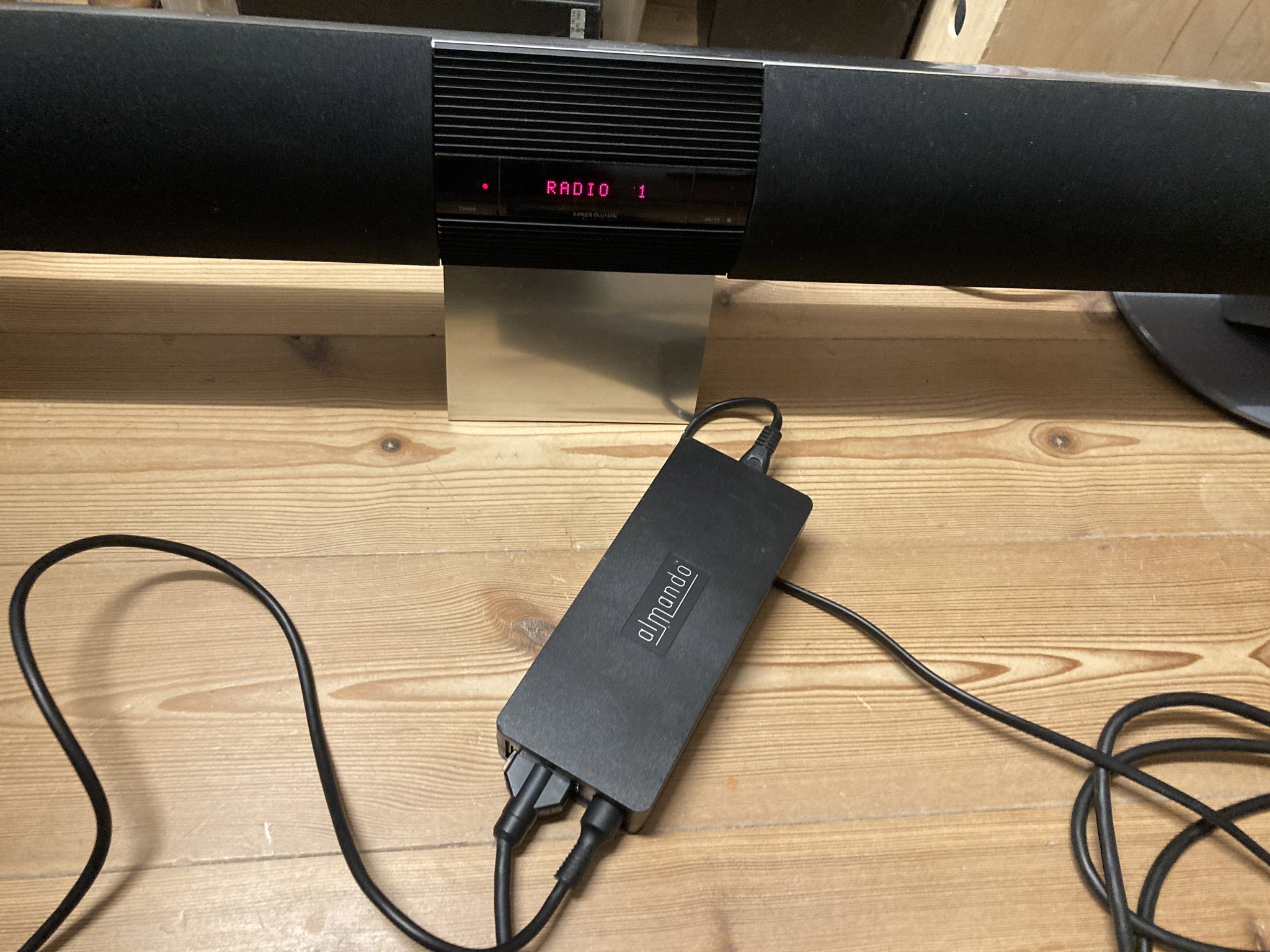

Use cases via Beolink Converter 1611 and ML connector
Beolab 3500 MKI or MKII connected to Beolink Converter type 1611, two sound inputs controlled with Beo remote via custom cable /api/files/6435e06981ab417f8a0e27d731b2b0b0
Usermanual for version II from Almando's web page: Login to view image
As for the inner workings of this product as far as I can tell it is using some Masterlink trickery as the data + and - voltages are not +0.25V / - 0.25V as they normally should be. I measured them to +0.22V and -040V which looks more like a not connected Masterlink product. This might also explain why Almando states that only one Beolab 3500 can be connected to the Masterplay.
