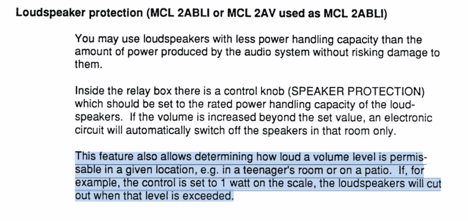

Thank you for scanning, MCL stuff is always appreciated! I was looking at your other manuals and I hadn't seen this use case mentioned before: in the MCL2 System manual:
I find the idea of a teenager having an MCL link system in their room amusing, and how B&O managed to turn a safety circuit into a parental control feature! Only preset volume parties for the teenagers! 😁
