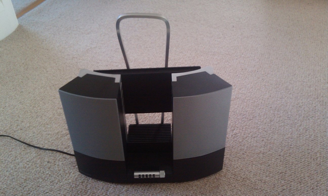

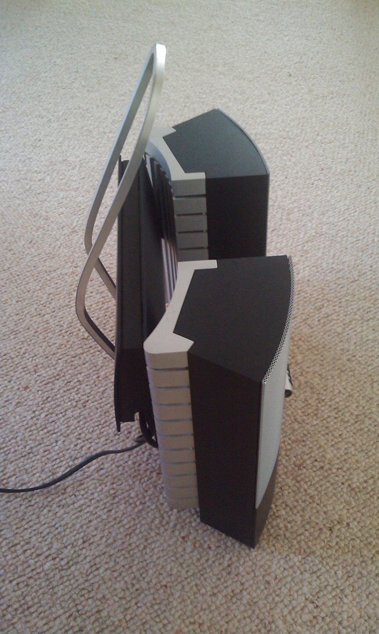

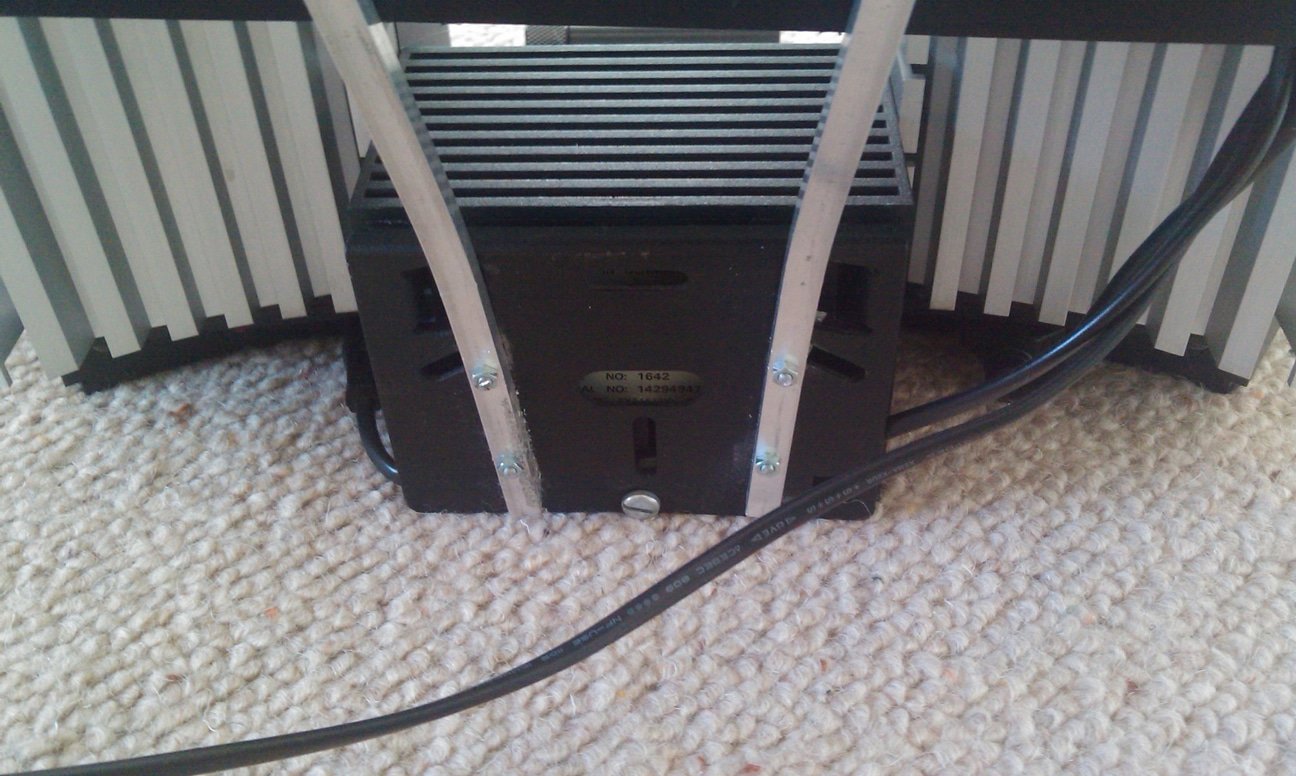

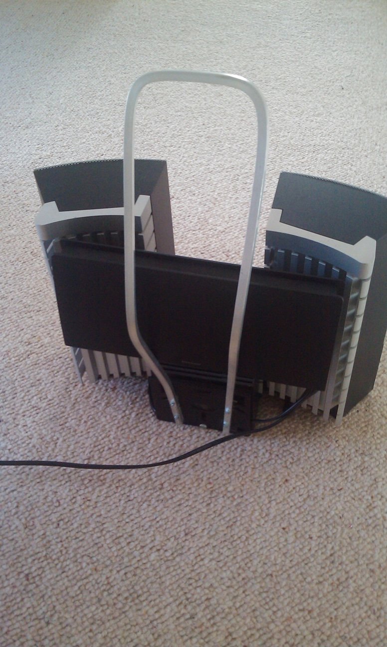

It definitely does work if you have the correct software versions. I had my 5 Wireless 1's Updated to the most recent software a few years ago. Are you aware that all software versions on the Wireless 1’s have to be the same for them to connect. I made two of these “portable” Beolab 2000s. We use them outside in the summer so we don’t have to have the HiFi blaring to hear the music. Just need to plug them into a power socket and turn on. I made the aluminium handle and bolted it to an original wall bracket which the speaker “hangs” from. There was a space for a small screw to hold it all safely on the bracket. Steve at Sounds Heavenly made very short Masterlink cables so I could connect it all up neatly and just have the power cable showing.

Yes I think I saw an older post when you mentioned these.  Very creative! I was only testing them out of curiosity really - my best use for them will be with a pair of Powerlink speakers (BL6000), but if I do get the opportunity to get the software updated, I will.
