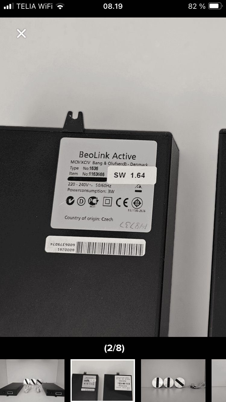

Browsing a local second hand sales platform I noticed a Beolink Active with an added label stating SW 1.64 Till now I have not seen any Actives with SW versions higher than 1.6 for the Beolink Active, but there could be special issues that this version will adress. Does anyone have any info about what this Software version has fixed?

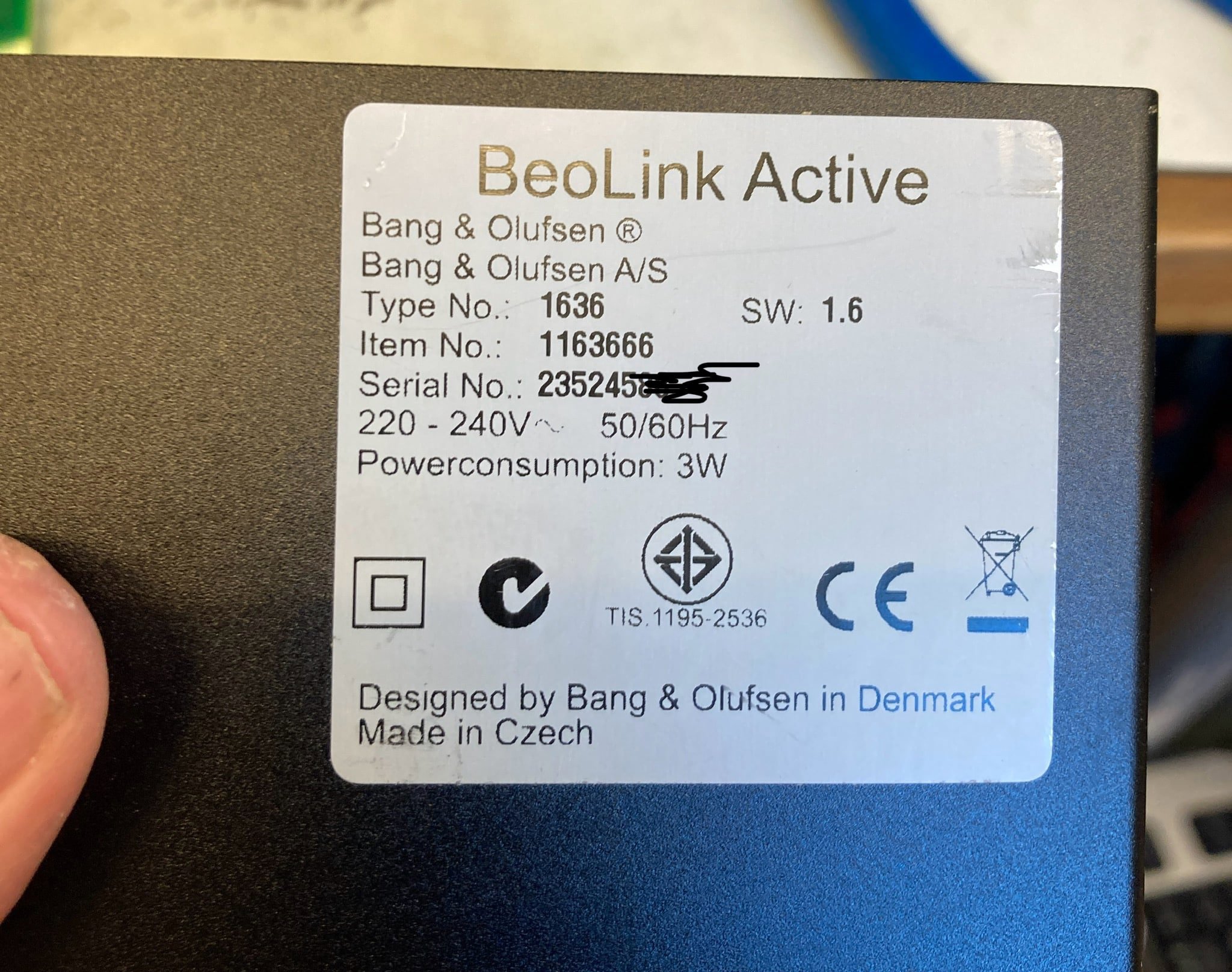

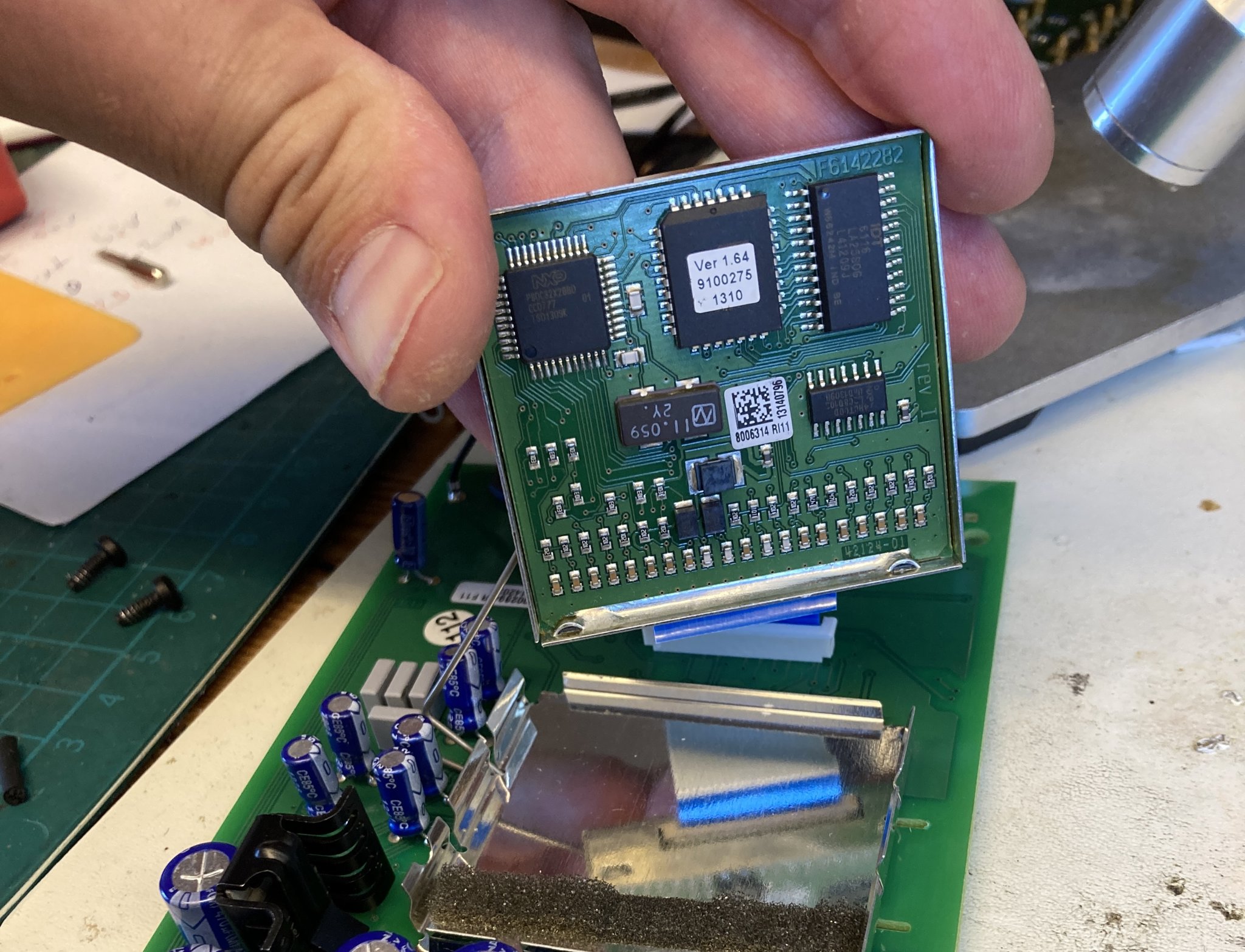

I have a little more info regarding the SW 1.64 for BL Active. I just aquired two BL Active’s as part of a LOT. Both have SW 1.6 written on the official label. Just to be sure that they were not downgraded I have opened both up, and on one of the chips in the microcomputer is a label with the text Ver 1.64 So my best guees is that B&O has made small software revisions along the way in SW1.6 without announcing it on the product label. SW1.64 is probably from a certain serial number and onwards
