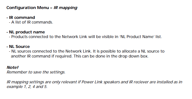

If I should guess you are trying to get the BS4 Aux input activated with the PHONO/N.RADIO command by trying to change the command in the NL/ML converter? Good thinking, but I am not sure that it is possible. If I understand the manual for the NL/ML converter correctly the IR mapping features is for choosing which source name a ML source should have on the NL network:
Not sure if that also applies for the Converter IR eye too. Others might know better. I can also try to test it at one point, but it might take some days before I have the possibility to do so.
Just to be sure what you are doing:
- What role have you setup the NL/ML converter to have?
- Is the IR mapping setting you are mentioning like this:
