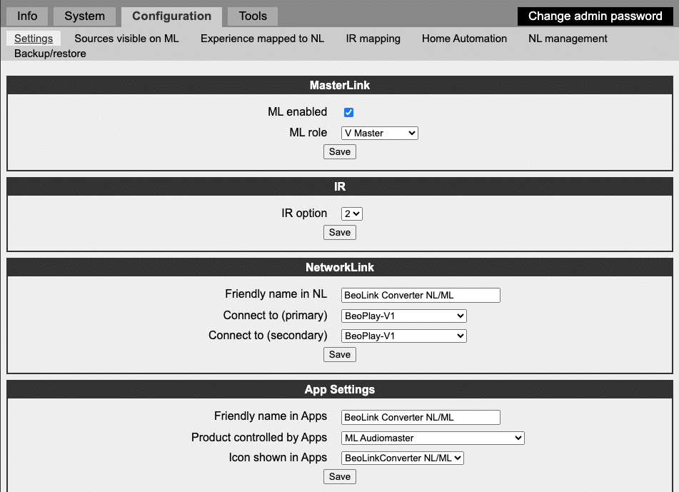

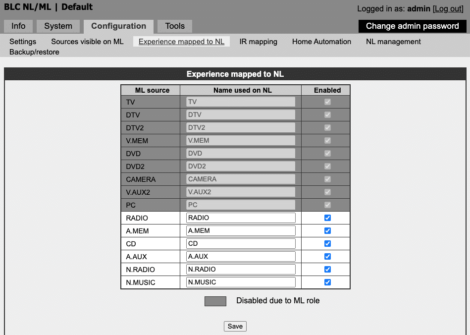

The setup of the NL/ML converter is as follows:
Pressing CD on the BS Ouverture starts the Beoplay V1 and the music is playing through it's speakers. So it works, at least with the Ouverture.

I also checked settings on the TV again, and I am not sure if this is something I have set manually, or if it wast automatically set based on the settings in the NL/ML converter, so here goes (disclamer my menu language is Danish, so translation might be different with english menus):
In the menu Product integration ->Connect to other products
Product 1: Beolink Converter NL/ML
Speakers to: Beolink Converter NL/ML
If this has to be set manually it might make a difference in behaviour
