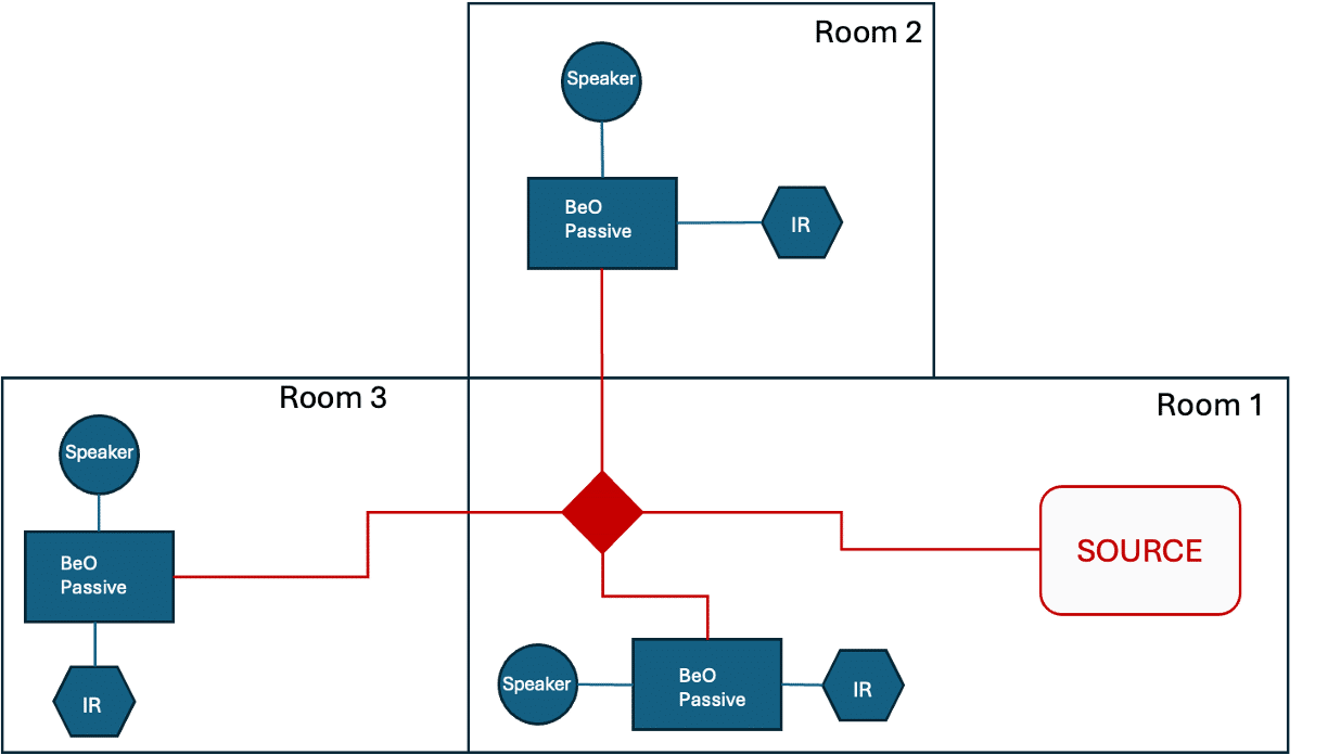

I just bought an apartment that is fully wired and equiped with BeO Passives.
The previous owner left all the "backline" but took the source with him (surely a Beo Ouverture).
it is wired as described in the scheme right under (each BeoLink Passive has its speaker and IR, all the masterlinks are connected to a central point, connected to the source with Masterlink)...but my question is : "Is it possibile to plus a very simlple source (e.g. a digital one (BT receiver, phone...)) as a source without having to buy a new Ouverture (or equivalent). Does a simple box that would take an Aux as entry and Masterlink as an output, able to "wake up" the passives Beo links exist ?

You can use a Beolink Converter type 1611 as a source. This can give you 2 inputs that are selectable in the room by using either a audio (eg. CD, Radio, A.mem etc.) or VIDEO (eg. TV, DVD, V.MEM etc.) command from a Beolink 1000 or BEO4 remote. Furthermore the AUDIO source can be selected directly on the IR eye's by pressing play, and turned of again by pressing the same button.
