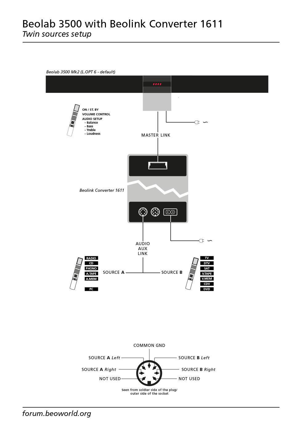

To explain your observations about the 1611 it csn work as a stand alone audio and video masterthus allowing for two selectable sources on any ML link room product. This was tested very throughly in another thread which among other things resulted in this great sketch made by Matador https://beoworld.org/wp-content/uploads/beoworld_images/24903/fpsantcr1nreqhki1h7n4w2zt2x2471h.jpg" target="_blank">https://beoworld.org/wp-content/uploads/beoworld_images/24903/fpsantcr1nreqhki1h7n4w2zt2x2471h.jpg">https://beoworld.org/wp-content/uploads/beoworld_images/24903/fpsantcr1nreqhki1h7n4w2zt2x2471h.jpg
Location: Denmark
I have been working my way through that thread, there's lots of good info in there. I'd not really appreciated you could get an output from e.g. the Tape socket on a Beomaster, though I realise now that's exactly what the Audio Aux Link into a 1611 is all about. There's a world of non-wife-friendly possibilities with this stuff!

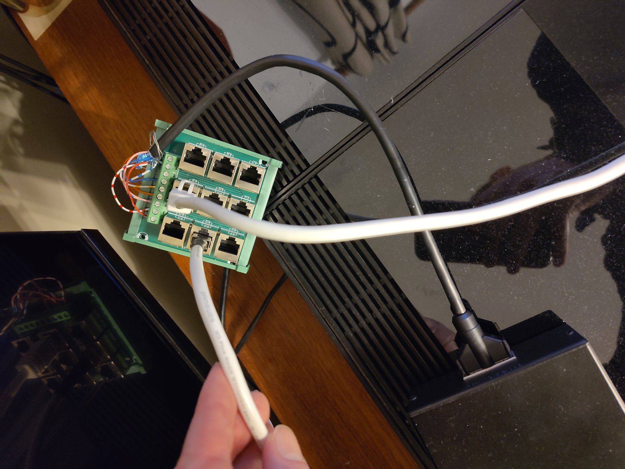

Results of today's experiments! Firstly I was wrong before about the Beolab 2000 working differently to the Beolink Passive. It doesn't, the results are exactly the same. I've got a long sheet of permutations and results, but they all correlate so far into two scenarios. Setup is: BM6500 Aux socket > 7-pin 'Audio Aux Link' cable > Beolink 1611 converter > Masterlink to RJ45 distribution board* > BL Active/BL Passive/BL2000/BL3500 Results are: Any one of BL Active/BL Passive/BL2000/BL3500 connected: Pressing the standby button directly or via Beo 4 / Beolink 1000 on the link product turns the whole system into standby Any two of BL Active/BL Passive/BL2000/BL3500 connected: If both link products are On, turning either of them Off (into standby) works as it should, with the Beomaster and the other link remaining On. But if the second link product is then turned Off (standby), the whole system turns off. This is the same whichever link products are connected, and whichever order they're switched on or off in. Putting the first link product into standby works as it should, putting the last link product into standby turns everything off. I don't (at the moment) have enough bits of Masterlink cable with the right ends to try more than two link products at once, but I suspect the same result: last one into standby turns everything off. As reported above the same behaviour appears with one product and genuine Masterlink cables so I don't think it's my home-made RJ45s at fault. So I still don't know if it's my 1611 or my Beomaster that's at fault, or something else. I have a bid on another 1611 on eBay as that's the cheaper experimental option! Would like to try with a different AAL- or Masterlink-enabled Beomaster but I don't have such a thing. At the moment.
  • quite pleased with the RJ45 distributor, a few £ from eBay and easy to attach a Masterlink cable to. All shielded/ grounded too.
