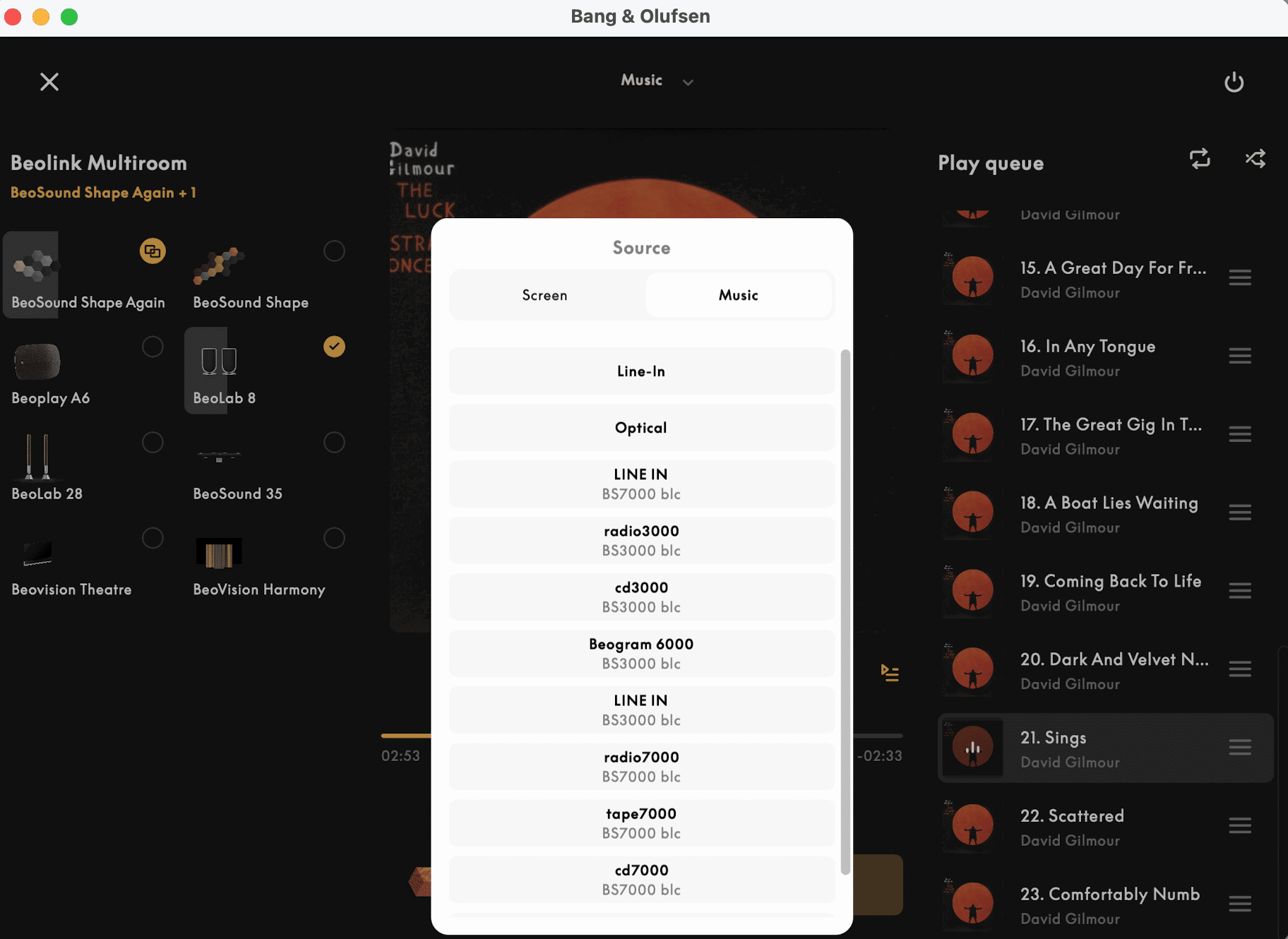

I have been thinking again about your setup

  Additional with BLI...... I can start any source in the system on any device in the system with my Beoremote Halo's. This is made possible by "Lua" programming of the Halo.   The main difference: my system is general setup as NL with ML product added as sources.
