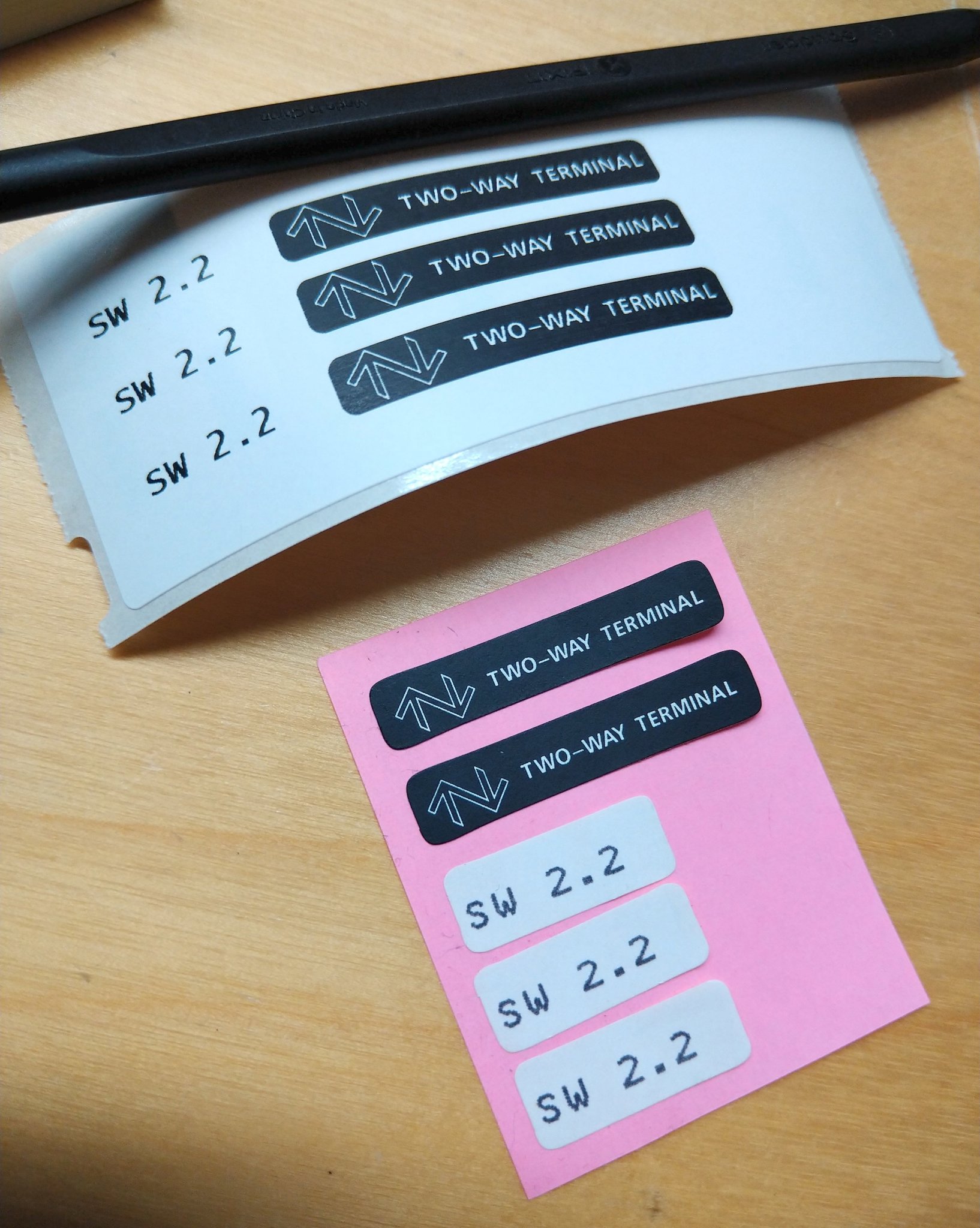

Added now to the archive.org item: I scanned the single-page instruction sheet on where the dealer preparing the upgrade should stick the version stickers to, and most importantly the nice two-way terminal labels (to be placed on the BM and the box) 😎 Using a Dymo labelwriter, I printed myself new ones (as the NOS stickers had completely lost adhesion).

Very nice touch with the labels. Do you know if these labels only was used for the 4500 since it got new functionality or if they were also used on other two way capable systems?
Location: Denmark
I'm pretty sure I'd have seen the black two-way terminal -stickers on somewhere else but can't remember. Then again, I might be mistaking it for the similarily styled black BEOLINK sticker that can be seen on fe. BC9000's back (no two-way IR there but I presume it hints to the device communications over the 7-pin DIN connectors and/or the MCL2 system).
