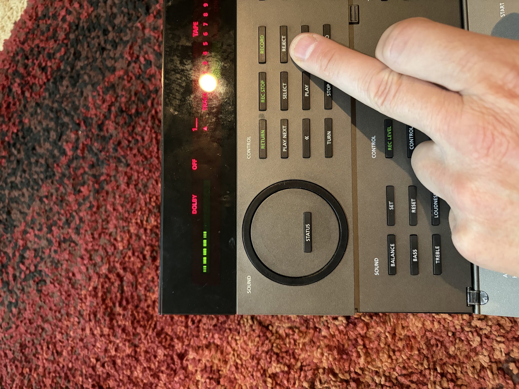

Proud owner of a Beomaster 5500 system. Everything appears to be working well except the Master Control Panelvolume wheel and radio station Up and Down buttons not functioning.
When wheel is turned, nothing lights up on display. When radio buttons pressed, no stations are presented. Based on research, my understanding is that I need a Micro Switch to fix the wheel. DOES ANYONE KNOW WHERE I CAN FIND ONE OF THESE? I looked online but have found nothing. For the radio buttons, it appears I may need to clean the contacts. Any support that can be provided is greatly appreciated !

Guy, thanks for your response. I have already cleaned the microswitch, with contact cleaner, but it did not have any effect. When you say “shorten the contacts”, does this mean squeeze in the contacts inward while turning the wheel or something else?
I tested the micro switch with a DMM. When the wheel is turned and the metal bar in the middle makes contact with either side contact, there is continuity.  So at least that part of the switch appears to function.
The opto coupler was the next potential issue I was going to look at after ruling out the micro switch. I guess at this point it makes sense to rule out the opto coupler.  Looks like a simple repair, unsolder and resolder three pins. Any chance if you know if there is a certain polarity to the opto coupler pins? I want to avoid installing it incorrectly.

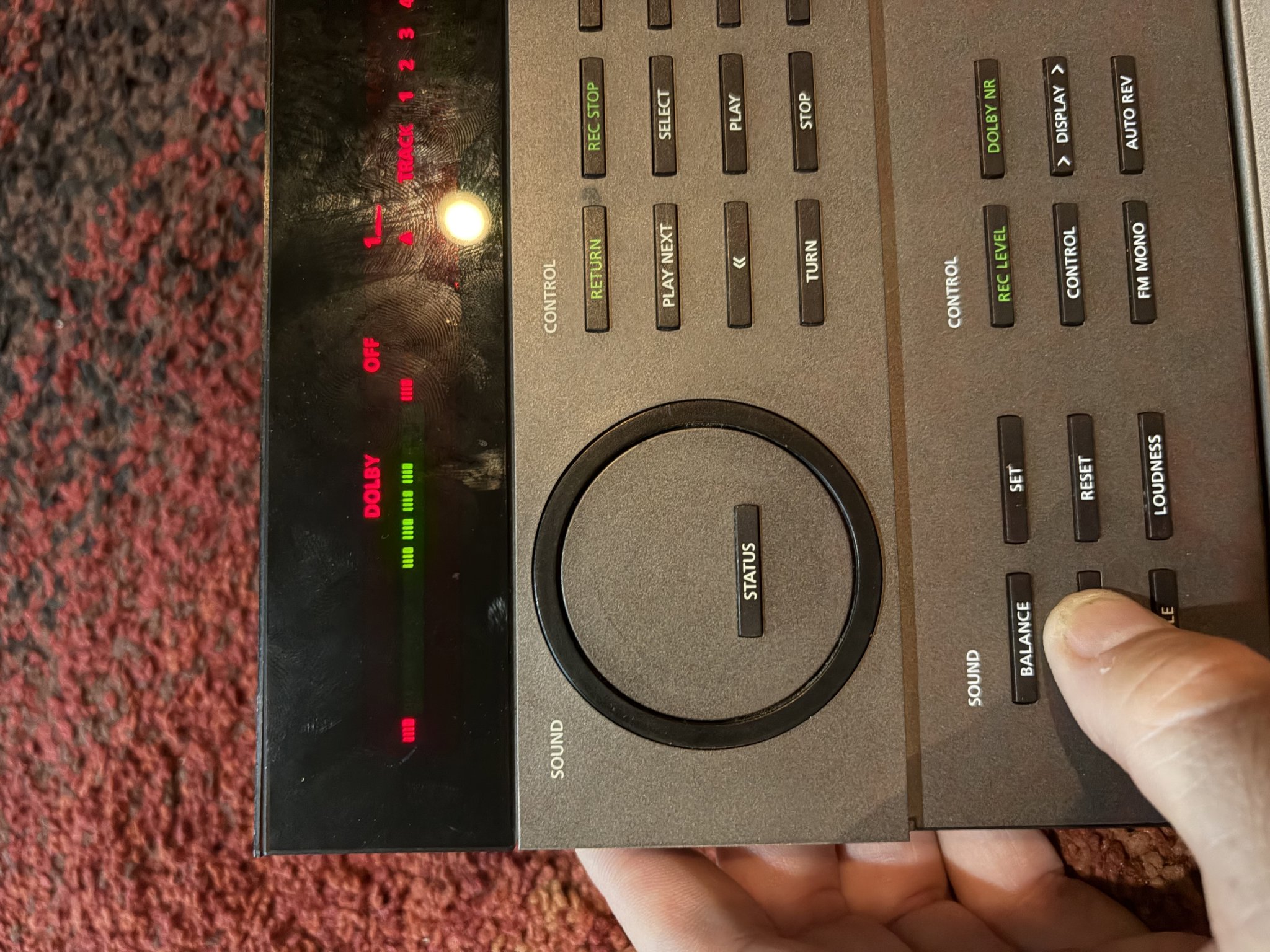

Do the two red LEDs on the volume bar light up when you turn the knob, and you just don't see any green volume level indicators?  Or do you truly see nothing at all - including the two red LEDs - when you turn the volume knob. What if you play a tape, and hit the FF button - do you see the lights strobe in one direction? What if you try to set the bass level - anything light up then? The volume knob has two inputs, as you have discovered.  The micro switch's role is to simply let the processor know that the knob is being turned, and which way it's turning.  This alone would trigger the two red LEDs.  The green LEDs signifying level are controlled by the optic sensor. If the LEDs dont illuminate when you hit FF (or bass or status), then Id venture to say that your issue does not lie with the wheel sensors, but elsewhere in the circuitry. If they otherwise light up given the inputs above, but you are not even getting any red LEDs when you turn the knob, I'd take that to mean that the CPU is for some reason not being told that the knob is turning via the microswitch, and then you would likely not get any green level LEDs displayed anyways. The microswitch basically facilitates a pull-down of the pin to ground, and that is fed directly into the CPU, so if it has continuity then there's not a whole lot that can go wrong, apart from the possibility that its not grounded properly. If the two red LEDs do illuminate, but you are not able to adjust the level, then that point to the opticoupler circuit,which contains a few transistors and an opamp in addition to the opticoupler, which can also be a possible failure piont..
Turning the wheel has no impact on the display.  No red volume lights appear nor does any green light appear, absolutely nothing happens. Using the MCP, if I press FF the green “moving” light (indicating the tape is being fast forwarded) shows up on the MCP display. If I adjust the bass, the MCP display first shows red lights at the far end of the left and right sides (of the adjustment spectrum) with a single green dot in the middle. This quickly goes away and then the display shows the bass level. Do these symptoms possibly point toward a faulty opto coupler?   BTW - thank you for the very detailed explanation!
