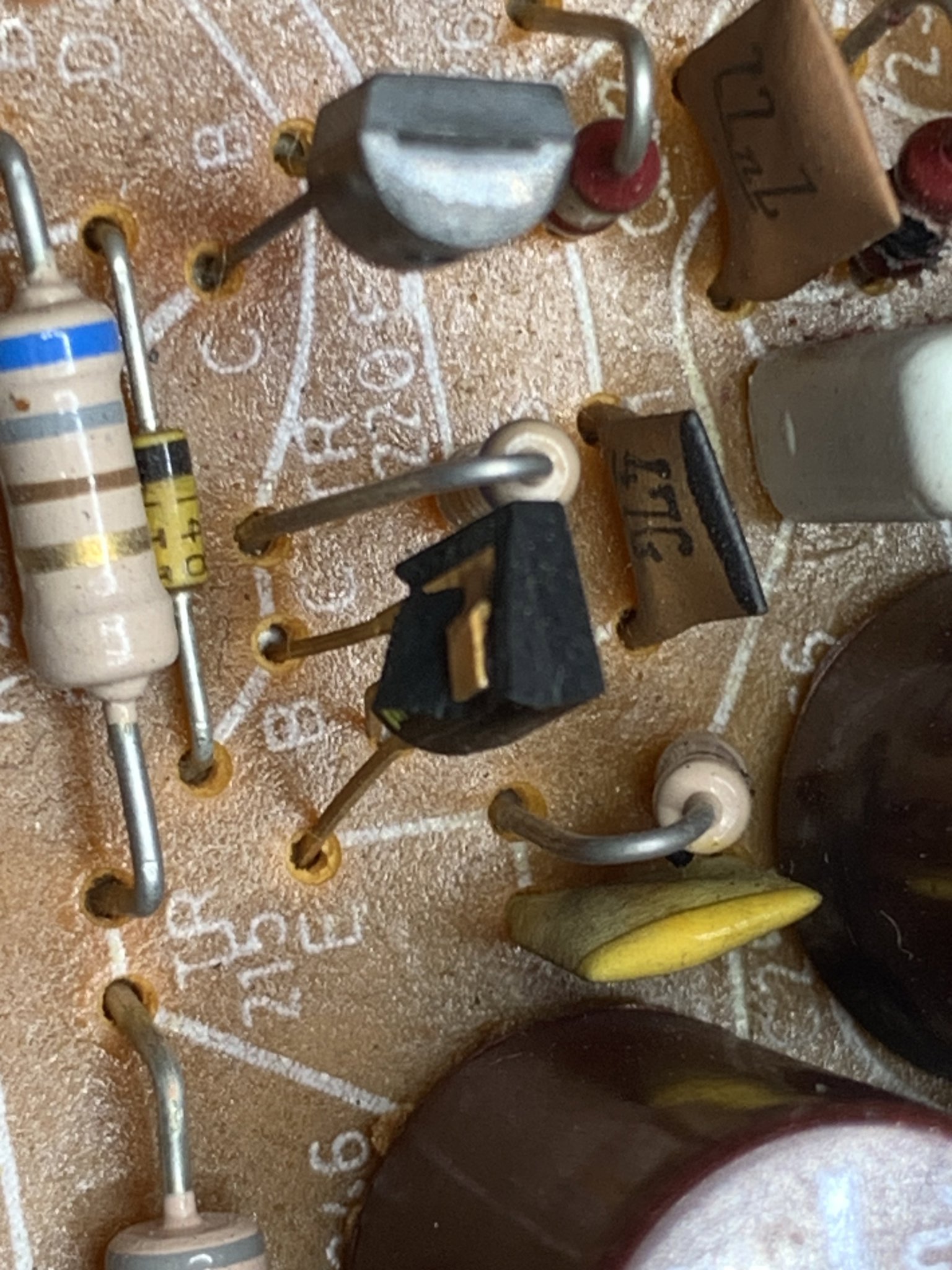

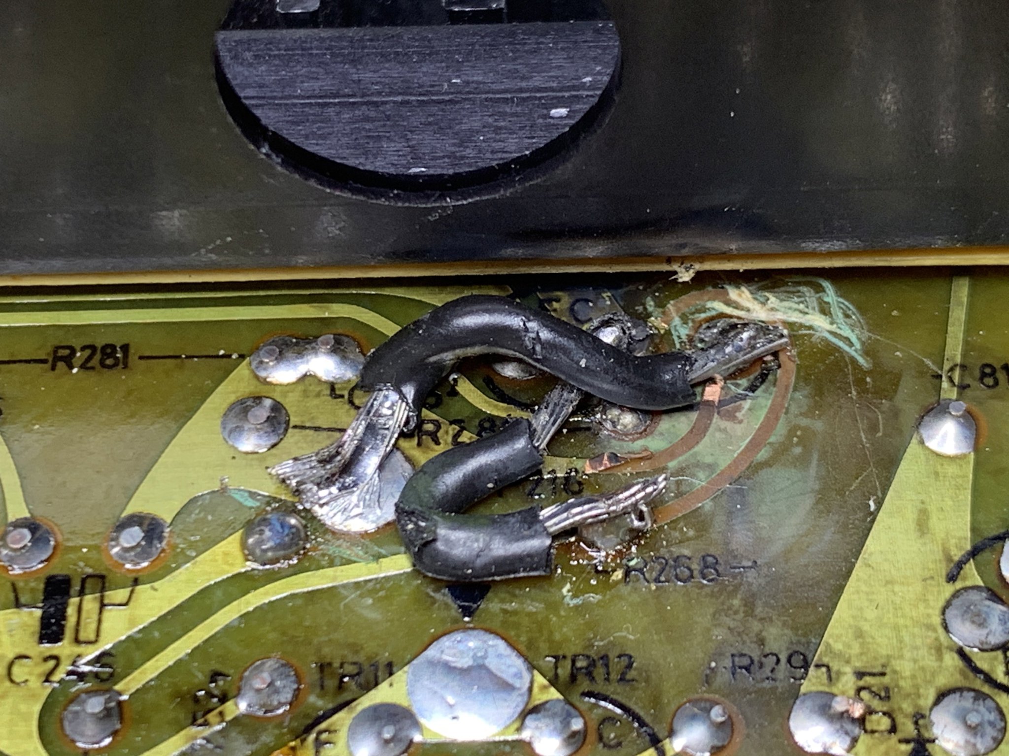

Without want to seem smug, here are some photos of the repair that someone had attempted and one of the many transistors that had failed, presumably subsequently.
It's tricky...
