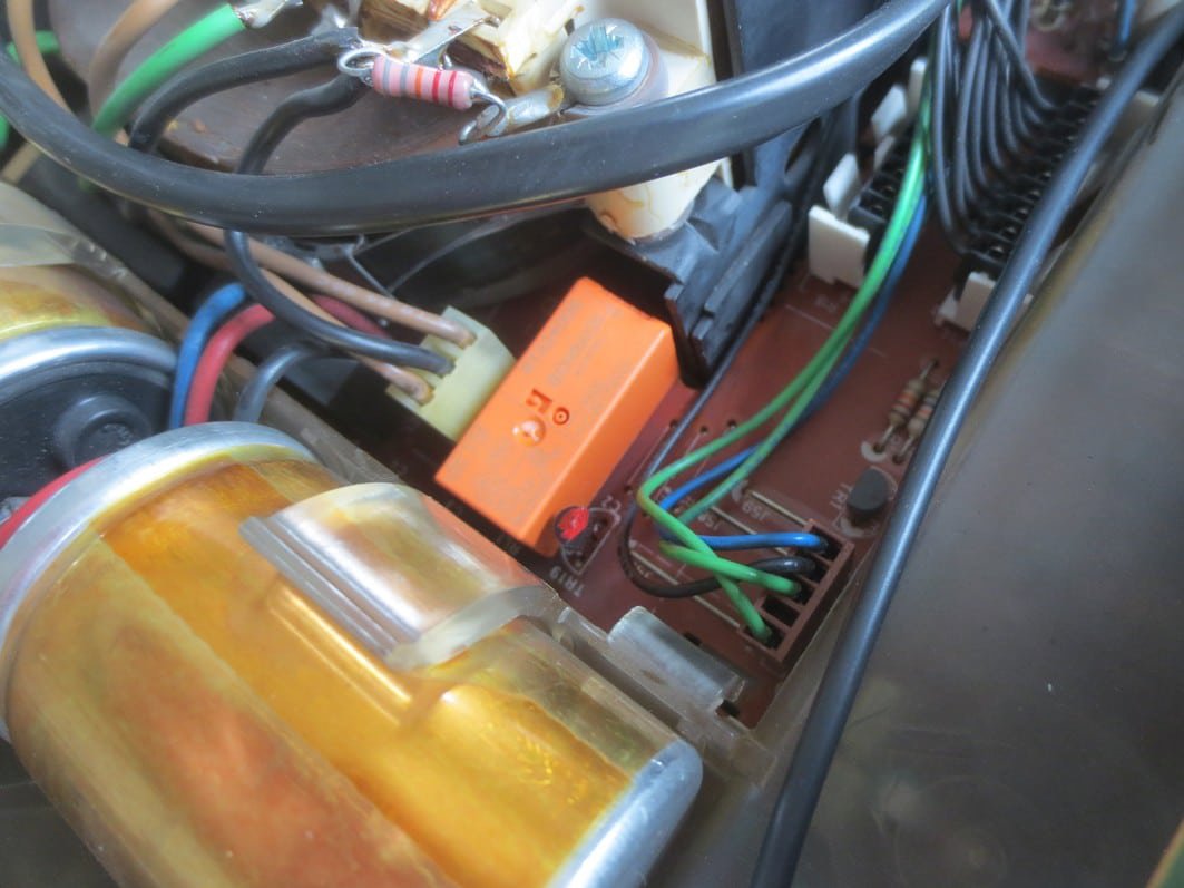

I am looking for the specs of the replacement relays you can put into this beomaster .   i know the original is a pASi KS/r-1-c  6v  but thats it .   Is there a direkt drop in ??

dk is modify-ing the relay ( most likely cutting of 2 legs ) , i only need to know what type / brand of relay they are selling
In that case I don't have the answer.  I suppose that research into the relay type is part of what you are paying for when buying parts from Danish Sound Parts - to my mind it is worth paying a little extra for the peace of mind of a known compatible part. One of the older archived threads may have the answer, or perhaps remove the relay and take to an electronics store and ask for an equivalent.

Guy , Thanks for your answers !!   as there is no info avalable on the pASi relays anymore and the website of the new owner has no technical data ,   I will need to do a reverse search.
Schrack RT424006 does a good job
