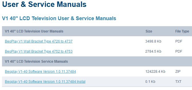

/api/files/2fa3cb186c714f94b2764ea490e616da Found here:
I'm new to this forum and I’m hoping someone still has this sw update available. Saw a link on old forum, but the link doesn’t work I own a BeoPlay V1 -40 with old SW. As some others described as well I'm not able to update neither SW nor PUC list via WiFi or ethernet.   This is why I'm desperately looking for the last SW Version to download and update via USB. The version I'm looking for is this one from 2016: 1.0.11.37484 Does anyone of you still have that version somewhere on an old PC/Mac or so and can share it with me? Thanks a lot!
