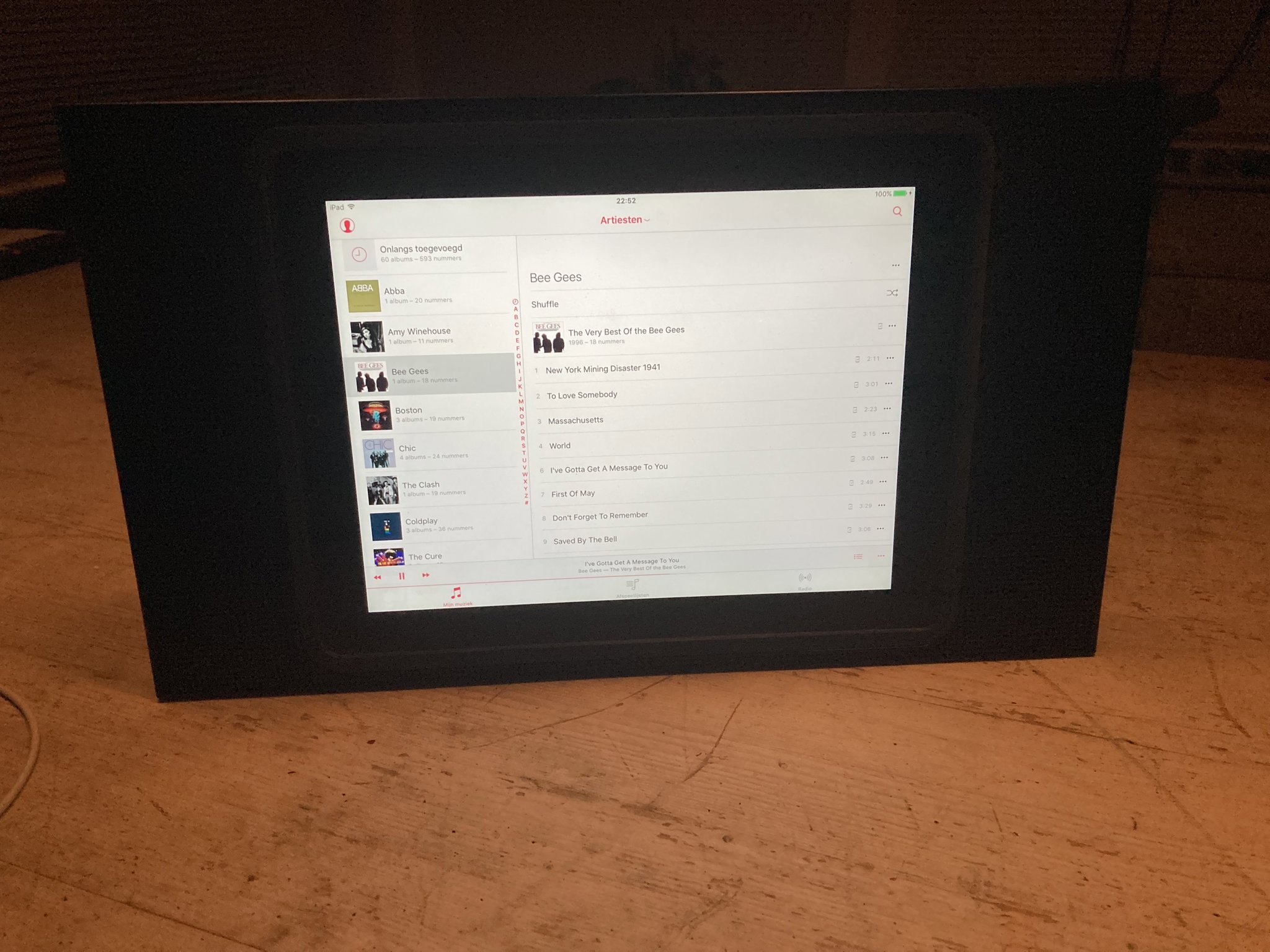

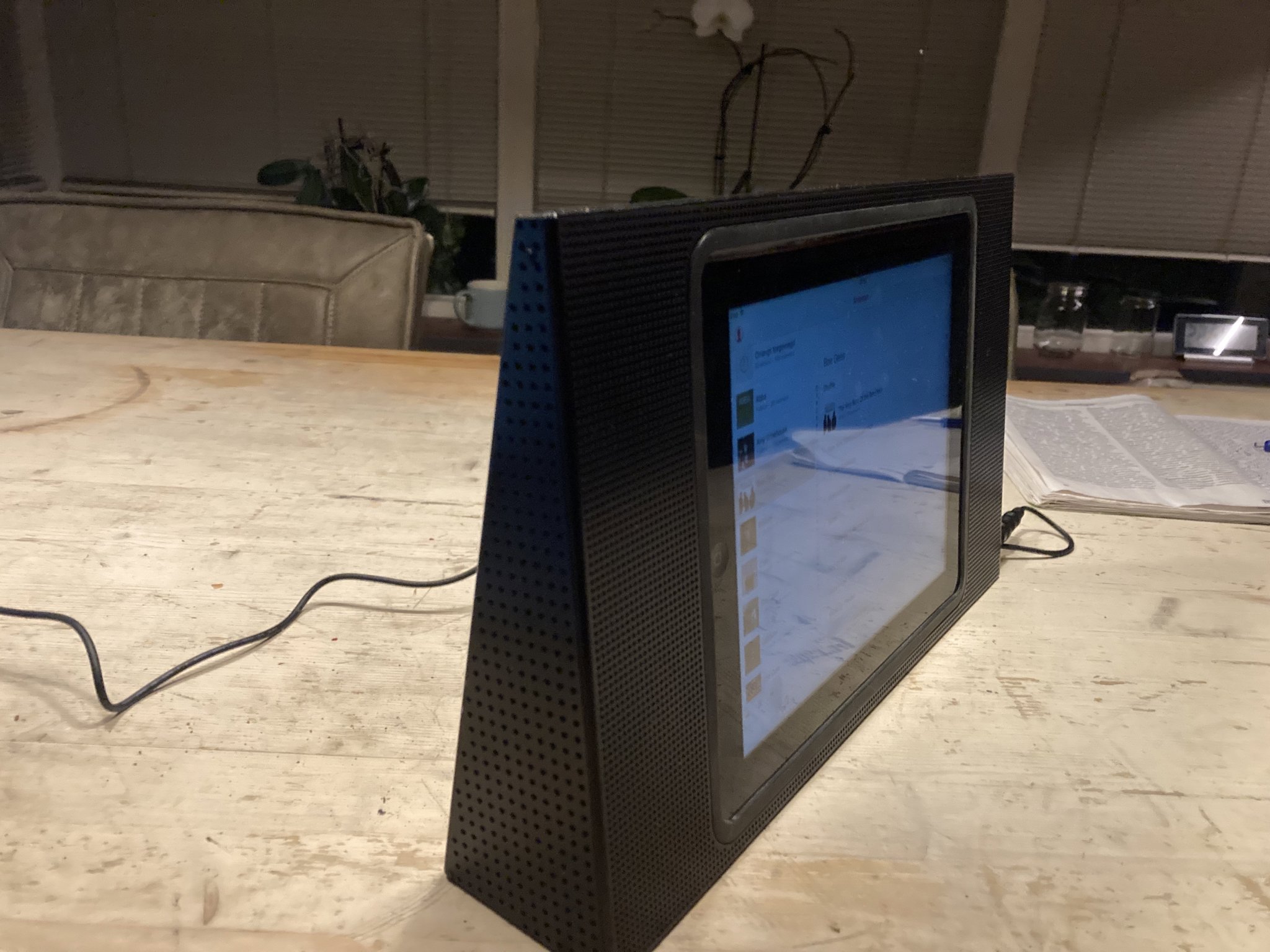

By the way, you can't use the original Beoplay A3 gasket anymore: the modern iPad is not wide enough to fill it in. Here is a photo showing an interesting conundrum: if you can tolerate the following, you can side-step the entire velcro/double-sided tape process!  In that case, this becomes a 10 minute project: just Dremel and paint. Look: per pure coincidence, the height of the A1468 adapter is such that, when fully inserted into the dock connector's cavity (post-Dremel widening), the iPad just happens to exactly catch on the A3' original gasket-retaining slots!  Like in this picture: The iPad 6 is inserted, the A3 is fully functional as designed, and the iPad 6 is 100% secure: it absolutely will not fall from the A3 even if inverted.  It is being held by the A3 factory slots designed to retain the old gasket, except the slots are now retaining the glass/aluminum directly.  The iPad also sits perfectly symmetrical and even in the other dimensions. You could use your A3/iPad like this forever. The "bottom" part of the iPad is held, as per the A3 original design, by the dock connector itself.  The "top", by the slots. I couldn't.  The lack of depth symmetry would drive me up the wall.  I just can't. Since I can't use the slots for holding, my alternative is velcro.  Originally I used two full layers: a fuzzy side on the A3, then a hard side velcroed into it, then a hard side adhered to its back, and then a fuzzy side on the iPad.  Too much!  The iPad, quite secure, stood proud.  The exact opposite problem of the photo above. The solution was the two layers of double sided tape plus the one full velcro layer (hard side adhered to the top tape and fuzzy adhered to the iPad).  The iPad sits slightly proud, but almost unnoticeable.  I can live with it.
