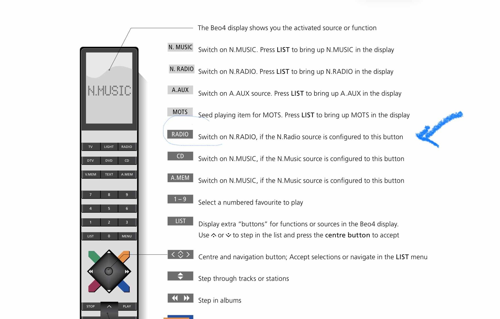

Hi Experts How can I please assign the beo4 radio button to nradio?

Sorry correction the radio function.  Thanks.
There is no way to re-assign the labelled buttons, but in some newer B&O systems it is possible to get the RADIO remote command to start N.RADIO. What B&O equipment are you controlling with your Beo4.

Alternatively you could get an older BL1000 remote with a phono button - the PHONO remote command is the same as N.RADIO. EDIT:  The older AUDIO TERMINAL also has a PHONO button, as does BL5000.

Thanks for the great support. Beosound 5 as a Master and a Beosound 4 and Beolab 2000 where i want to play n.radio
So I assume that the N.RADIO source is the BS5, and that this has been configured in settings so that pressing RADIO selects N.RADIO in this room. Unfortunately that setting does not 'transfer' to the BS4 or the BL2000 - both of these devices expect RADIO to be the FM (or DAB) radio in the BS4. If you take away the BS4 and just have the BL2000 connected to the BS5, does selecting RADIO start N.RADIO?  (But even if this works I assume you want the BS4 also in the system.) I can't think of a way to change the setting in the BS4, but if you want N.RADIO to be available with a single button press then a remote with PHONO could be an option. Unless anyone else has any ideas?

Great thanks! How can i check the BS5, BS4 and BL2000 settings please?
