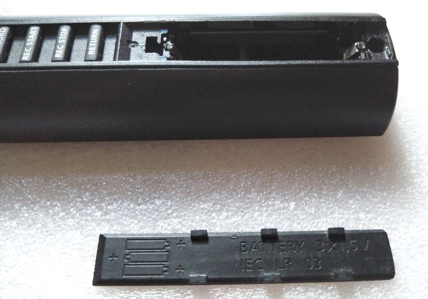

Will seem a silly question, but which way do the batteries go into a Beolink 5000!?  I have got hold of one which is in great cosmetic condition, but not working. The screen has come loose, and the battery cover is missing.  I want to test it to see if there is any function at all but the phone-camera-test is not showing any blink from the IR blaster. I'm assuming I have the batteries in the right way (two facing down, then the middle one facing up) but is that right?  I assume the diagram to show how the batteries should be inserted is on the missing battery cover! I have a Beocenter 9500 and have never had a working Beolink 5000 to go with it, so here's hoping.

The diagram is on the cover, but there should also be - + - on the remote's frame (perhaps it is not on all versions):
Thank you - I did have them in the right way after all then.  It's not working, so I'll have to have a more detailed look at it.

Two facing down, middle facing up is correct.  The battery cover slides on downwards, and is removed upwards - some people get this wrong. I just checked my 'remote spares' box and have a spare BL5000 battery cover - top left tab (lausvi's photo) only has broken off but it should still work.  PM me your address and I'll stick it in the post.

Hi All, I've been renovating +25 BL5K and my experience with the batteries is to use rechargeable batteries like the Ikea LADDA as they have a larger minus contact pad than normal batteries. /steffen
