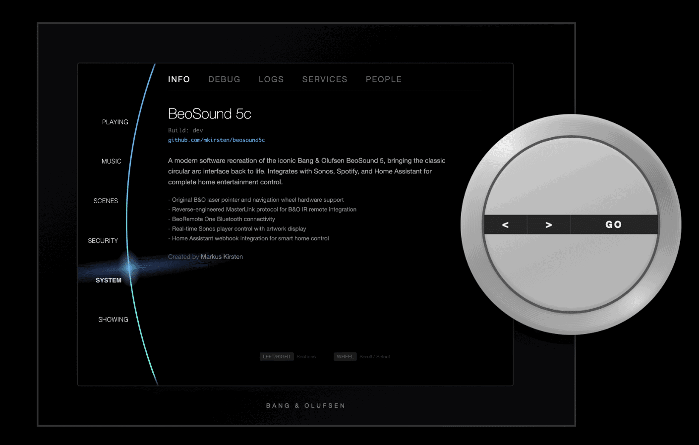

I've always loved the BeoSound 5 interface, but the software felt increasingly dated — with notably no relevant streaming support and limited integration with newer devices. I wanted to see if I could modernize it while keeping everything that made it special. I ended up replacing some of the BeoMaster 5 internals. The screen, wheel, laser pointer, buttons, and IR receiver all work with the new software. The interesting discovery: the daughterboard in the BeoMaster 5 is basically a modified Beolink PC2. What it does now: - Plays music through Spotify and Sonos, with album artwork on the BeoSound 5 screen - Browse playlists with the original arc navigation and aluminum wheel - Controls scenes and devices in Home Assistant — lights, cameras, door locks. The device can also run Home Assistant if you're not already using it - Shows camera feeds as overlays (e.g., doorbell rings → see who's there, open the door from the screen) - All B&O IR remotes work through the original hardware — tested with Beo4, BeoRemote One, Beolink 1000, BeoTime, and others - BeoRemote One Bluetooth also supported. I really like this one. I now have a BeoRemote Bluetooth controlling my Samsung Frame TV It's a passion project, fairly tailored to my own setup with Sonos and Home Assistant, and definitely not plug-and-play. But I've documented the build, open-sourced the code, and put together a website with hardware instructions in case anyone wants to try something similar with theirs. Apart from parts you can source from your favourite store, it's completely free to use. Website: https://beosound5c.com Would love to hear from others — there's probably a lot I've missed. Happy to answer any questions or take feature requests here

Very impressive project, look very interesting. If I understand it correctly the Beosound 5C will works as a controller for Sonos devices?  That could be very useful for me as I have Sonos devices in the house, but am missing an alternative to a phone/tablet for controlling the Sonos devices. If it also works with the Beo4 remote control to play/pause, skip tracks and change volume for the Sonos devices that is even better :-) Is it correct to assume that this will also work with the Beoport if the display is powered separately and the IR is connected to the Beoports IR in port?

It can control Sonos, or something else as a player through Home Assistant (or other home control system of your liking). I have set it up so Sonos control goes through HA, but will add an option to control Sonos without HA also. This will both have one less requirement, and on the margin a little bit lower latency. It does work perfectly with a Beo4 yes, and also with bluetooth remote if you prefer. With regards to Beoport; if your question is if you have all functionality without a BeoMaster 5, as long as you have a Beoport and a power supply for the BeoSound 5, then it is correct yes. You would then have the BeoSound5(c) working without IR, and you would have IR to the Beoport.

Very much looking forward to trying this out.  Any thoughts on the required pre-condition of the BM5?  For example, are you required to start with a known good HDD image, or is that no longer needed? I don't have any of the hardware at present. I recall some threads at an earlier date that there were some issues with some of the computer components used in the Beomaster 5. You mention that not all of the hardware in the original box is used, so I've not researched your project enough to see if some of the components that typically tended to fail is in the list of removed pieces.
It works without a BM5 too if you want actually. There’s three parts that makes sense reusing from the BM5, but it is flexible
  • Power supply. Without this you need a stable 12V supply and set up the right cable to the BS5 (so it’s easier to just reuse it from the BM5)
  • Daughtercard (that sits on top inside the BM5). Without this IR won’t work. I’m not using MasterLink myself, but that would be possible to make work
  • The box. To keep it tidy
General failures on the BS5/BM5 has been, to the best of my knowledge the HDDs and the motherboard. None of which that are reused. So hopefully this can revive a few dead units.
