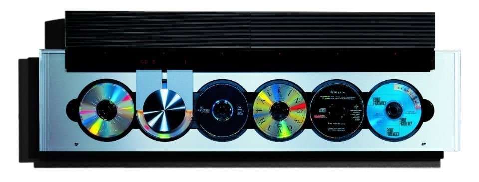

Hi Mike, thanks lot for your quick response, I will explain more in details BS details: Type 2572 SN: 20514917 probably Mk3 a. I had connected BS9000 & BL8000, BS has loaded 6nos cd's. turned on power both had in standby mode. Now I pressed beo4 "GO" button BS & BL wakeup BL turned on green LED and BS cd start reading track I can see track 1 appear, there is no sound in speakers, BS keyboard I pressed OK button (of CD) display indicating counting example 00.45 still no sound in speakers! After few seconds later I heard sound in speakers! After that everything normal continued playing cd's without any issues b. Turned on power BS in standby mode, I had connected headphone in BS and now I pressed GO button in beo4 BS wakeup cd starts spinning track no appeared 1 counting started no sound sometime even 3min no sounds, then suddenly heard sounds! c. Turned on power BS in standby mode, I had connected coaxial cable to digital out to headphone amp digital in (coaxial cable) turned on headphone amp power, now I pressed GO button beo4 BS wakeup cd starts pinning tacks number 1 appear, I heard immediately sound after cd start spinning. I believe digital signal came from directly from the CD transport without amplifiers, I was suspect probable causes is CD transport or amplifiers, as per testing c. result overruled CD transport no issues! As per BS9000 service manual troubleshooting guide page 86 defective PCB 32 In/out select, may be having dry soldering in PCB 32? Please let me know your suggestion. Rajkumar

Seems no one help from this forum?! However, I had solved problems myself, I would like to update this thread will help someone. Symptoms:
  1. During CD play sound came out L&R speakers delayed 1 to 3 min (headphone as well same) at the same time digital out can heard sound immediately once CD started readings.
  2. During playing CD intermittently sounds distorted.
I had suspected PCB32 Input & output select, and sound adjust - IC 2 (shift & store register) HEF4094BT this IC control PL mutes. I have found in my local market D4094B (Chinese?) replaced, then I have more problems, now sounds distorted, intermittent no sounds in CD, FM & Aux in sound. I have ordered HEF4094BT (original) from element 14m and removed D4094B and replaced HEF4094BT, also replace 5nos SMD aluminum electrolytic caps 4.7uf 25V 3nos & 10uf 35V 2nos. My PCB32 different from Mk3 service manuals. As per Mk3 manual PCB32 Rev-N have lot of aluminum electrolytic caps, mine have version Rev- V has 5nos only. Then all problems gone. Rajkumar
