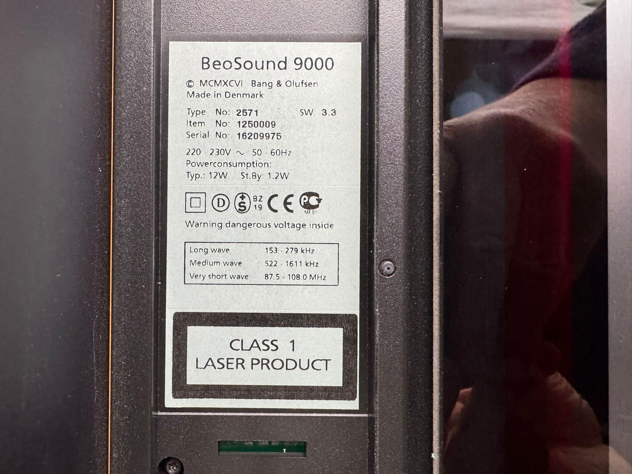

Hello, I am a proud owner of a Beosound 9000 since 2002. It always worked fine, just 6 years ago I had to replace the laser lens. Everything fine till last week, when it started to be in trouble. The problem is that when I switch it ON, it starts playing music for about 20-40 seconds, then silence, despite the CD keep turning. If I switch it OFF, then ON, he is totally mute. If I make a reset, pressing the button OFF+CD6, he starts playing again, but just for 20-40 seconds. The other sources (Radio, N. Radio and N. Music) works perfectly. Does someone know what happened and how to fix the problem? Thanks in advance to whom will reply.

Have you tried the test mode and see what that reports? See e.g., https://archivedforum.beoworld.org/forums/t/24372.aspx" target="_blank">https://archivedforum.beoworld.org/forums/t/24372.aspx">https://archivedforum.beoworld.org/forums/t/24372.aspx

Hello. thank you a lot; I will run the test and I will post the result.

It is sure: the output board is KO; does someone know where can I find a new one?

Does anybody have the electronic diagram of the main board of BEOSOUND 9000  Type no. 2571 (MK3)?
