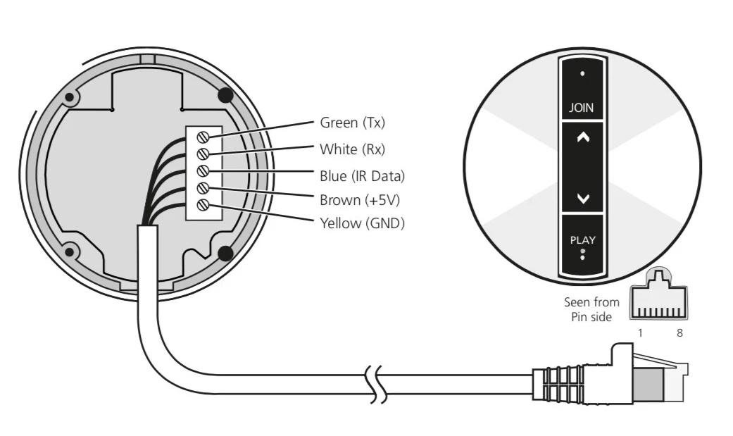

Hello all, How can you assign (older) Beo4 buttons to the sources of a Core Mk2, when using an IR eye? I know how this assigning works with a BLC, but I cannot find such a possibility in the (B&O app) configuration pages of the Core. Or should I first connect the IR eye, for the Core to recognize it and ‘reveal’ the possibility? Can anyone explain how this is done? Regards, Johan

I think I found the answer here: https://support.bang-olufsen.com/hc/en-us/articles/360041742571-How-do-I-activate-sources-using-BeoRemote-One-or-Beo4 A pity, I was hoping for the same flexibility as with a BLC. Regards, Johan

Hi DT79, There was a thread here: https://archivedforum2.beoworld.org/forums/t/43589.aspx stating the MkII has Type no. 3051. Join-Play version (8089119). The port to plug the IR eye in, can only be the DPL port I reckon? Regards, Johan

Hello, can someone from experience tell if the IR eye for the Core provides 2-way IR communication with the BeoRemote One? I expect the Core does this, seeing below chart at 'link sources'. I am curious to know if the IR eye does it too, when the Core is out of IR sight. Thanks, Johan

The use of the Beo4 = ir is very limited compared to the use of a BROne. If you basicly use the Core for Radio or to join in from other sources, it will be fine. Also with Spotify Connect to pause/skip etc and volume it will do the job. Otherweise the BROne is the best choice…or the app. MM
Hello MM, I agree the BeoRemote One is better for operating a Core. And the (standard, no BT) BR1 manual says that linked sources (in ‘my’ case from two BLCs) are visible in the source list of the remote. I am assuming they get there through 2 way IR then. I am seeking confirmation of that working with the Core and an IR eye, as the Core needs to be hidden away. Thanks! Johan

Hi B3OHACK3R, the idea is to hide the Core quite far, maybe 20m. I was hoping that the connected IR eye would allow full BR1 functionality, incl showing specifically named sources from two BLCs. It seems not. The setup will not be very complicated, and perhaps standard Beo4 source names will do (or can be renamed even).
