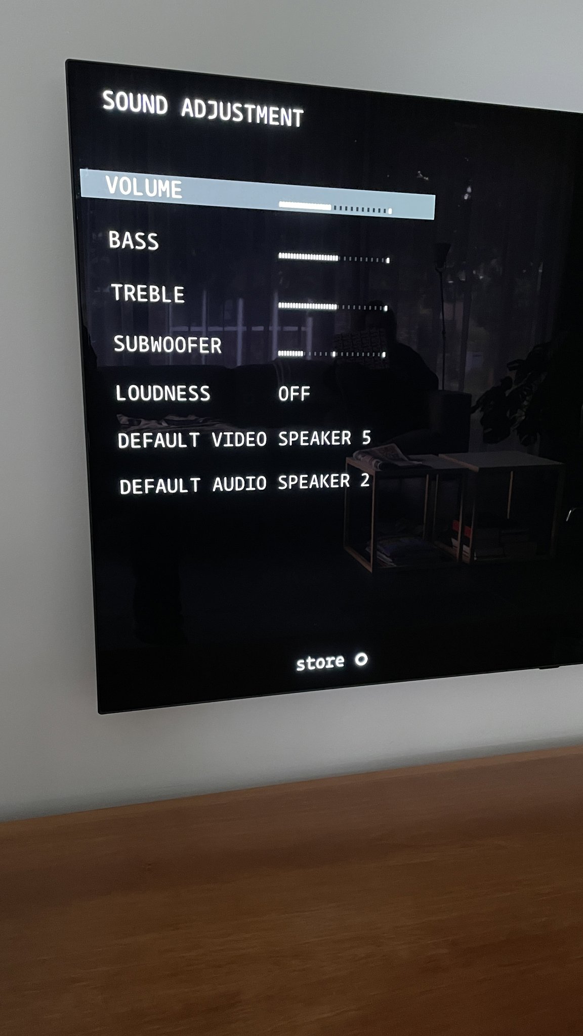

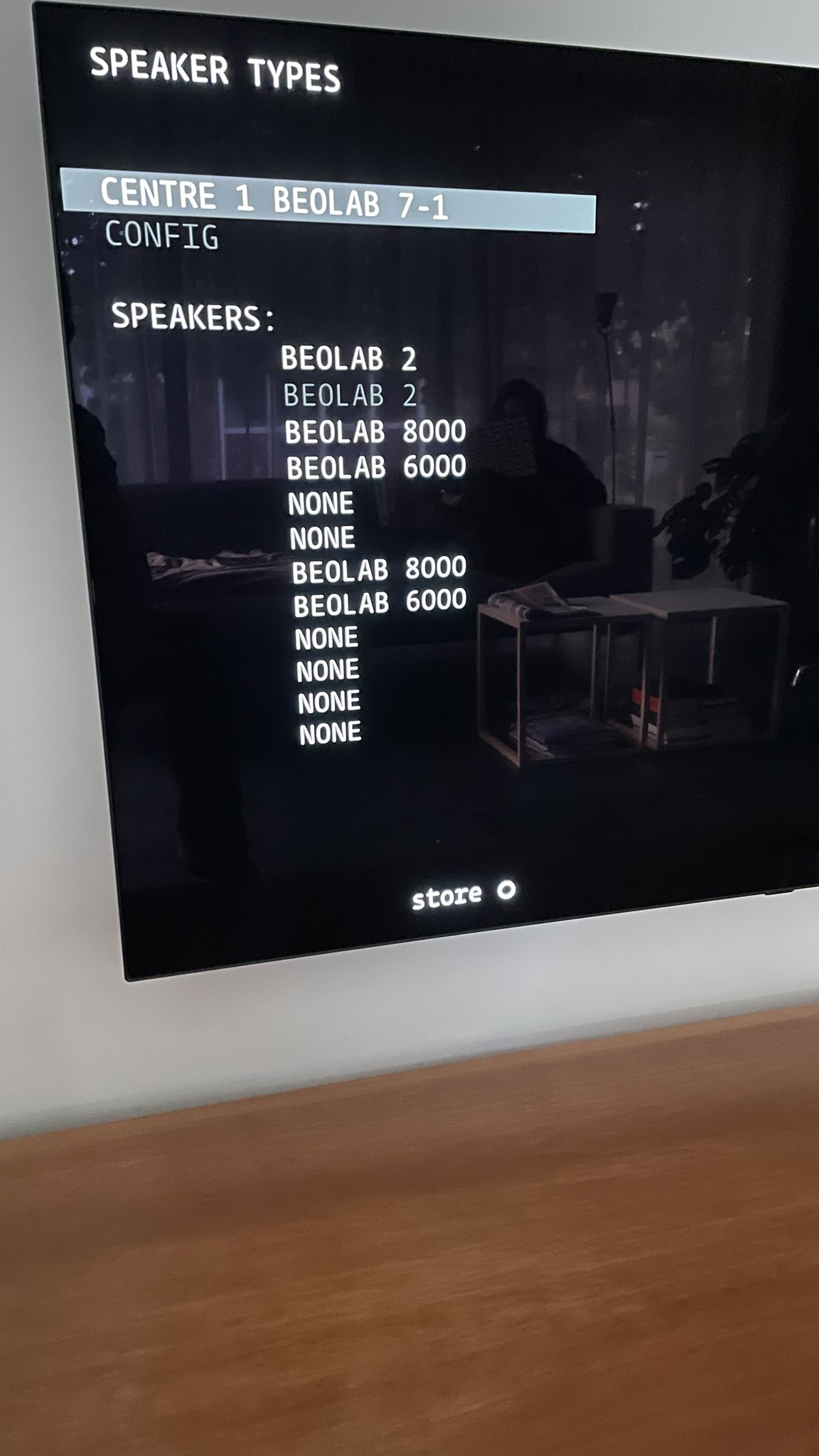

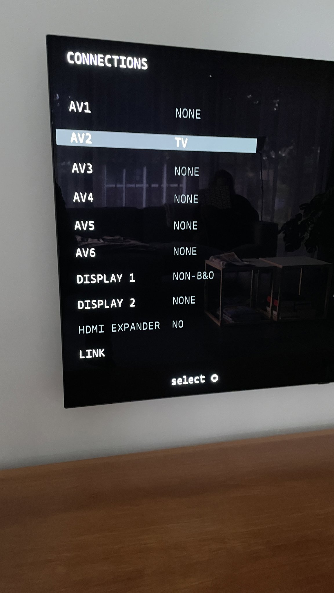

Hi, mine is Mk3. I am using the AV2 S/PDIF sound input on the BS3 (under CONNECTIONS) The sound out setting of the LG is ‘optical out’ and ‘passthrough’ My BS3 is in V.OPT 2 Have you assigned speaker types and roles? (under SOUND SETUP)? And ‘default video speaker’ (under SOUND ADJUSTMENT)? J.

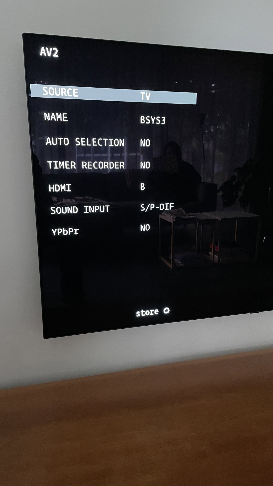

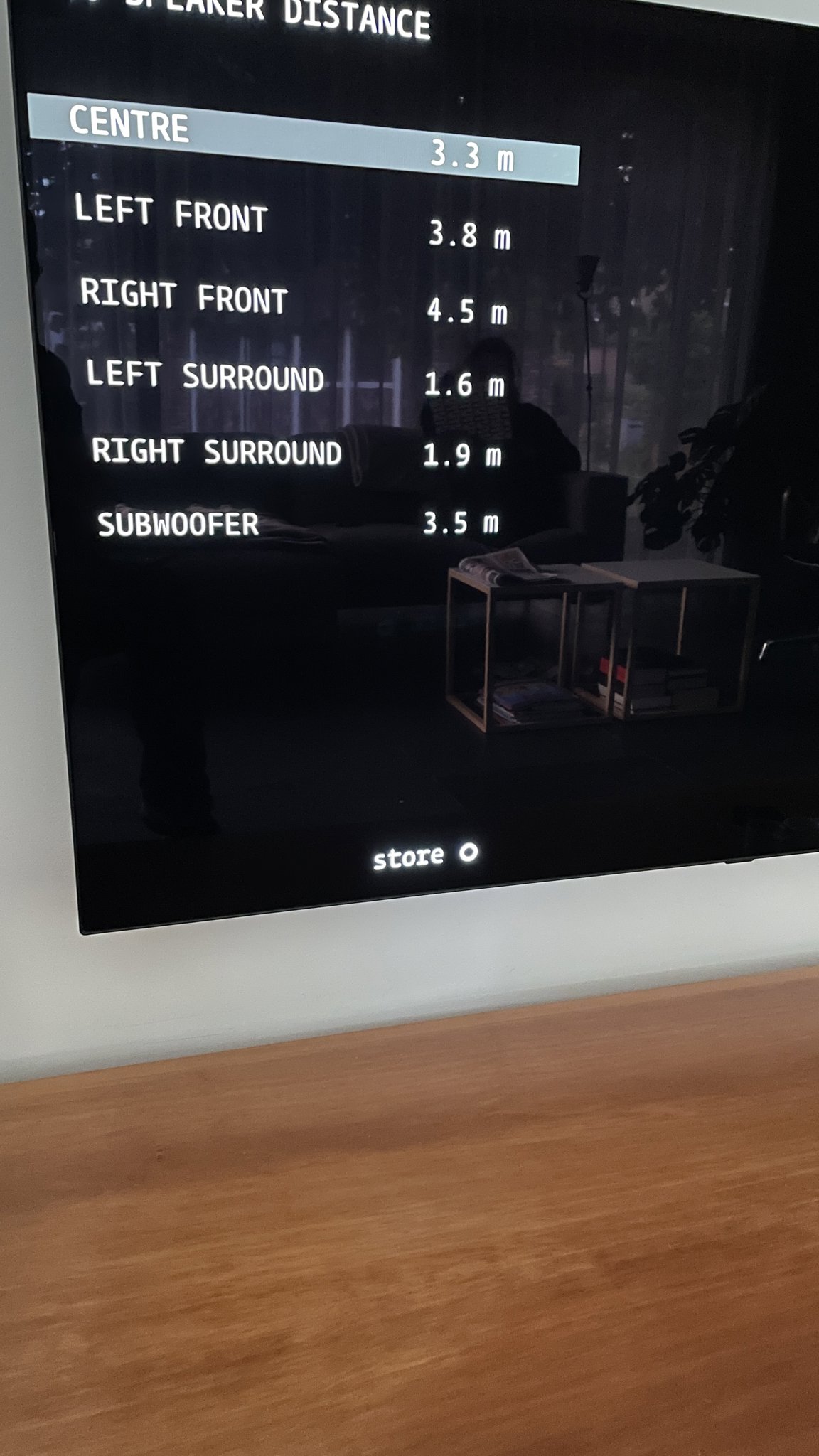

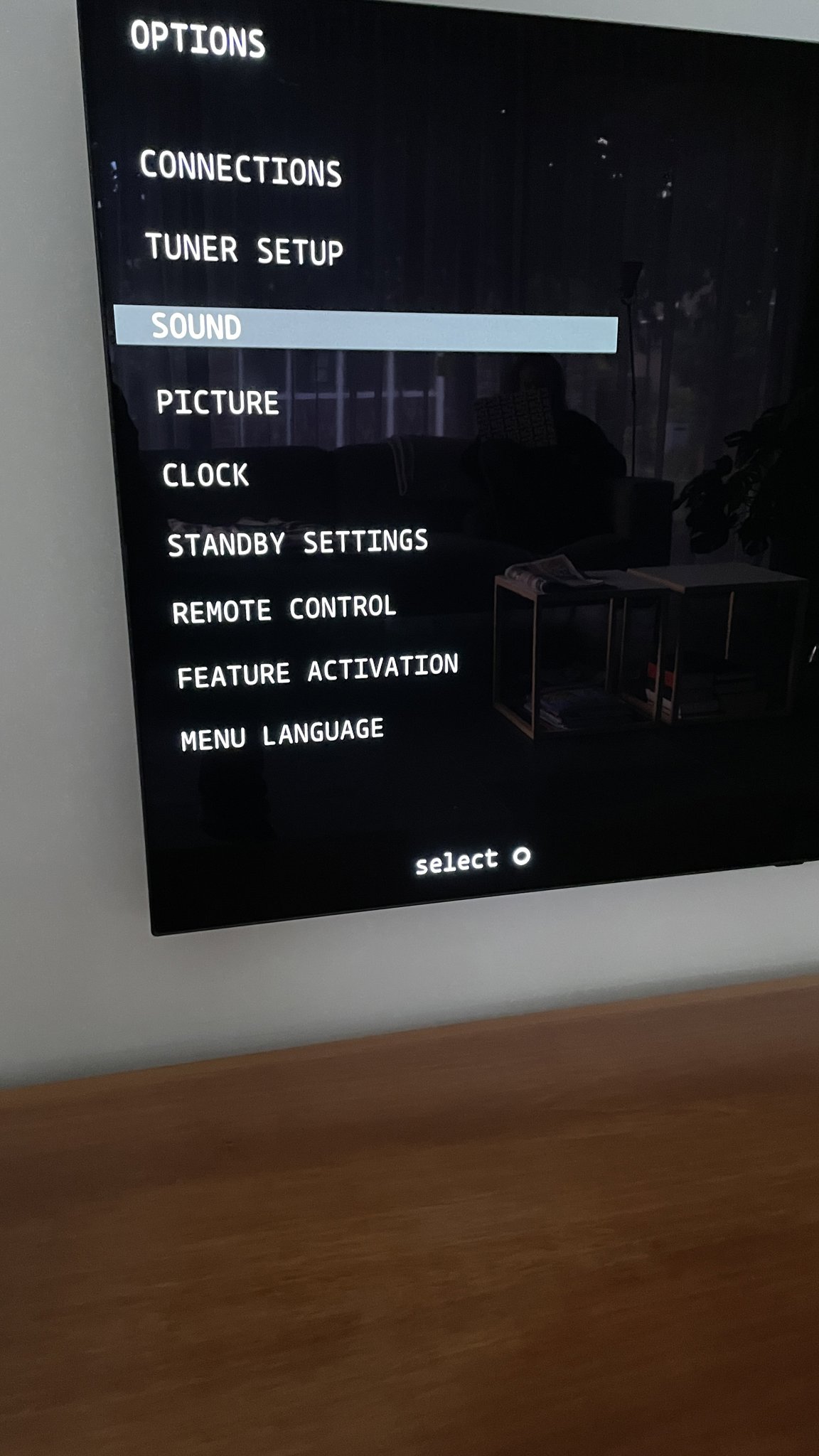

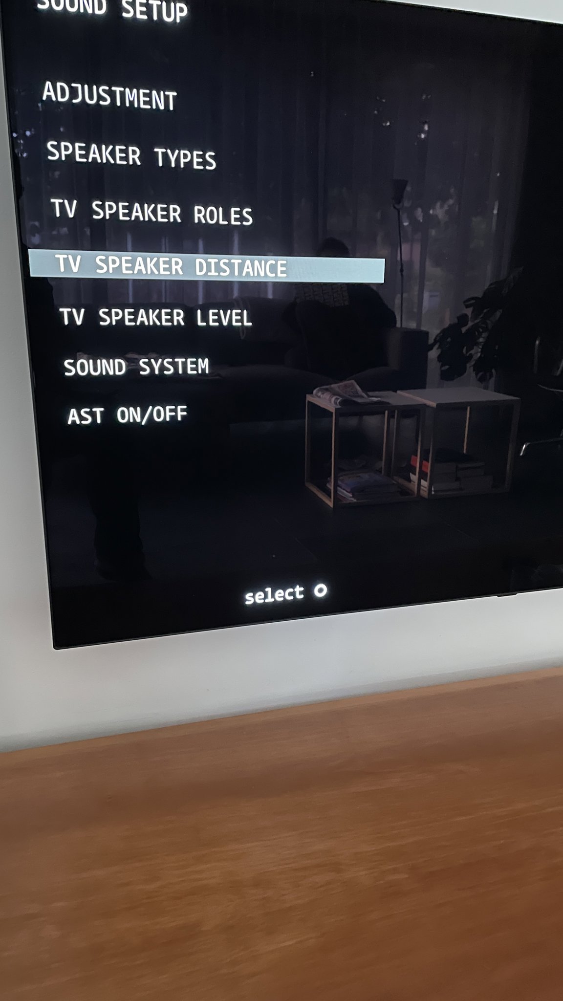

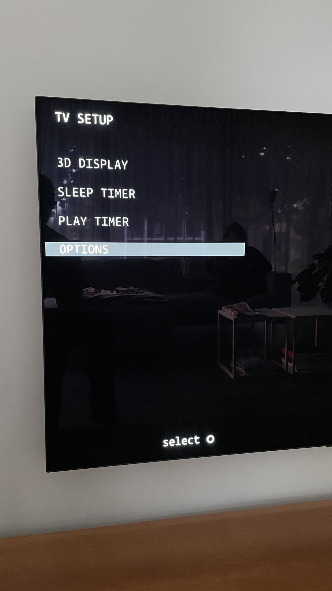

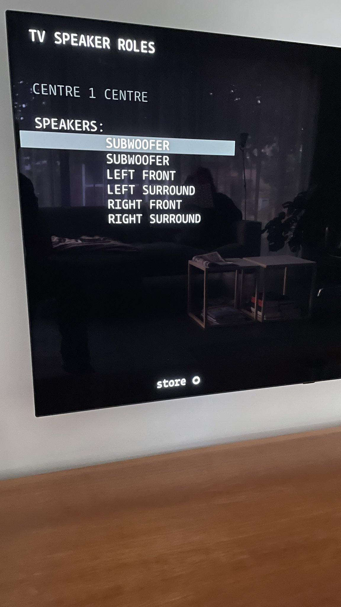

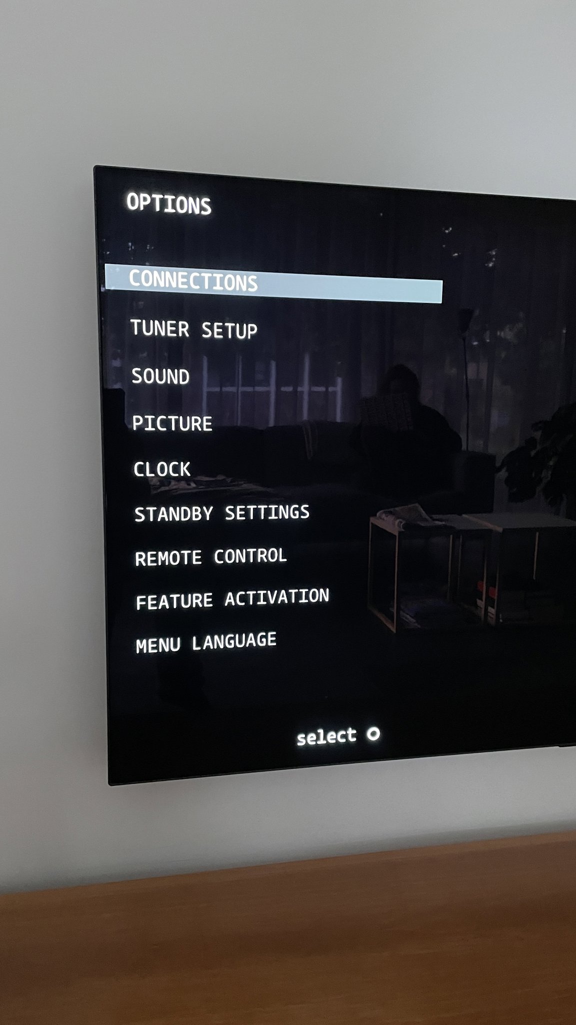

Hi, You must use the input that you have assigned the remote control to. I am not sure if the Mk3 has the same menu as the Mk1. Maybe you can get hold of a reference manual? Below a couple of screenshots of my settings: I assigned the S/PDIF input to the TV command on the remote:

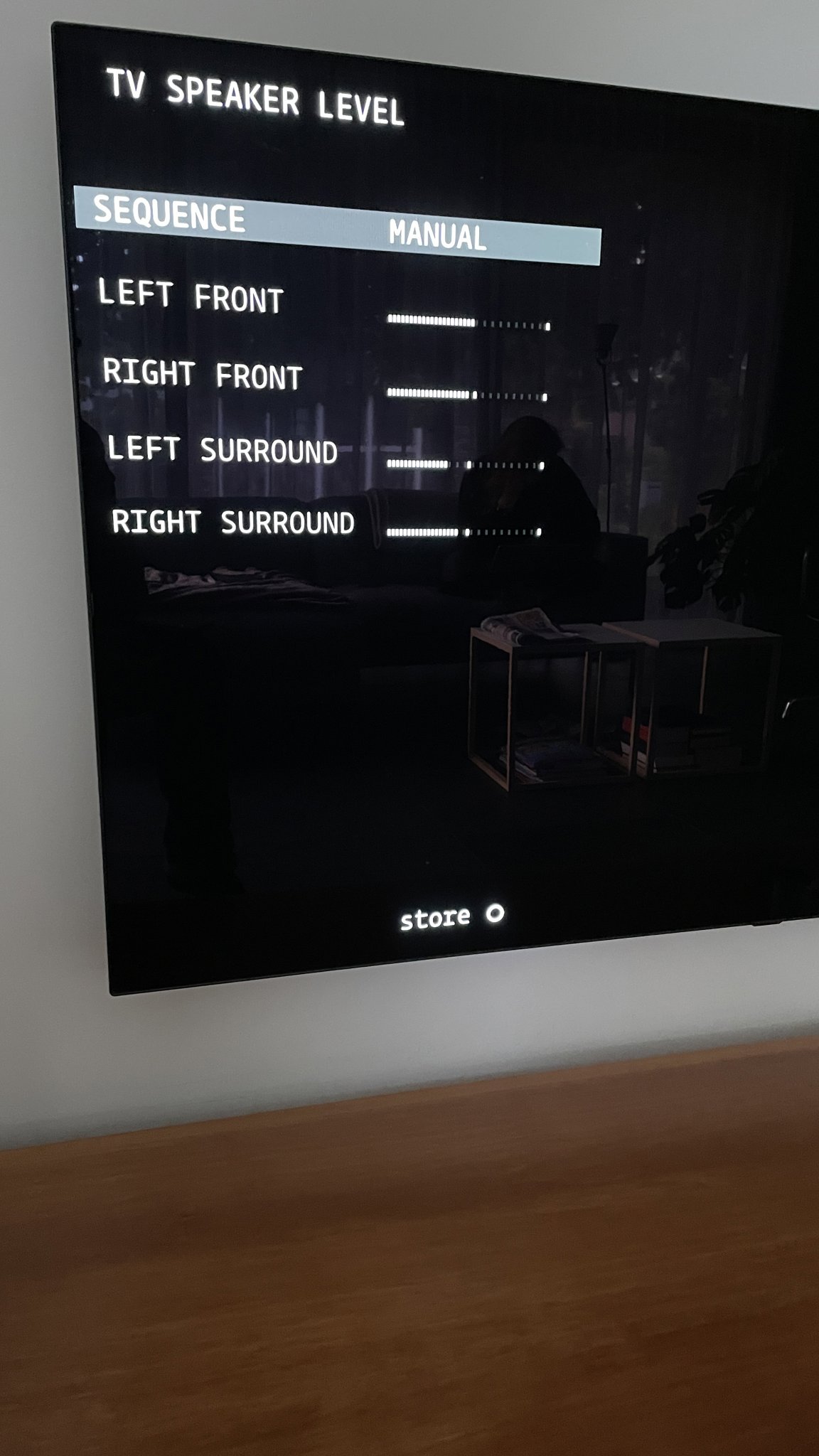

When you set the 'TV SPEAKER LEVEL', do you hear white noise from the speakers? I ask this as you say that they do click. In case the BL8000s are the only speakers you have connected, you might want to try to connect them as centre speakers, use CONFIG to tell the BS3 that they are a pair of 8000s.
