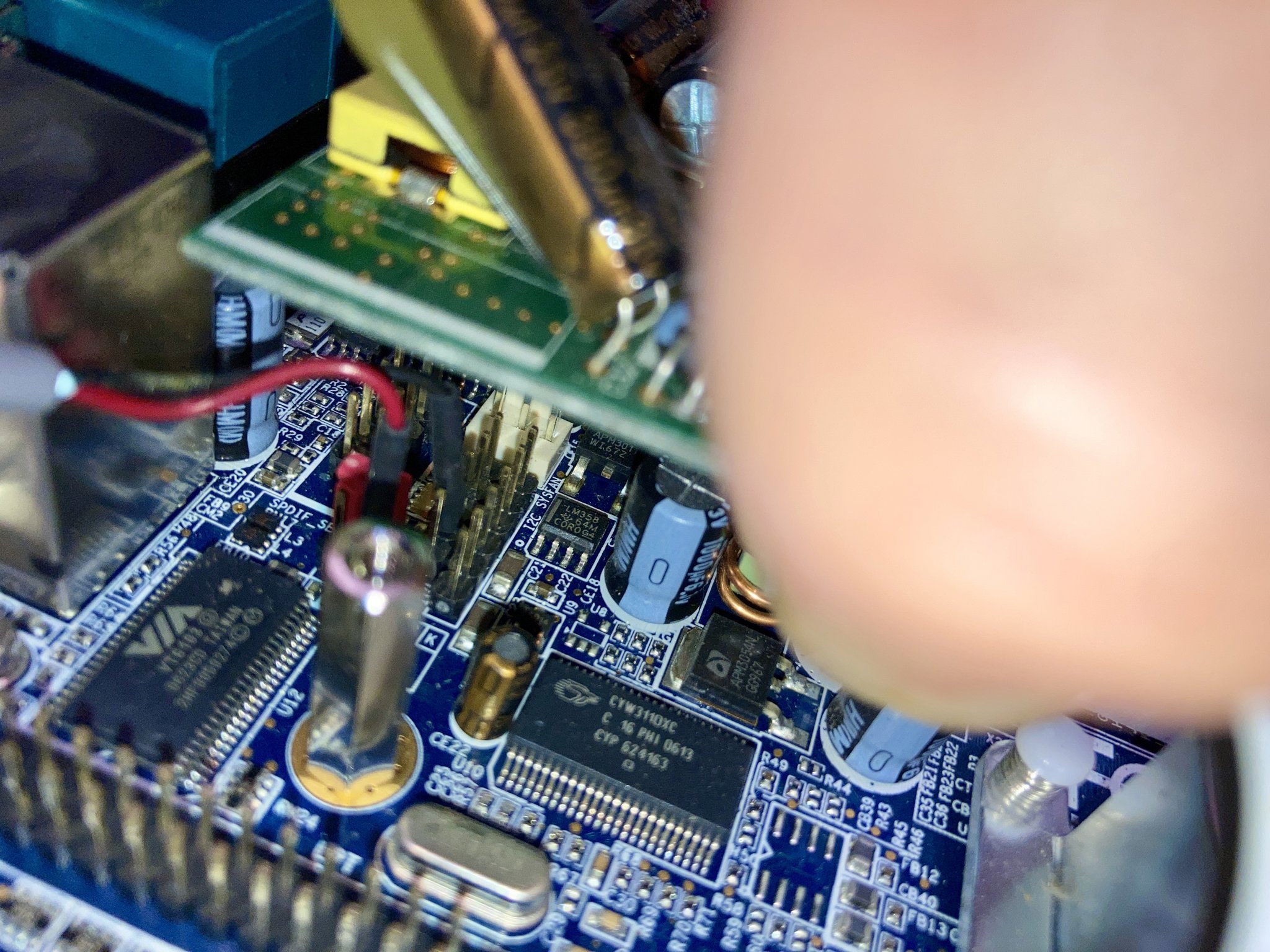

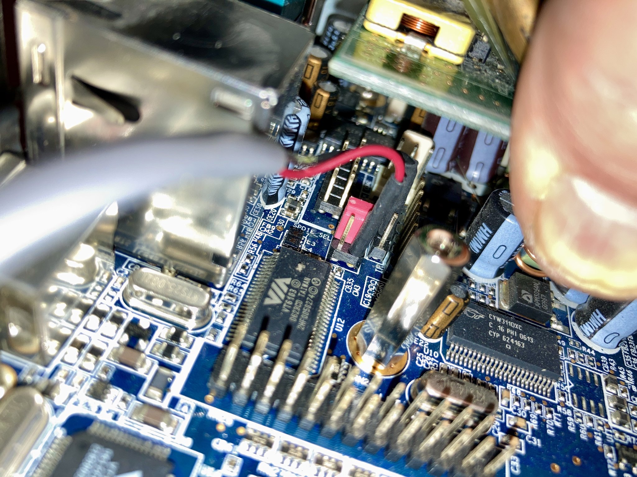

I have no opened up my Beomedia 1. The engieneers that desinged this did not have servicability as the main priority for sure. Man this thing is cramped, and I can,t belive the amount of hot glue used. I have not yet been able to take the power supply of the ATX conencter. Maybe you have a hint for that? But I have taken these pictures for now that might helt you placing the wires

You're right, the B&O engineers did not think to make it easy on us, but your pictures are exactly what I need, so thank you. To get the power supply off you need a very long but narrow flat headed screwdriver to gently push the clip that hold in outwards. You can then gently rock and pull the powersupply off.
