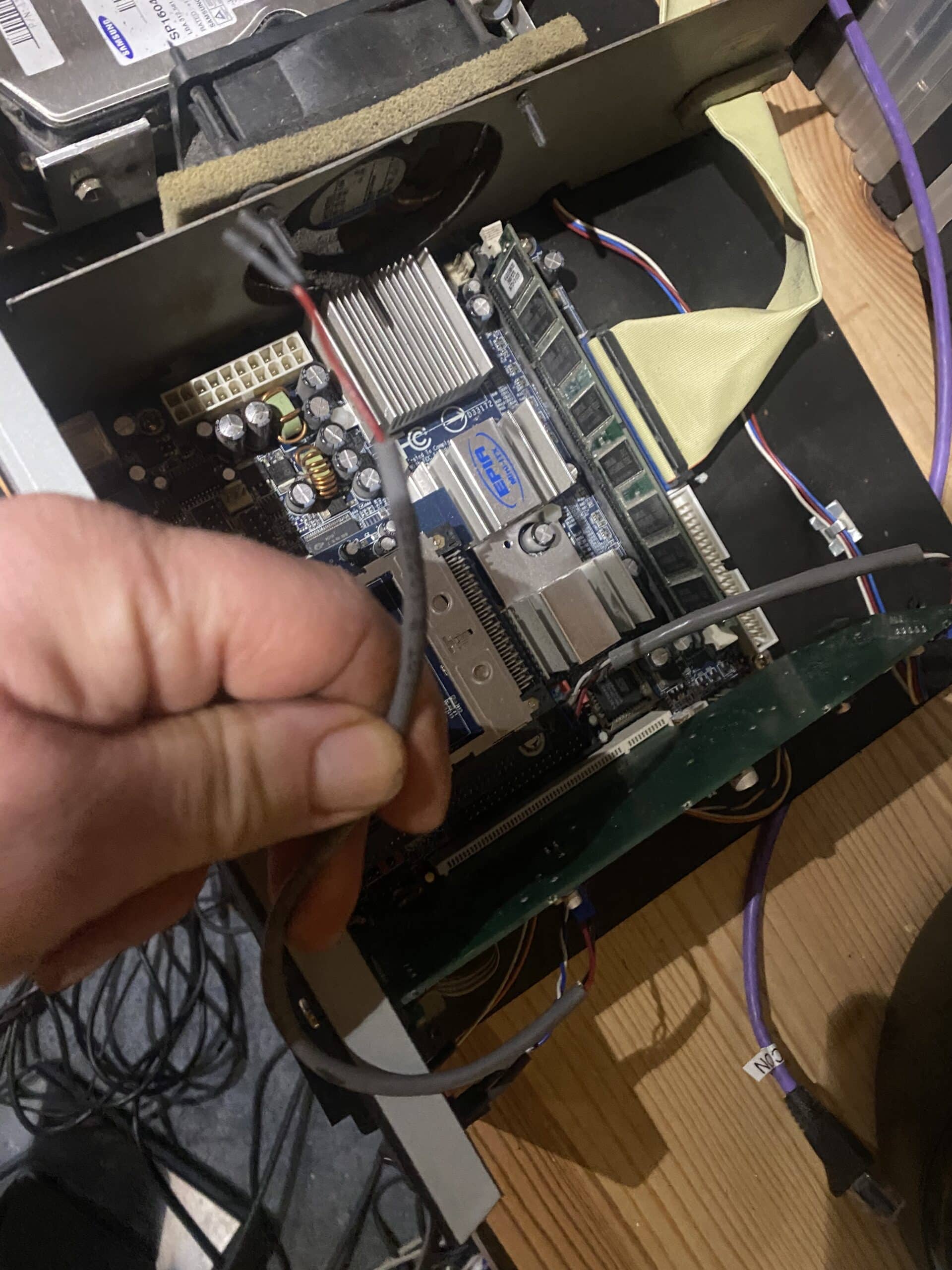

I have no opened up my Beomedia 1. The engieneers that desinged this did not have servicability as the main priority for sure. Man this thing is cramped, and I can,t belive the amount of hot glue used.
I have not yet been able to take the power supply of the ATX conencter. Maybe you have a hint for that?
But I have taken these pictures for now that might helt you placing the wires
Location: Denmark
You're right, the B&O engineers did not think to make it easy on us, but your pictures are exactly what I need, so thank you. To get the power supply off you need a very long but narrow flat headed screwdriver to gently push the clip that hold in outwards. You can then gently rock and pull the powersupply off.

Thanks again. I now have a repaired and working Beomedia. I took a ghost image of the installation and also a copy to another hard disk for back-up, upgraded the RAM to 1GB and put a larger 500gb SATA hard drive inside the unit, using an IDE to SATA converter. If you get Microsoft DART V5 you can create a bootable USB and use Ghost 11.5 to make a copy of the installation. What a week it has been but nice to have it working. If yours is the same main board as mine, look at this manual for power supply options: https://theretroweb.com/motherboard/manual/um-epia-mii-162-63cd39724e43c965057015.pdf
