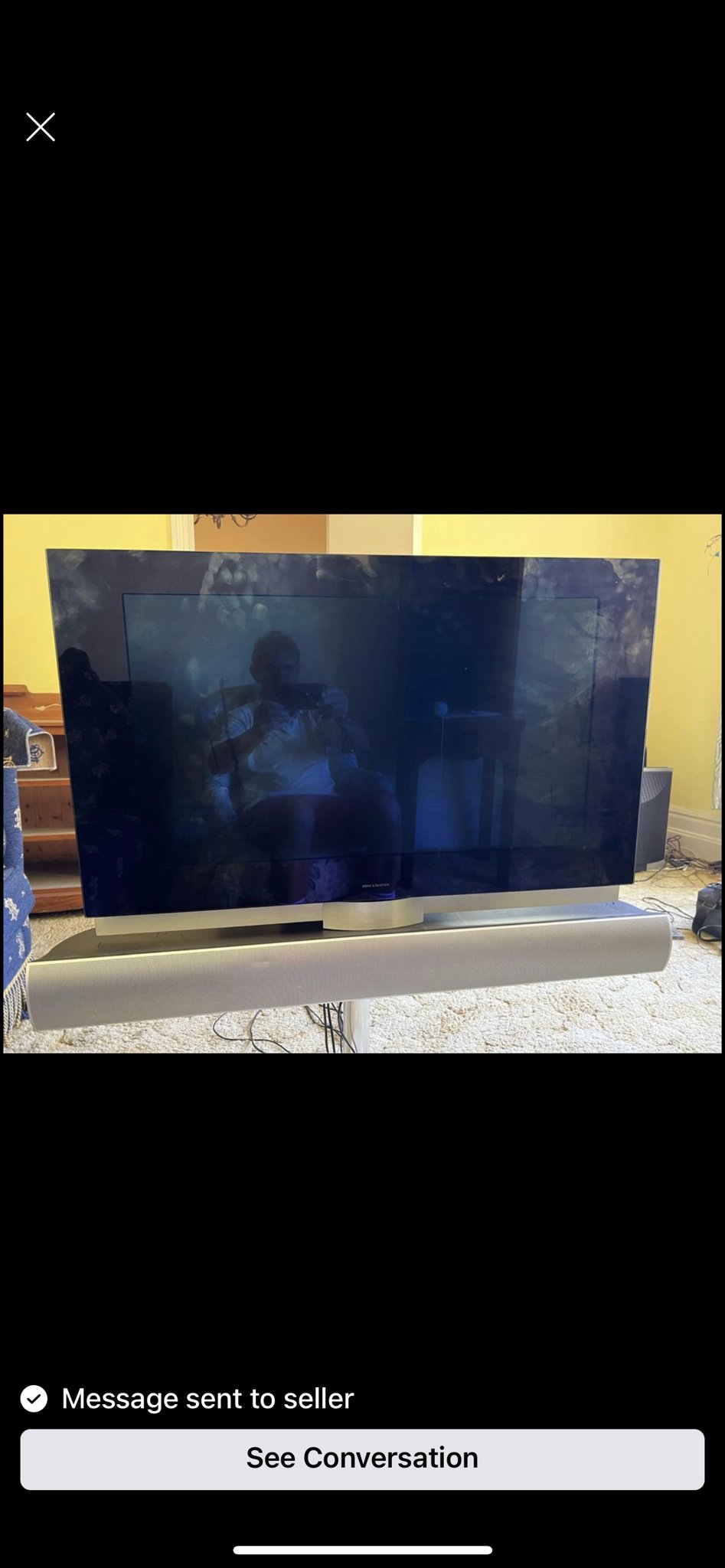

Thank you everyone for your help in setting up my gifted Beovision 7 mk II. Now I have the correct soundbar lead I am using it for DVDS and CDs and the sound is absolutely superb! (Sorry, neighbours) My latest dilemma. I don't have an exterior aerial connection so bought a box aerial, which doesn't seem to be picking anything up as I go through auto tune and manual tune. (I may be doing something wrong). If I bought a firestick or freeview box would this help? Complications: I tested covid positive this evening and need mail order as I will be isolating (though I'm on London so Amazon etc available), plus I would very much like to be able to tune into our Queen's funeral in a few days' time. Thanks for any pearls of wisdom you can share. As I have said before, I am probably the least technical person ever here, so please go easy on me!
Hi, A few things come to mind...I'm not very technical myself but the following come to mind. 1] If the TV doesn't have the optional digital Freeview unit -DVT- in it you are trying to tune to the old analogue signal which was turned off many years ago in the UK. 2]If it does have the DVT module fitted the aerial may not be drawing in a strong enough signal to make tuning possible. 3] A Freeview box would give you the digital signal tho subject to the signal strength being picked up by your aerial. 4] I have an amazon for stick lite connected to my BV 11 and that works fine from the internet so possibly thats the easiest solution on Iplayer app. I hope that these thoughts may prove useful.
An added complication is that, as far as I'm aware, the BV7 mk 2 doesn't have an hdmi connection, so you will have to get round that. Others on here can advise exactly what you need.
Any PVR box with a scart socket will provide you with tv coverage Lesley.
