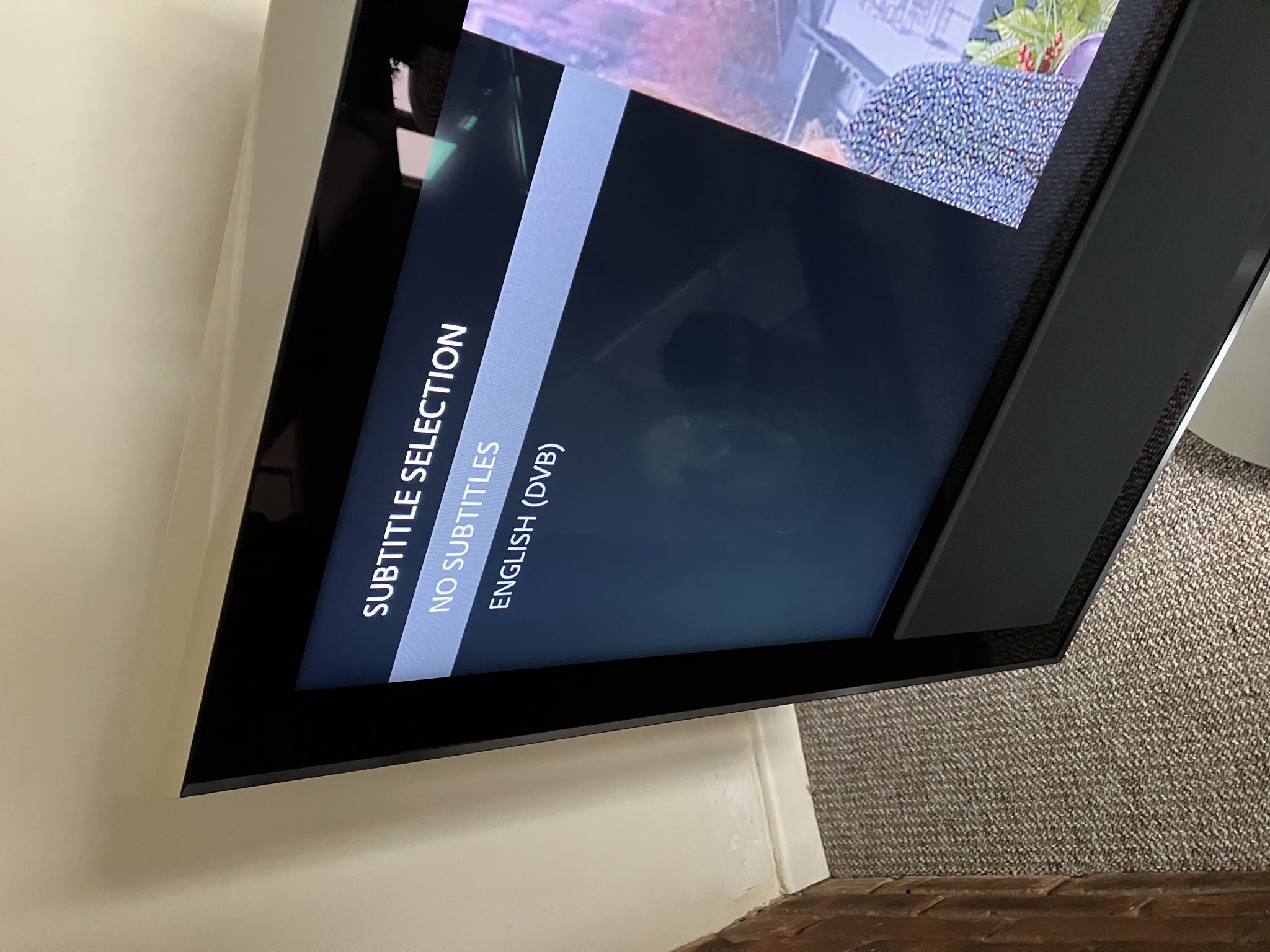

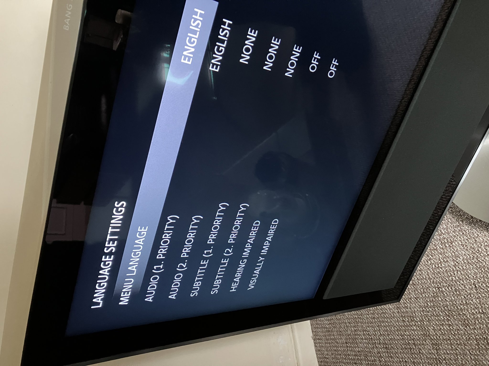

Hi All A minor prob after reloading Freesat and terrestrial TNT here in France. On satellite after changing channel subtitles are always shown, they can be stopped on the menu system, not the BnO one the French TNT one , so it's a minor inconvenience, my connected problem is that the selected no subtitles setting is not saved! Anyone out there any ideas? Is it connected to the Freesat channel reload? I have just mailed BnO Tech Support as well! Have a good rest of sunday Tony
To turn off subtitles on my BV10-32, you have to go to both: SUBTITLES LANGUAGE - and select 'NO SUBTITLES' SETUP, then OPTIONS, then LANGUAGE - and select 'NONE' for the two listed subtitles language options. EDIT:  Photos of the two pages:

Thanks Guy, Yes I had tried that but it wouldn't 'stick' so to speak, just tried again and held the select button down until it reset so my fault I wasn't pressing the button long enough! Again, a big thanks👍
